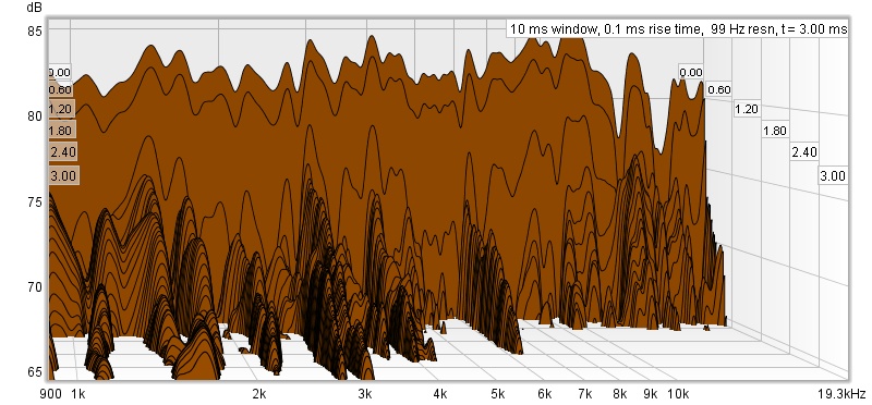

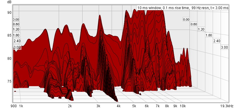

Is it possible for you to make a waterfall for checking if there are some resos that swing for a long time.

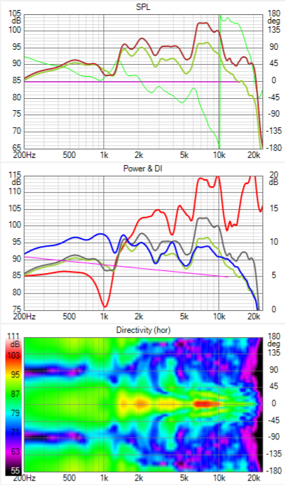

Some time ago (fresh driver, note sharp irregularities around 10kHz) I made measurements of a 12-250TC at many (horizontal) angles in an open baffle. The blue curve in the middle is the acoustic power, averaged across the angles. Note that there are no prominent peaks in the response, equal to not much resonances. There are broad dips at 2.8 and 5kHz, I did not notice them audibly so far. I suppose the peaks and dips in the individual measurements result from reflections inside the various cones. Didn't save a waterfall - but I reckon it looked ugly. I like this method more, waterfall graphs may look nice but are prone to processing errors. Hope this helps you.
I will repeat the measurements once both drivers are broken in and I finally got time for it.
That`s really nice.
Thank you.
This was measurement of a 12-250tc taken outdoors on tripod, in a non ideal shaped but heavily stuffed cabinet with an Earthworks M30 microphone.
Just to add that using eq with a DSP the ringing all but disappears, add to that 200 taps of FIR and it is a very nice picture, the Sure DSP is more than capable as is the ADAU1701 freedsp.
The FIR trace was a dirty measurement indoors with foam lense, FIR file created with RePhase.

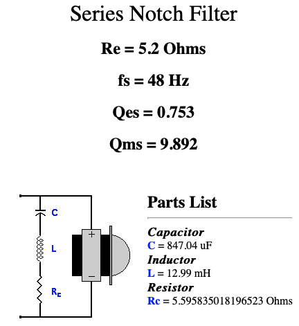

New LCR notch, now 9.5 ohms // 4uF // 0.24mH (2 x 0.12mH in series).
It sounds better, to my ears this is not the 2.5KHz area which is annoying but around 8KHz.
Next I'll remove it because I ordered a DAYTON AUDIO DSP-408.
BUT
I use a tube amp with no feedback, DF is about 5 which is acceptable but a little bit low for this driver.
Is it a good idea to tame the Fs impedance in this case?
12mH inductors are affordable (20eur) and if capacitor film is prefered, it's possible to find some 47uF for cheap (18 in //).
Does it worth it?
