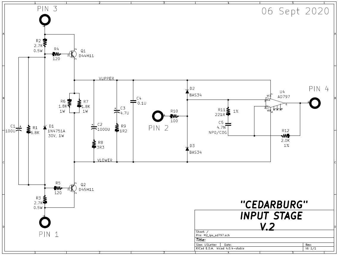

You may wish to consider making the same modification here, that member "palstanturhin" made to his F6. Like the M2, the F6 also has a K170/J74 JFET complementary follower input stage. He replaced it with a diamond buffer and felt the change improved the sonics on his F6.
Schematic in post #6077 and PCB layout in post #6075. Distortion measurements and frequency response in the neighborhood of post 6061.
Likewise, I have also replaced the JFet follower input stage in my F6 with a diamond buffer, modified from the Austin IPS to handle higher voltage. I like the way it sounds very much. It brings a similar quality to the F6 as it did to the M2x.

Thanks for the info Mark, I wonder if the “Austin” daughter board could smoothly integrate as a front end to this M2 version. I’ll look into that 😉

Have your high voltage engineers examine the Cedarburg (IPS8) card. There's a good chance they will conclude it can tolerate quite large supply voltage.

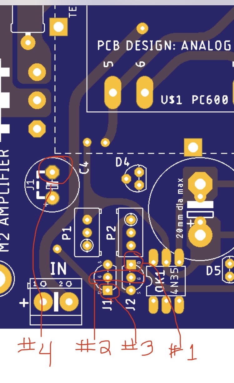

If one wanted to experiment “grafting” Mark Johnson’s Austin input stage pcb to this M2 layout, I believe this is how you’d go about it.
M2 PCB:__________ Austin Input stage:
J1 Drain = +V__________ Pin#3
J2 Drain = -V___________ Pin#1
J1/J2 Gate = Sig input_____ Pin#2
J2 Source pad = Output____ Pin#4
R4 Jumper
R4 Jumper
