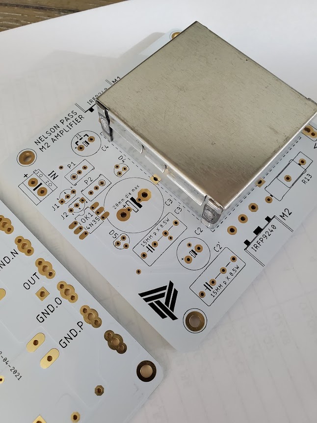

thought #1: Are the 6.35mm FastOn blade connectors at top (image 1 below), spaced far enough apart? Builders probably want enough blade-to-blade distance so they are able to use insulated female connectors (images 2 and 3) on the ends of the wires.
thought #2: Might want to investigate Blasphemous Heresy . Many DIY builders of M2 have found it indispensable.
_
I had to install spades on my old TeaBag M2's for this reason. I couldn't stand using flying leads.
Glad that M2X and now Prasi's M2 has spade connectors. They make connecting PSU's and speaker leads so much easier.
@Prasi: Super Layout! :cheers:

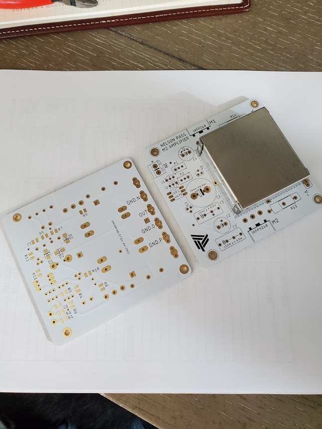

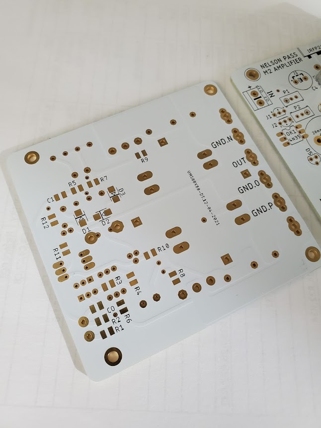

I just got the boards and they turned out nice. TEKO cover fits nicely
80mmx80mm mounting version
PM if you would like a pair (I have enough for 15 or so amps)
