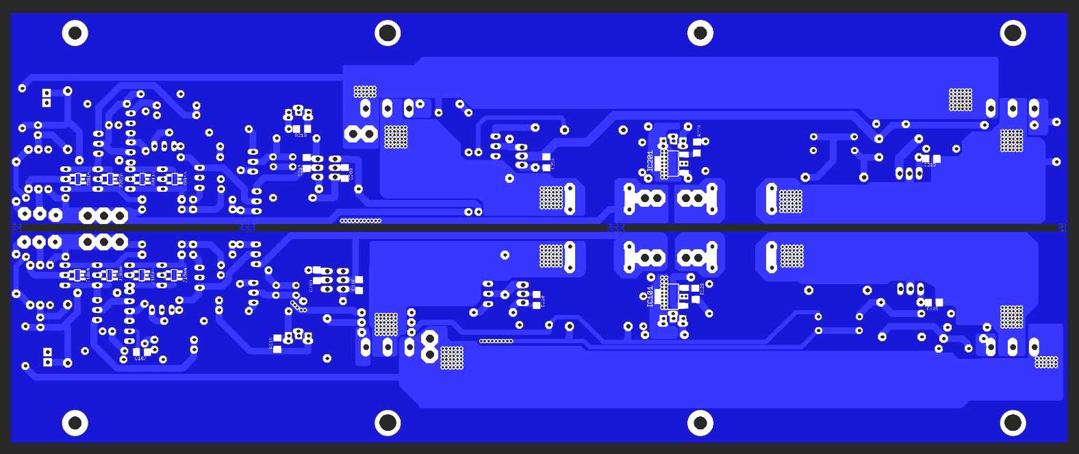

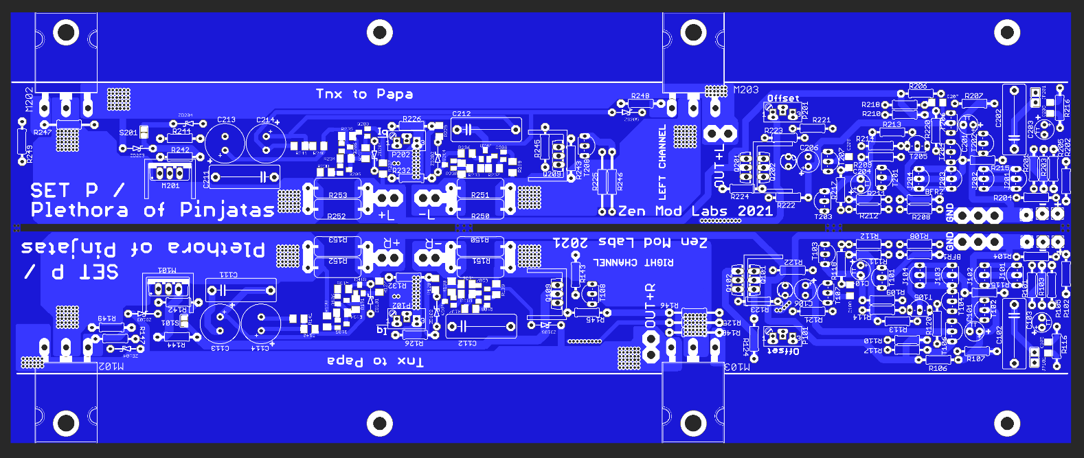

So compact M2 board.

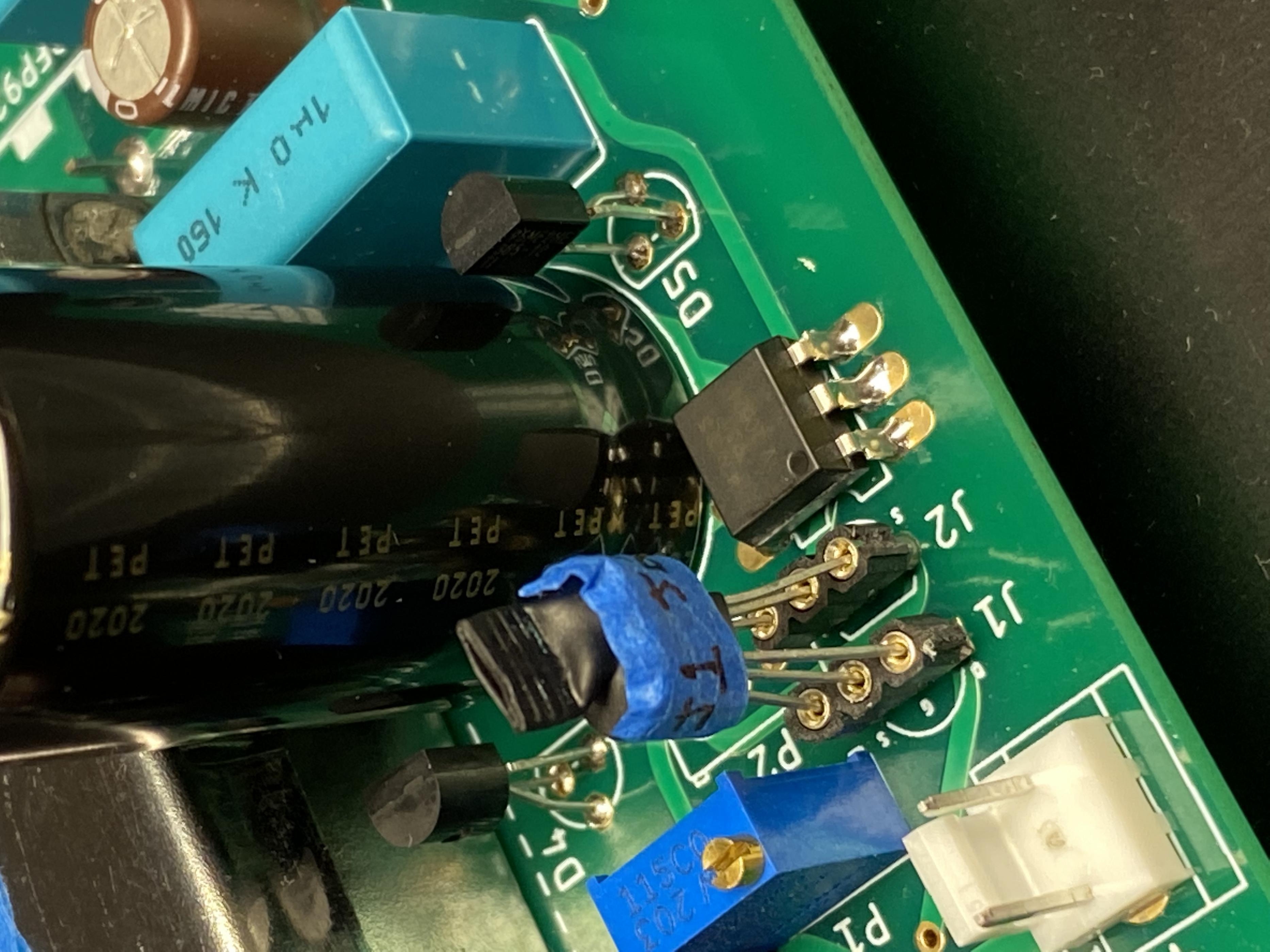

Both M2 amp boards were powered up from my bench power supply and seem healthy. There is a lengthy delay and slow ramp up before the amp modules reach their working bias current.
Both amps were built exactly the same, but amp #1 draws 1.5A and amp #2 draws 1.32A??

After a long pause on this M2 project, it's back on the workbench. I left off tracking down a bit of hum that's not acceptable and a difference in bias current between amp boards.
Chan #1 = 1.35A
Chan #2 = 1.7A

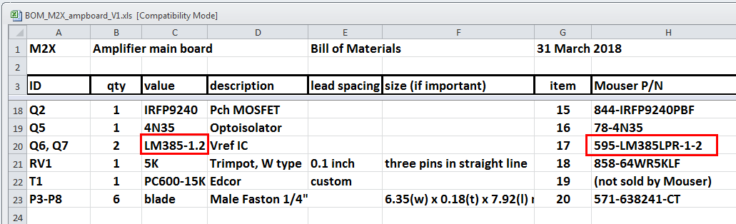

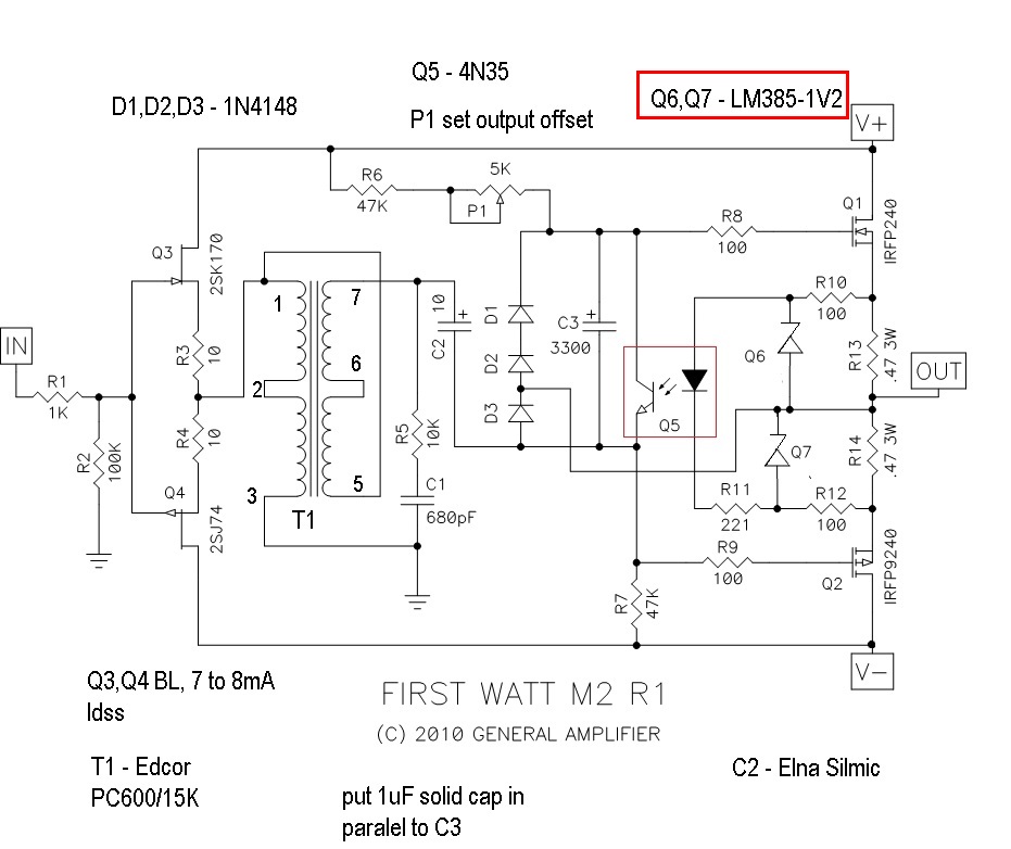

I started poking around and comparing the schematic for this M2 version versus others and noticed this amp has LM385-2V5 spec'ed in the BOM instead of LM385-1V2.
Increasing the LM385 clamping voltage will affect the optocoupler LED and the output bias setting and therefore should be replaced with 1V2's, correct?

it must be 1V25, or no function
it is "just" safety for optodiode, it goes Kaput with higher voltage
if you have discrepancy in Iq between channels - replace opto - no other possible reason if all resistors are of proper value
source resistors - voltage sag across them is firing up optodiode
it lits, opening optotransistor, it allows current trough resistors from rails to gates ( C-E of optotransistor)
optotransistor more open, higher current trough said resistors, greater voltage sag across them , gates goes closer, closing mosfets, decreasing voltage sag across source resistors .....

Yup, this will explain the wacky behavior. Correct value parts will be on order asap.

Before I removed the M2 boards from the heatsinks I wanted to get voltage measurements from key test points with the LM385-2v5 (D4, D5) reference diodes in place. I marked up the schematic with the recorded measurements. All points but (A) look slightly off from a properly tuned M2. I double checked all resistors and components for correctness - all good but the LM385’s. Would the incorrect ref diodes cause the wonky voltages at points (B) and (C)?
(Note: P2 trimpot is not installed on my boards.)

Yes, the incorrect LM385's were installed. I have the correct LM385-1v2 on the way (same LM385's as in your M2x BOM), I wanted to get a "state of health" report on the patient before the components are changed.

....Would the incorrect ref diodes cause the wonky voltages at points (B) and (C)?
I did replied to that question specifically

Tonight I removed the 4N35 and LM385-2v5’s and replaced them with a new 4N35 and the correct LM385-1v2’s in channel #2. This was the channel that had 0.712mV across R14.
After the component swap, the voltage across R14 was 0.603mV. All the other test point voltages from the attachment on post #133 are almost exactly the same. So this exercise lowered the bias current to approximately 1.3A, but didn’t change the voltages at the JFETS or Optocoupler pins 1-2, 4-5?

Yup, bias current is bang on now 🙂
I was questioning the unequal Jfet source voltages and small dc voltage at the Edcor input. But, more reading through the various M2 threads has answered my concerns. It seems the matched pairs of JFETs I had in my stash are not so closely matched after all. Removing R3/R4 and installing a trimpot “hack” from post #2592 of the ‘Official M2 schematic’ thread will null the dc offset. The nice part is Prasi included a location on the pcb for this adjustment trimpot (P2) without having to remove R3/R4.
