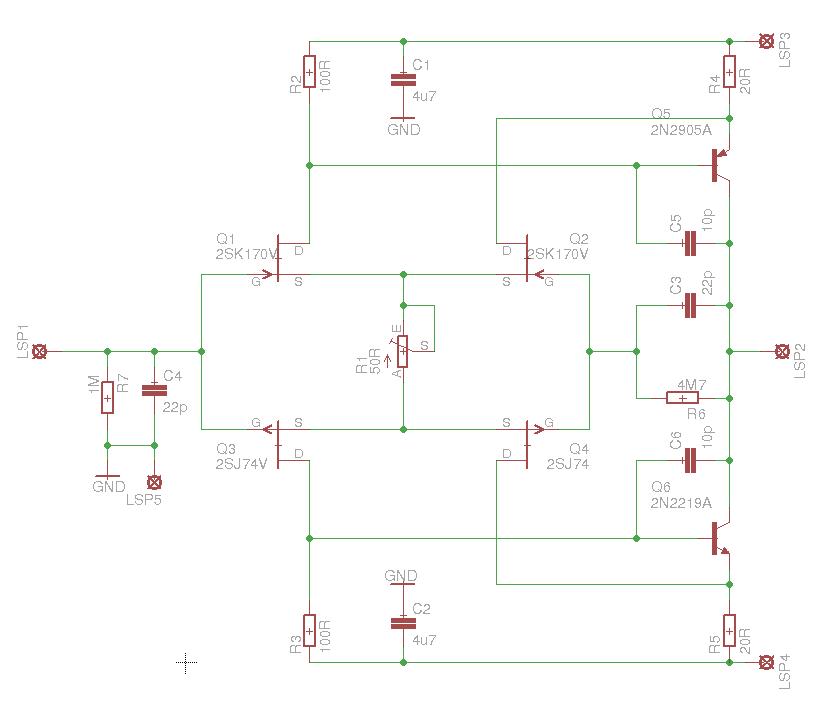

Yes I know that this kit exists, but it is only very loosely
based on the original circuit and the replacement module I
intend to build will be designed to fit into my ML-1 (If
one of the modules should fail in the future.)
Now for part values and operating points:
I have heard that HKC is currently busy rebuilding the phono stage
and I hope he will share his experience here too.
For part numbers I refer to the attached schematic.
This is a preliminary draft, so comments, additions, suggestions etc.
are very welcome.
The FETs should be closely matched, I could get pairs matched
to within 0.5 mA of Idss, Is this close enough ?

Ideally all four FETs would be as equal as possible, so would it
be best to have matched quads ? (I wonder which quantity one would
need to check in this case).
I assume 10mA through each Fet for now, this results in 1V across
the drain resistors (R2,R3) and approx. 20mA trough each BJT. This is a
bit too low compared with the original. To increase this current should I:
a) Further increase the current through the FETs
b) Increase the drain resistors
c) Lower the emitter resistors
d) or use some combination of the above.
For example 120 Ohms for R2 and R3 should result in approx. 30mA
trough each output device (and 0.5W per device). The 2N2219A and
2N2905A (I just have some of them from earlier projects) are
TO-39 devices rated for 0.8W (I would put small heatsinks on them).
For higher currents we could probably use 2SA1209/2SC2911 with
heatsinks.

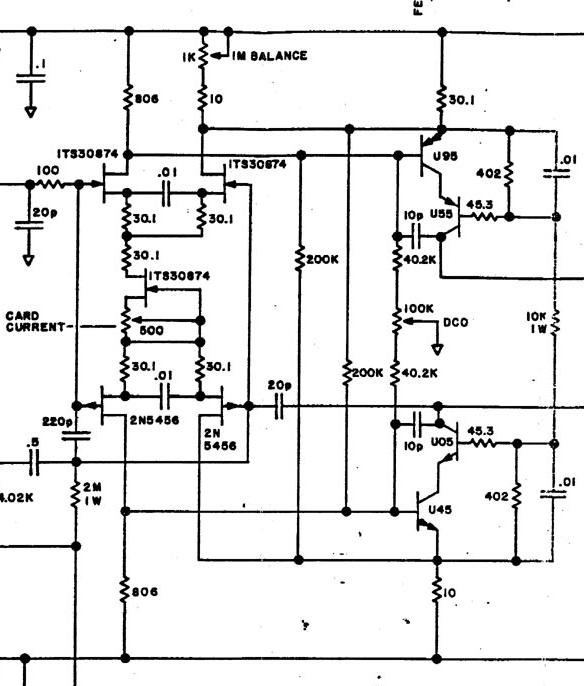

An additional question: On the bottom of the line modules two variable resistors can be seen. Maybe a later addition similar to the pot in the ML-2 frontend labeled "IM Balance". (See attachment and ignore the superfluous current source). No idea what IM stands for in this schematic. Intermodulation distortion ? To me it looks more like adjusting the offset by setting the same current in each output branch.

gk7 said:
........ in the ML-2 frontend labeled "IM Balance". (See attachment and ignore the superfluous current source). No idea what IM stands for in this schematic. Intermodulation distortion ?
hi,
the current through the 806r feeds one FET and the tiny base current coming from the cascode.
The currents through the adjustment pot // 30r1 feed both the FET and the folded cascode.
The adjustment is there to balance the FET currents which can be measured as the difference between the source voltages.
I suspect this does change the distortion coming from the FET LTP.
Maybe it comes out as intermodulation.
Self talks about this adjustment as critical to LTP performance.

AndrewT said:
hi,
Thank you for your comment, although your explanation seems more complicated than necessary. The pot (1k) and the resistor (10Ohms) simply is in parallel to the collector resistor (30.1Ohms) of the upper BJT. It allows for adjusting the current through this transistor. I think the purpose is to adjust the output stage for equal currents through both bipolars.

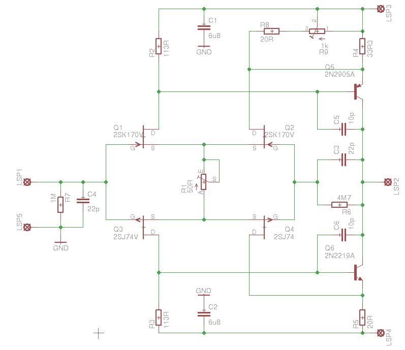

2nd try.
I have slightly increased the drain resistors and made the collector resistor of one BJT adjustable (12.5 - 32 Ohms) to adjust the output stage for equal currents through both BJTs.
Resistor brand: Vishay-Dale CMF-55-143 (good ? not good ?)
Currents: approx. 10mA for each FET (more ? less ?)
approx. 27mA for each BJT (they will dissipate 0.45W each, should be ok with small heatsinks).
Please comment, especially on the current through the FETs ...
