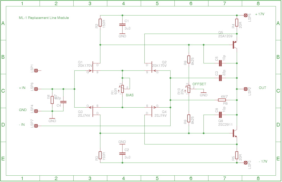

I have tried both, many, many years ago. Not sure what is best. But my clone has been in storage for years and years. Now using a better design, with JFETs not available to John in the early seventies.
Would that be N-channel Jfets like J113 from Intersil ? (Dennesen used these in the Sirius preamp).
Or the dual sk170 aka 2sk240 often used for MC stages?

First time a purchased E110 as shown in the Audio Amateur schematics. That is, for the RIAA input. The bipolars were 2N4401/4403 and the output was E212 and E175. Next time I used J110, J212 and J175. I do not remember, but I am pretty sure those are identical except for the package.
(Beware that the line stage in the picture contains an error which was corrected. I cannot find that picture.)
BTW there are some complete JC2 clones on eBay - complete with transistors - I do not know what transistors are used, but they sound OK enough.

Levinson Line Amp modules

I own a ML-1 and one of the line modules recently started to make some crackling noise the first minutes during warmup, so it might eventually fail some time in the future. I plan to make replacement line modules (as close to the original as it is possible with modern parts, at least performance wise). The should fit in the original JC-2/ML-1 chassis of course, but would make a nice "building block" for other DIY line level applications as well, I believe.
Your @mail adress does not work anymore...
If interested in modules, send me your mail adress
