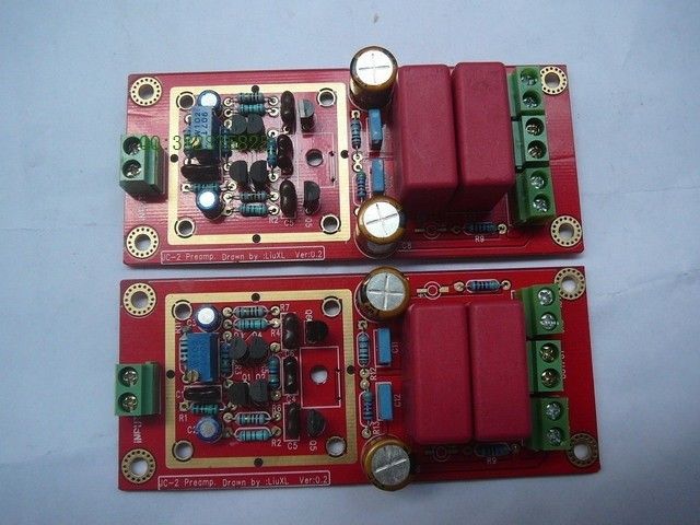

just buy the jc-2 kit from eBay:
the recommends are:

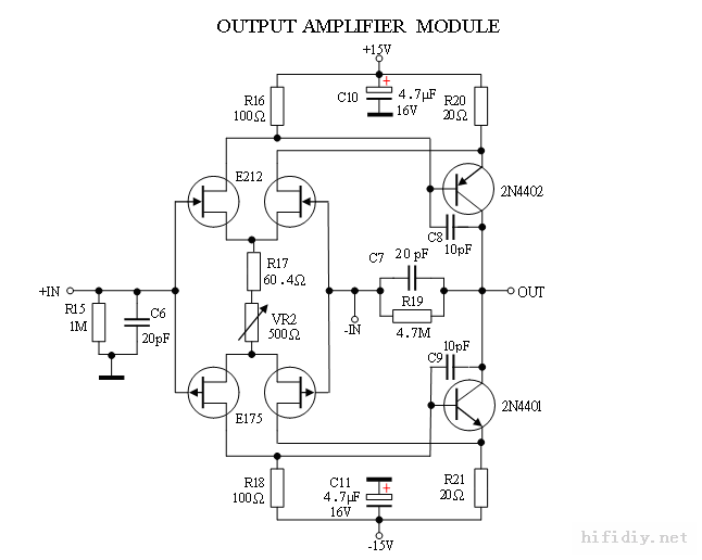

• Input stage : 2.5-3MA
• Voltage amplifier stage : 20-25 MA
i suppose that VR2 change the currents input stage? and 3mA*R17=0.18v ??
how i change the amplifier stage currents ?
the gain according to eBay is 3.7, can i change it? how?
thanks

Well, not really. Most of the ebay clones are only loosely based on the original.
Without information about the specific implementation its impossible to give any
support. Actually the seller of this kit should answer the questions of his customers.

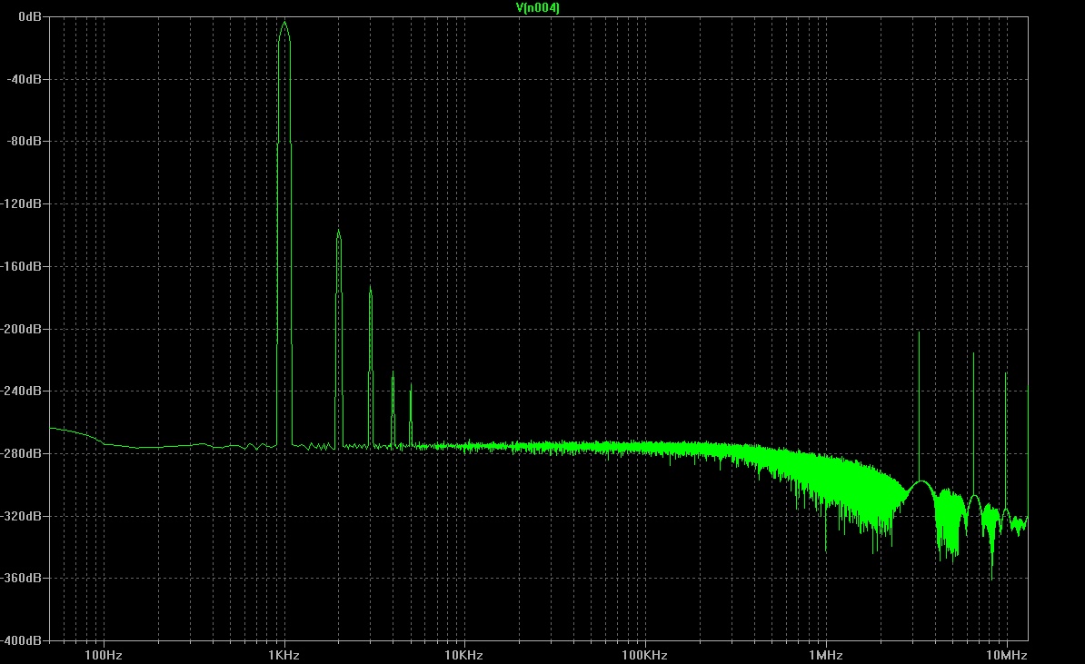

I have played with LT Spice today and did a simulation of the
line stage.
Thanks to Bob Cordell (for the models) and dado (models and
spice parameters).
Now this is just a simulation, but at least from this theoretical
point of view it is perfect:
gain of 10, ca. 1V out, Total Harmonic Distortion: 0.000022%

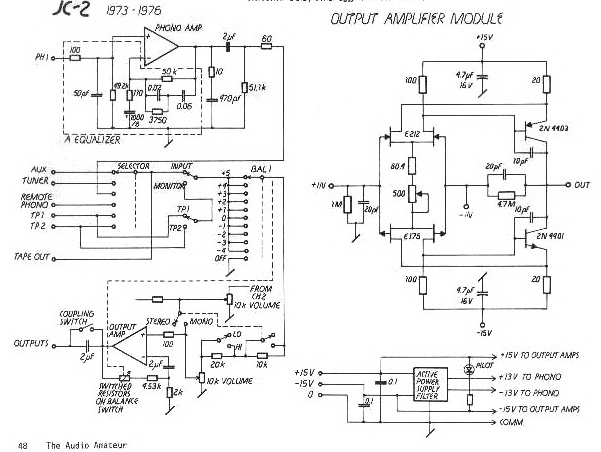

Is this so Andrew?
In no signal situation this is true, but what about when signal appears at input
R15 is connected to ground(no AC) but R19 is connected to output and a lot of AC.
To me it looks like a dynamically unbalanced input , impedance wise.
