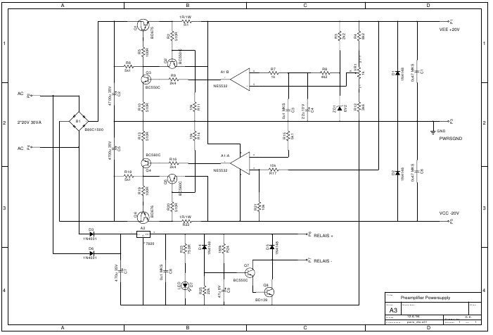

Hi gk7
Very good and informative summarize.
I am looking forward to see the pinout and dimensions of the line modules.
Some corrections to my last post
ad 1) attached the schematic
ad 4) This was an error there are 2 uF caps on the copperside of the board,
so the removal (replaced by wire) of those inside the feedback loop is valid for later serial numbers too.
ad 6c) Mr. Curl, was this 3.3 kOhm series resitor recommended by you (an if so what is the benefit of it) or is this simply a typo ?

Thanks for the schematic!
I'm always curious to see a schematic of big John Curl 😉
In this case the power supply is perfectly ordinary: maybe a bit large input filtering, not seen generally. Also I don't remember that I've seen an inductor connected to the center tap of the transformer. Only thing I miss is output cap bypass...

Well "odinary", I think it´s intended as a DIY replacement and the inductor is an interesting idea. Personally I found the LM317/337 always ok if you use enough caps around them. For the output bypass: It´s an external supply and there are bypass caps near the line mudules in the preamp case. The phono part has an extra capitance multiplier before it.

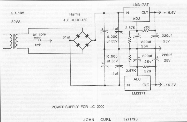

h_a said:Thanks for the schematic!
The LM337 is the worst negative regulator known to mankind, when it comes to frequency response.

Syn08 is correct. The LF317 has a few problems. I hope that he can give us a better solution.

To me, it is a dissapointment to see a power supply like this in a product made by JC. I am sure you can yourself figure out a decent solution for a decent power supply.

The essence of this power supply schematic is right out of the National Semiconductor handbook. The 'improvements' to it precede the IC's, being high speed diodes and a choke in the center tap.
This is an easily buildable power supply by amateurs, it is not a professional design, although it does look a lot like what I normally use for my own preamps.
It is designed to replace the ORIGINAL Mark Levinson supply which was a 200ma Semiconductor Circuits module with an output of +15/-15V. This supply is somewhat better than that.
It is NOT my best however, and I don't publish my BEST schematics.
Because of the relatively limited voltage available, it is perhaps not optimum to add an additional cap multiplier pair for just the driver stage. It is what I normally use, but then, I start with +/- 30V or so.
Syno8 had his chance to give a better solution. He didn't, so I think we know where he is coming from.

To repeat it for those who get easily disappointed: It's a replacement power supply if the original is missing. (BTW while I'm writing this I'm listening to Bruckners 8th and I can tell you the JC-2 is one of the finest electronic products ever made.)

I would rather question why this inductor is to ground istead of having one in the plus and minus line. To quote Saint Exupery: "Perfection is achieved, not when there is nothing more to add, but when there is nothing left to take away."

The choke in the center tap is to keep the transformer capacitance induced high frequency garbage from getting into the ground of the preamp itself.

Indeed, I don't have a cheaper solution, but I thought JC does not do cheap stuff 😀. Otherwise, here's a better solution: a Jung regulator 🙂 Opamp and a tranny plus some passive stuff.
Last time I've seen a LM337 was in a $150 NAD phono stage. Performance was accordingly 🙁 but you get what you pay for. My expectations from a ML or JC preamp were completely different, at least after looking at the price tag.
john curl said:The choke in the center tap is to keep the transformer capacitance induced high frequency garbage from getting into the ground of the preamp itself.
From the schematic it looks like the center tap (via choke) is only grounded to the chassis while the power supply ground is floating (there are some different symbols in schematics used in the US and Europe).
And this 3.3 kOhm series resitor for the output cap still makes no sense to me... please explain
