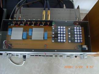

After 5 years, I eventually finished my JC-2 clone. The sonic quality of my JC-2 is amazing. About 10 of my friends have listened to the pre-amp and they all give very positive comments to it.
I want to say thank you to you guys who gave suggestions and advices here.
Top view of the pre-amp:

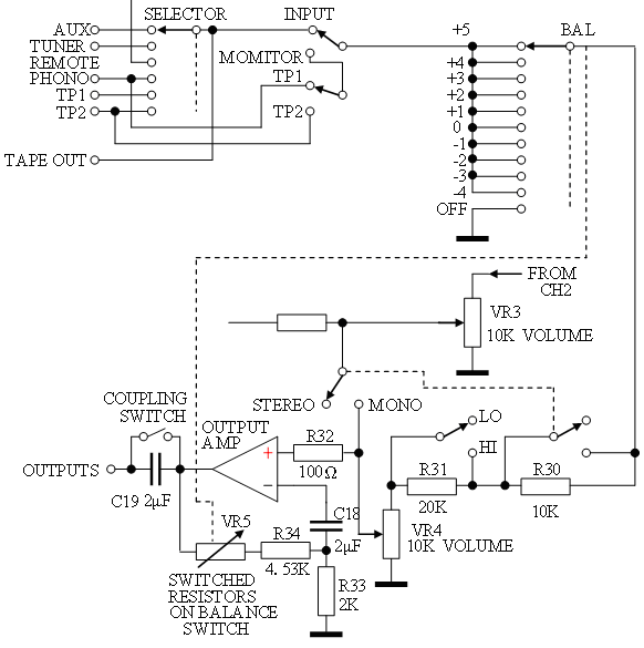

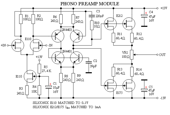

I own a ML-1 and one of the line modules recently started to make some crackling noise the first minutes during warmup, so it might eventually fail some time in the future. I plan to make replacement line modules (as close to the original as it is possible with modern parts, at least performance wise). The should fit in the original JC-2/ML-1 chassis of course, but would make a nice "building block" for other DIY line level applications as well, I believe.

I wish you well in making replacement modules for the JC-2, ML-1 preamps. I am just too old and tired to do it myself, but the need is there, and it is always a shame to see such a nice chassis discarded, because of lack of modules. I got a free JC-2 that way, but it was only valuable because I could fix it with pre-existing modules. Today, I am out.
Anyone with a dead JC-2 can contact me. No, I won't repair it, per se, but I've always thought it was one of the most attractive preamps made and I'd love to build something into the chassis.
The basic circuit topology is still viable, but obtaining original parts is difficult and there are changes that could be made to update the thing to more-or-less modern standards. If I recall correctly the phono stage EQ is flawed--something I believe John would admit--although it can be tweaked to greater accuracy.
Hell, even if I don't build anything into it, I'd just like to have one around to look at.
