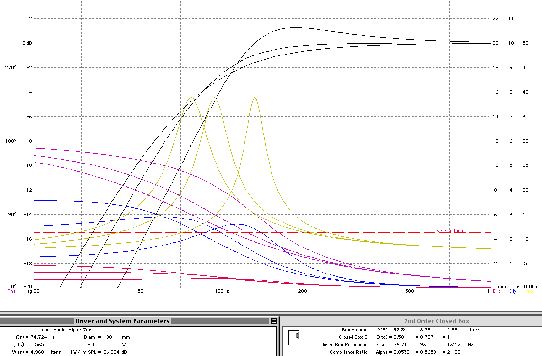

I thought about 21 litres ish for the 12pw making the internal dimensions 276Hx446Wx170D, and about 9.7 litres for the alpair which makes 214Hx346Wx132D. I plan to to make them separate enclsoures so I can interchange woofer/midtweet if I buy something new in the future.
I have realised that this would make a rather square looking baffle once you add up the heights and account for thickness of wood (and also add extra external width for alpair to make the baffle the same). As far as I understand, this isn't optimal in terms of diffraction, so wondering if anyone can give any pointers on keeping the box reasonably shallow and the right sort of shape. If I make a CGR for about 31 litres the box is a good size, but once I split the box in two, I am messing with the internal dimensions a lot. Wondering if anyone can suggest anything. If I separate the enclosures with angled pieces of wood, would this help?
Hi, Dave. The box size for the 12pw isn't the issue. I was aiming for something like 21 litres to account for bracing. Not sure if I should aim lower to account for stuffing too. I think the optimal size is about 20 litres from memory. I thought better to be too big than too small, but I'm not really sure how much exactly QTC changes with stuffing.
I'm not really sure how to implement the 7ms on top becase for q 0.707 it's about 8.7 litres, was aiming for about 9.7 box size. Once I then stack the boxes the baffle becomes esentially square shaped. From what I've worked out, it looks like the best way is to make a box of about 31 litres (very happy with dimenions of 31 litre CGR) litres and split it in two on the inside, but then I mess with the internal ratios so wasn't sure how to go about it. Or maybe I'm just overthinking something that's not much of an issue?

I was aiming for QTC 0.707 or less on the 7ms to match the 12pw, I'm not really sure how much difference it'll make 200-400hz. I was previously considering making the 7ms vented but wasn't sure if this would affect transients. a QTC of 0.8 is 4.94 litres.
I'm still not really certain of how to add the drivers boxes together without affecting the exterior or interior ratio too much. Unless I build the 7ms box inside a 30 litre box. What would you advise? I'm happy to go away and read a bit more on this, but it'll have to wait a few days unfortunately. I am pretty eager to get the main details down asap

As the 7ms is similar size sealed and ported, I am considering making it ported and using heavy stuffing to push it towards sealed as you suggested, Dave. Then this would be enable me to adapt it to a regular full range 7ms if needed
