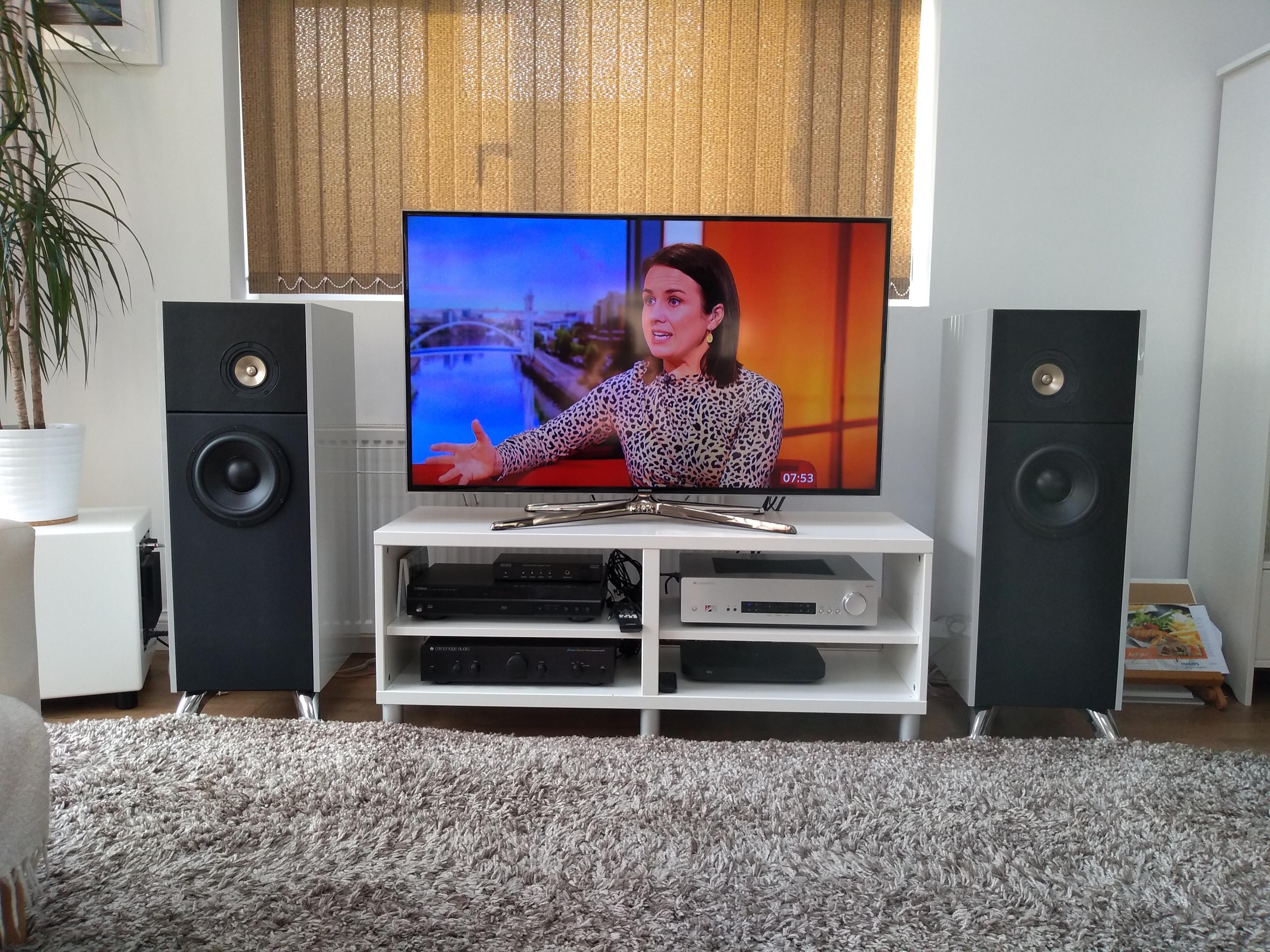

My room is an extension at the back of our house, open plan to kitchen and dining area. About 7.4m by 7m but L shaped not square. Seated listening distance is about 2.5m and standing (while cooking) about 5.5m. The fronts of the speakers are about 0.8m from the front wall.
Here's a pic with Pluvia 7s but now I have the 7MS.
The woofer is in a 46 litre bass reflex. The Alpair is in a short tapered stuffed transmission line (similar to what Dave, Planet10 uses in some of his designs). The idea is to reduce the amplitude of the impedance peak that allows easier passive crossover design.

Just out of curiosity, how do you find the pluvia 7 compared to the 7ms, now that you have had some time with them? I recall seeing you post about installing the 7ms a while ago.
The 7MS are better. With the Pluvias I used a notch filter on the higher freqs as on axis it was too hot for my liking. The 7MS are more detailed and great off axis.

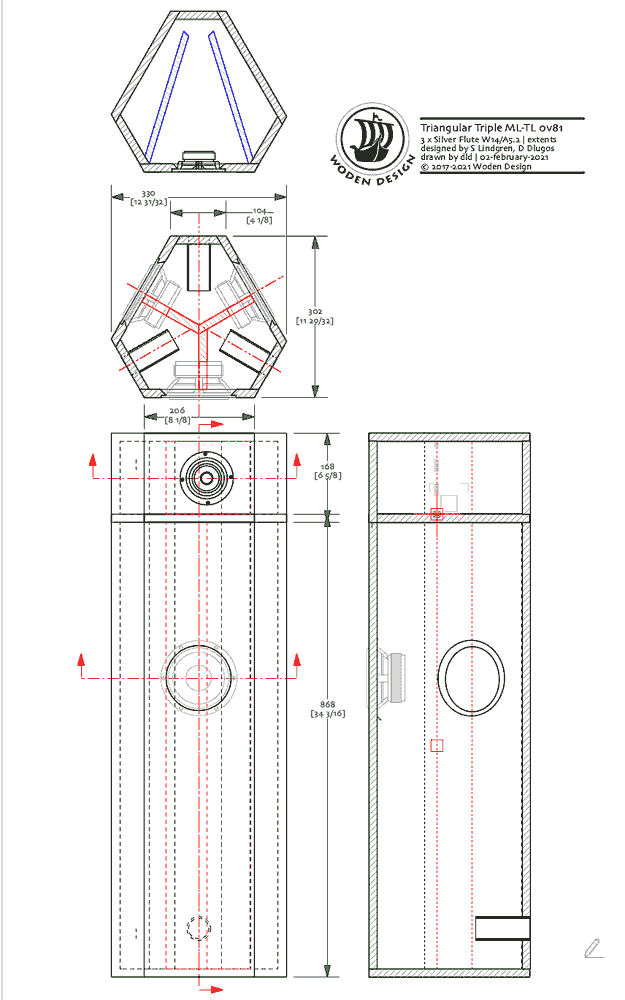

As it turns out i am working thru a WAW concept with A5.2 (or any 3 or 4” FR). It comes about because someone asked the innocent query: “what happens when you hook 2 drivers in parallel with the other driver in series". Turns out that once one goes down the rabbit hole to answer that question there are many possible combos, mostly dicarded in the past due to the assymetrical SPL of the drivers. This version uses a single midTweeter, but i have a version that uses 3 of them as well. With a single midTweeter te midTL is half-wave since i have a ton of volume to work with.
The “mono-pole” one requires 12-24Ω woofers. Unfortunately the Silver Flutre here are only sourced thru the USA.

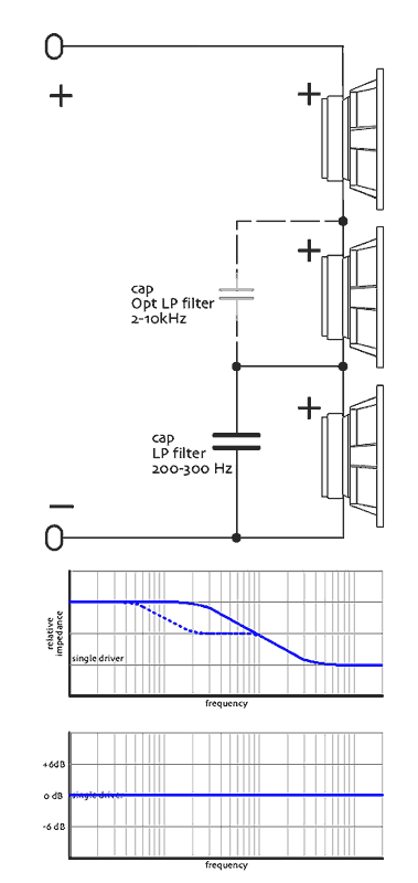

I have done some twin boxes but am going to add some 3 driver boxes (4Ω drivers needed, and an amp happy with 12Ω in the bass.
This is the XO scheme for the all series configuration (ignore the text, it is a leftover, i have to add more appropriate ranges with more explanation of the what makes for the range..
Wiring 2 togther (series or parallel) is also possible and brings some interesting options.
