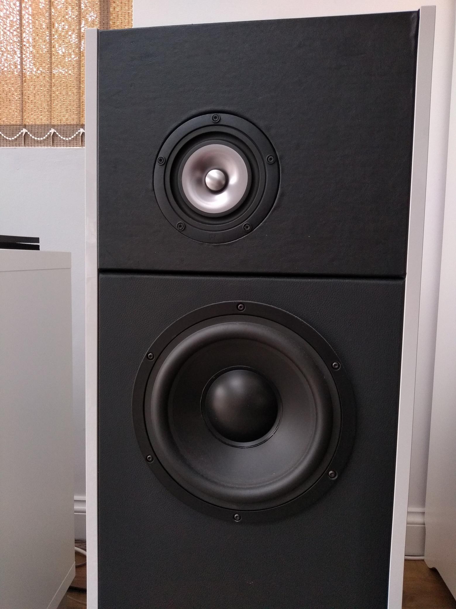

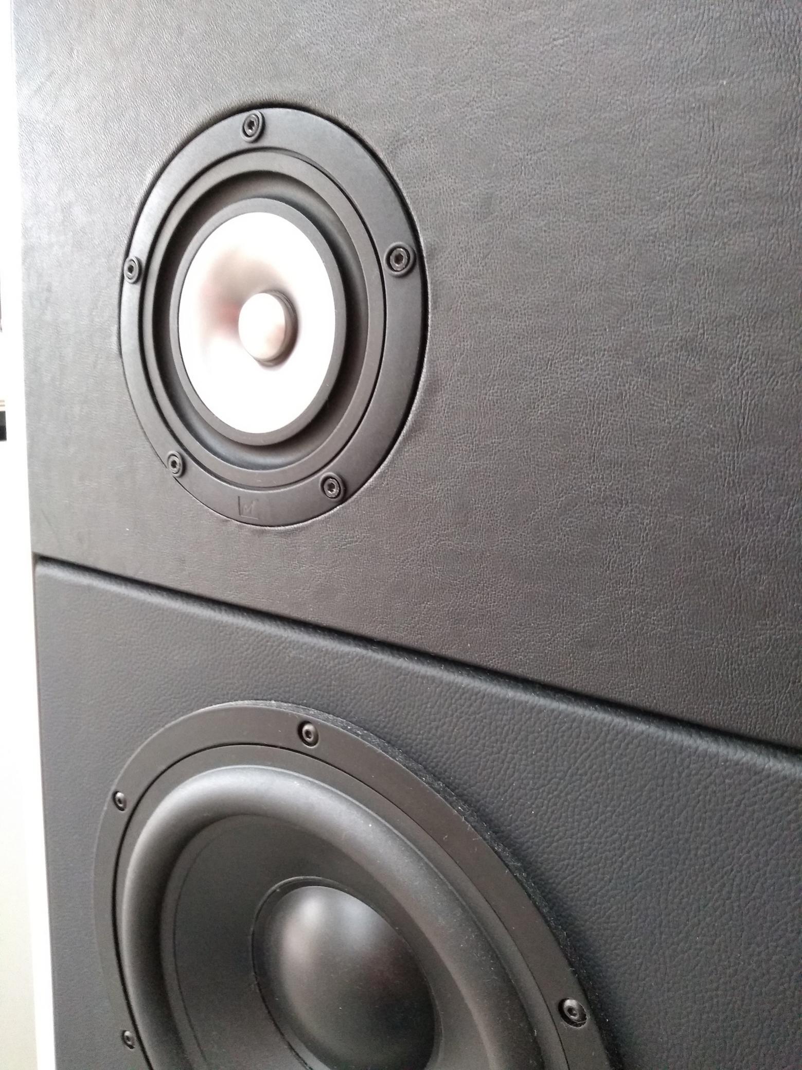

I think Stal needs to upload a new photo because I have seen that one with the pluvias several times and we all want to see the 7ms in their full glory 😀

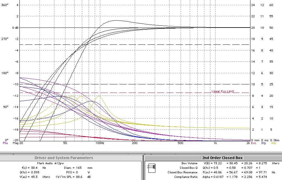

Drivers for sealed enclosures are rare 15-20 litres is not that large.
A12pw sealed 20 litres does 40 Hz F10, low 50s F6. And doesn’t start runnign out of steam until about 10k, is very well behaved, and sounds very good.
Hmm… surprisingly the reflex only reaches 5 Hz or so lower, but with a quicker rolloff. Which suggests that if one damps the vent, you end up in between. And that can be done after the fact. Crank up th edamping density and one approachs sealed so a bit of tuning capability for the room.
I do wonder how it'll sound, I haven't seen anyone using a 12pw sealed before. I haven't seen many reports in general about it. I would use it in about 20 litres sealed because that would probably be easiest for me to do. I know 20 litres isn't that big, but because the shallow enclosure the proportions suddenly get quite big. And I need about 9 litres for 7ms on top. The 12pw does look like a very well made driver though.
