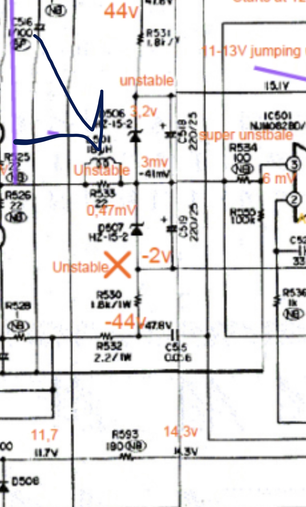

Irrespective of the health status of IC501, IC502, the behavior at pins 8 and 4 should be about the same due to bypassing provided by C525 (and C518, C519).
If I interpret correctly, pin 8 shows "ugly" behavior but the waveform looks better at pin 4. I suggest using the ugly signal as a "test waveform" and follow it from pin 8 along the path to pin 4, perhaps using a "divide and conquer" search. eg. is the top of C525 ugly, or better? How about bottom of C525? Try to probe directly on component leads, as this can help localize unrecognized broken traces.

Should I interpret this as the 81V rail being unstable (and possibly tripping the relay) when you touch the probe to it?
It looks like you have two separate power supplies. Did you test both of them? One seems to be connected to CN6 and appears to power the preamp. Are your getting stable voltage from it when it’s disconnected from the amplifier board?

The latest volt readings show +3.2v and -2v at the zeners. Then further along the same wire this 11-12v. This hints at a changing state during testing. As does past talk of different behaviour each power up.
Relay 501 needs a good looking at. As does the DC on a timebase that would show ripple.

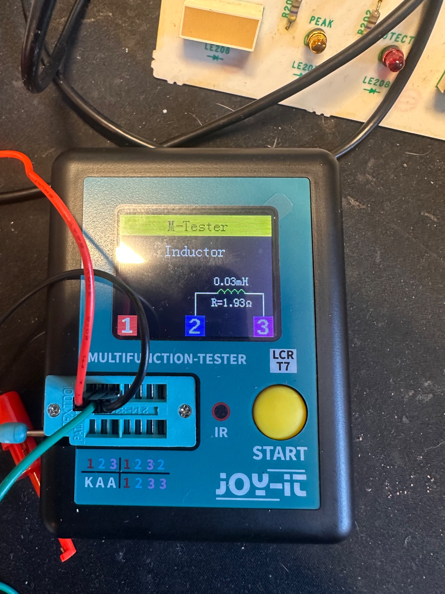

I pulled the L501 inductor now that I got a new component tester and it’s reading 30uH instead of 18uH not 100% sure my TC from JoyIt is correct here but it is reading good on everything else I have tried so far. If this is out of spec maby this could be a reason, it’s just in the area we’re in having problem. Any thoughts here?

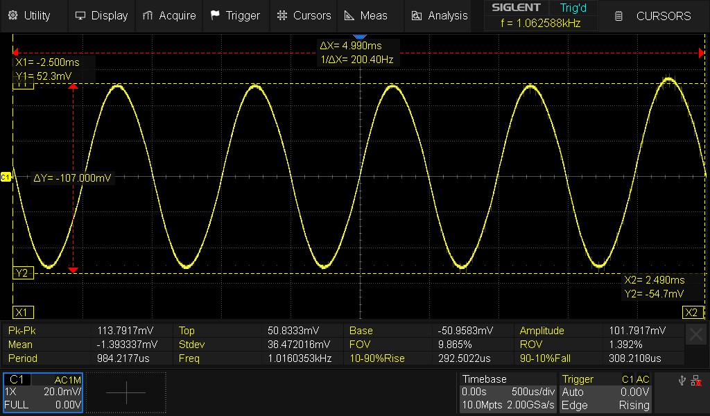

I don't have a decent signal generator yet. But i feeded the amp a 1K signalt from my phone, and not really able to hook the terminal 100% with scope probe but i'm ablte to get a signal true. What i cant understnad is that when i try to put the volume knob up the waveform flatens out.
How are you expecting to have any output on the speaker terminal when you pulled the opamps? Well, you have something, but it’s probably something that leaks through some path somehow. I don’t have the time to check the schematic.

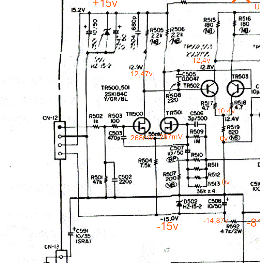

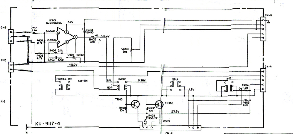

I'm feeling stupid now. The signal from RCA input feeds into a Input board as follows bellow:
It then feeds to amplifier board via CN12. The signal volume is controlled VR501. The signal then goes via grey(black) to speaker board. I do measure on these connections on speaker board. There is now preamplifer per definition, or im totaly wrong here. I can measure the signal just before it goes true amplifer on R501.
