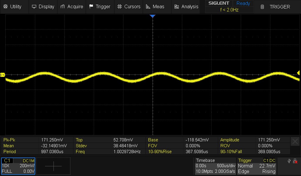

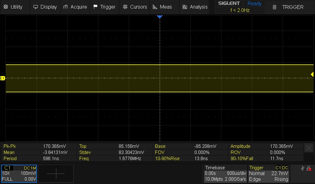

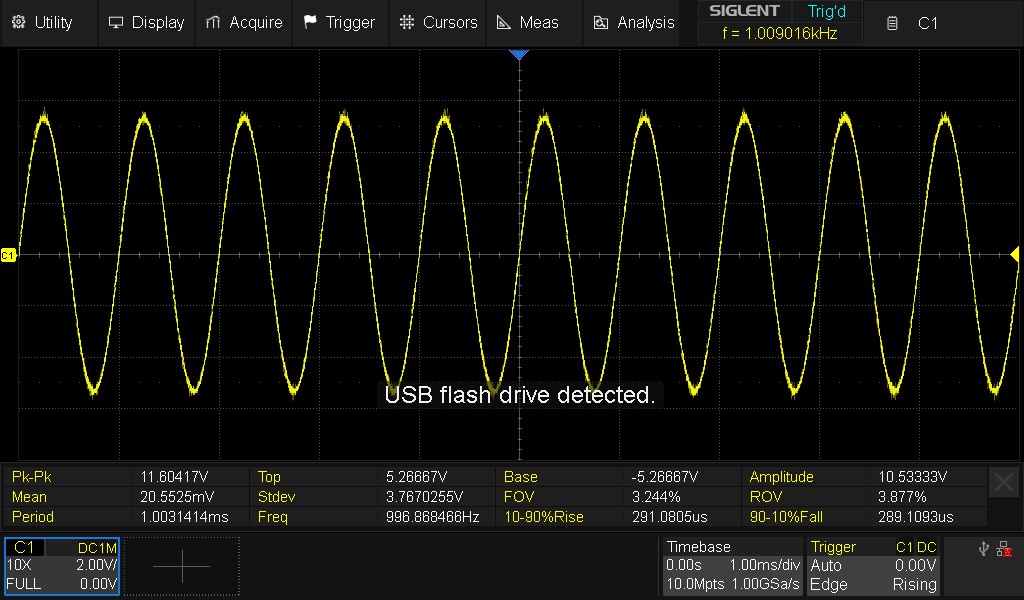

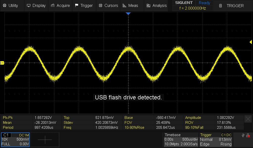

Here is a snap of same input signal but via balanced input an zero volume. Also just after powering up i took a picture of what the signal looks like justbefore i adjust volumeknob (potentiometer)
So i got OP-amps installed. And sending it full volume on phone true Balanced input and some volume. DBT is out and i see no problems at this point. Is it safe for me to go off DBT and set bias or do i need to do anything else?

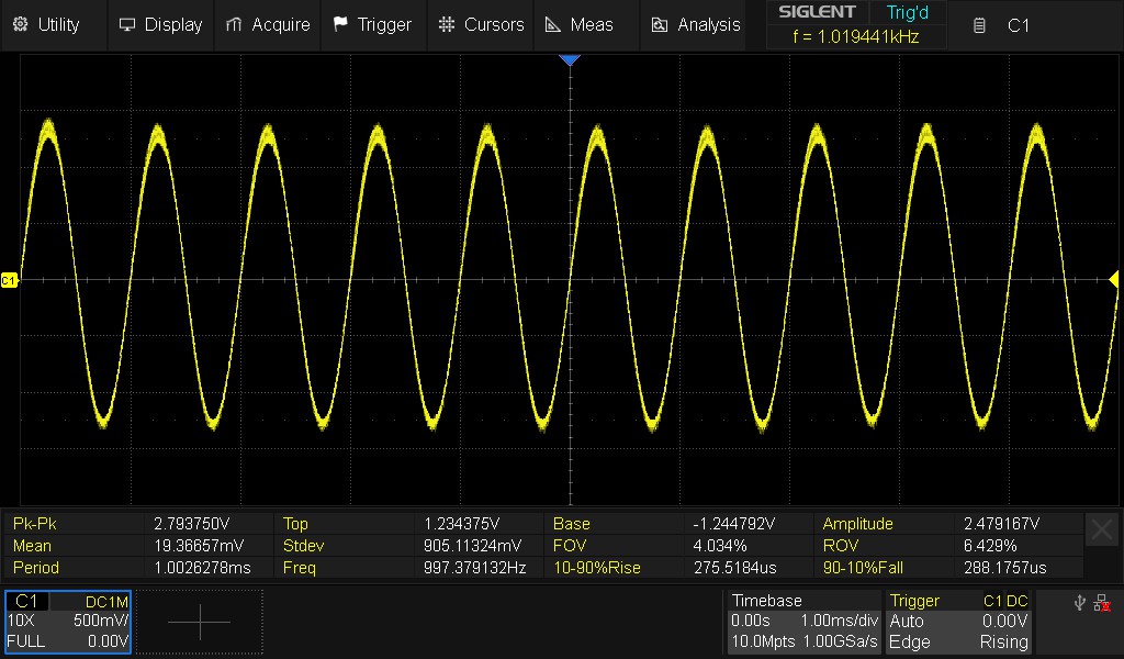

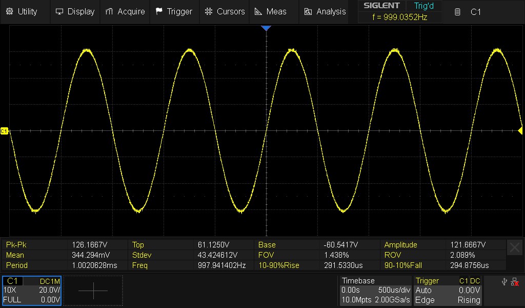

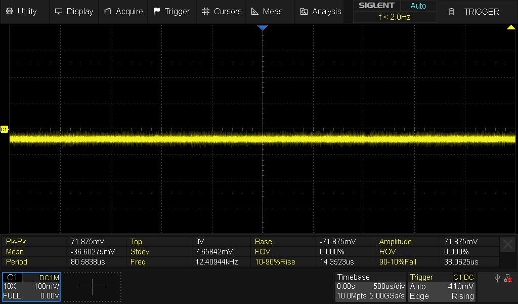

Yes it seems like it is working but i still need to adjust bias. This is speaker output the other picture was output from amplifier
