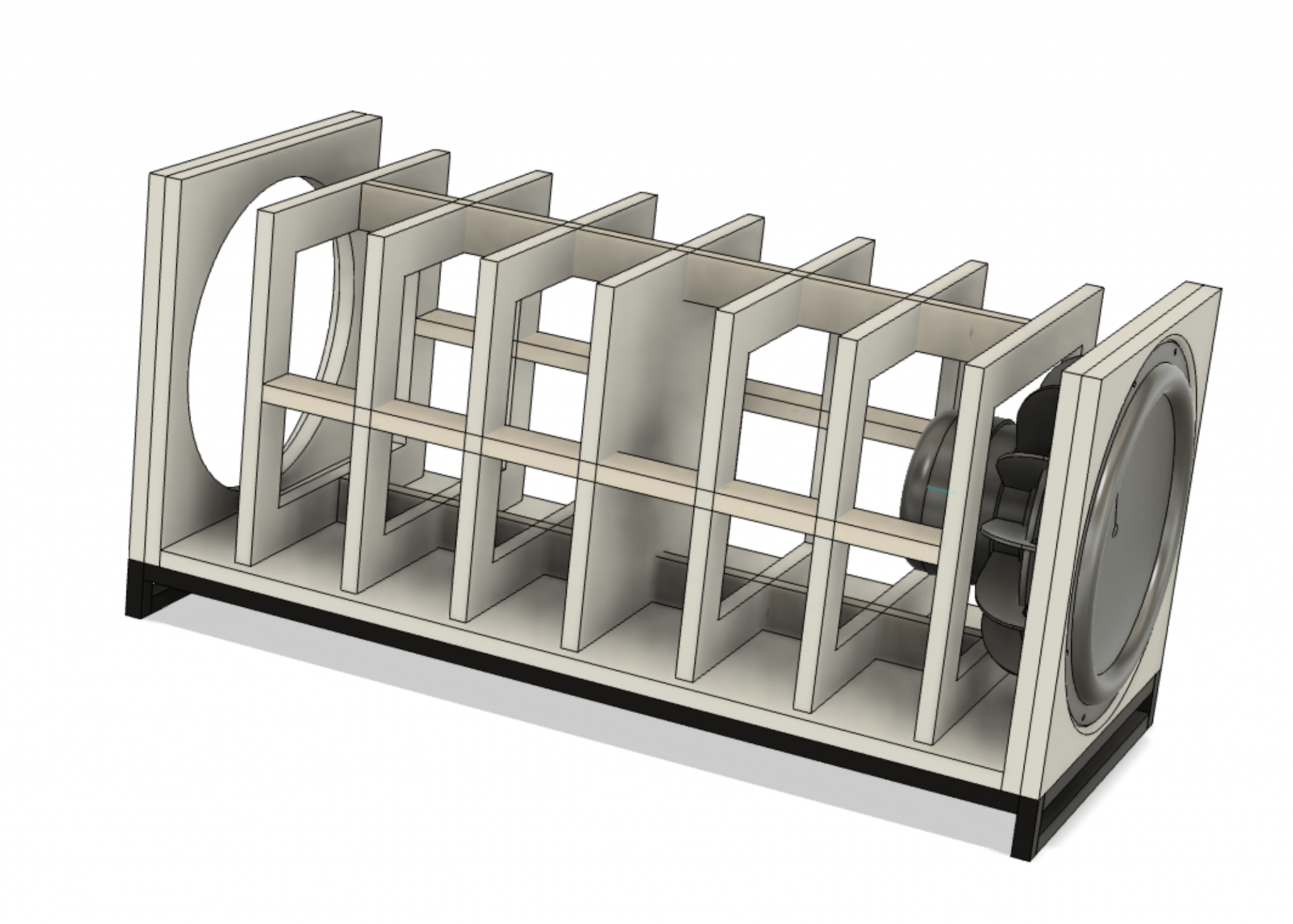

Need help designing a home theater subwoofer

Basically, if you half the volume of a (closed) sub woofer, you double the pressure inside of it for the same power input. So bracing is a very good idea if you want the cabinet not to expand (and contract) like a balloon, messing up the signal in the room. This will be audible, giving bass a muddy undertone.
The bracing you pictured is a little over the edge for my taste, simply using 5-7" high stripes of 3/4 material should do as well. If you do not care for the unnecessary volume, weight and cost, the complicated to manufacture braces are nicer, of course.
The divider in the middle makes it two separate boxes, as even a panel thinner than 3/4" will have incredible strength, pushed or pulled from the outside, if glued in perfectly. It is not confronted with pressure.
I have been trying bracing techniques (great word for a simple thing) for many years and you have to set them in the right perspective. The often promoted cross braces do not work too well and often interfere with bass drivers. The T-bar style I practice today is easy to implement, cheap and effective. Why make it more complicated?
I once build a new cabinet for one of two existing, commercial CANTON 10" subs. The new cabinet was a little taller and about 2" less wide to custom fit a space between two sideboards. The same net volume. I inside I put a T-bar matrix of regular squares. Which made it sound very “dead”. The surprise came when we tried them side by side, old and new. They sounded absolutely different, the new cabinet delivering tight bass, while the old one seemed to produce two tones at once. Not just a little different, but like day and night. It may, by coincidence, have been an extreme example, but anyone should just try it for his own once. Might be an eye opener. It may explain why the same driver, tried by different people, often gives good or bad results.
Since this experience, I have gone away from thick material like 1” to thinner and braced, saving weight and cost at the expense of some time. If you implement braces at the right time of the build, it does not take extra effort. I prepare long stripes, often made from left over's or even old furniture (Germans have this “green” gene) and then cut each individually with a miter saw. Foaming PU glue is a great help here. As they are inside, optics don't matter.

So like that for a T bar style ?
Could, like you said, use 1/2 MDF or 5/8. strips are 2'' x (thickness of material, 4/3, 5/8 or 1/2)
hope I underdstood the Tbar concept.
Should I reduce the number ? from 3 to 2 per side ? Is rounding the corner worth it inside a sealed box ?did i went overbaord with bracing, again ?
The complexity of the other style I made earlier isnt too much a of a deal, since I would laser cut a pattern, then use this pattern to router the brace.
I have straps that I 3d printed corner to make a corner clamp. I have like 8 laying around. Just nee to print more corner.

If you get your design laser cut, go for it. If it gets too expensive, take the stripes route. Rounding them off is useless, as the speed of air is low inside. A port In a vented cabinet is something else.
I suppose you use 3/4" board, so something like 2"-3" high ¾" strong stripes should be OK. This is no exact science, just empirical found numbers. Place them about 4" apart. You will hear when it is OK. Don't go for less than you have in your picture.

4in appart for 3 in « high »x 3/4in thick strips, on a 15 x 15 x 20 inside diameter feels like it going to take a lots of internal volume.
Are the horizontal (the one that goes the « whole lenght) one needed?
What you mean by: « you will hear when it’s okay? »
If I remeber correctly, you said to assemble the box, then when 1 pannel is left to install, you go ahead and install the strips.
You then knock on the cab and see if it sound « dead »?
Edit: went ahead and tried to model it in fusion. @4in appart, 2in high strips x 3/4 thick, it removes 0.5 cubic feet of internal volume.
See, there are many out there who place a single cross in each volume and call it a day. The sub will sure work. As long as you do not have a direct A to B comparison, it will be all right. Just not showing the whole potential of the chassis.
Building speakers is always a game of compromise as you have to watch certain limits. There is a point in a build like yours, where you may realize two 15" woofer would be nice, but a double 12" is the limit.
In the end you have to decide.
The 4” apart has shown to give “best” results with ¾” material. Also, there is no other way of compare able bracing using less volume. The usual, primitive approach of using stronger panel, for example 1” instead of 3/4” shows astonishingly little improvement with even more weight.
You may try such bracing on some spare panel. Just to get an idea what a 4” distance feels like, compared to 8” for example. There is a distance where placing braces narrower does not improve anything. This is the 100% point. Basically any brace is better than none, even if you may sacrifice 20% efficiency. This is DIYS = you make the rules.

Maybe I should have been better with 2: 12“ in that volume, But that’s kinda bit late, driver are home and paid.
That’s why I asked you guys.
I don’t mind getting them @4” appart if it’s going to sound better, less rattle-ly. Just want to make sure I don’t over do it and I don’t “loose” internal volume for “nothing”.
I’m here to learn. I don’t mind having 2:15” playing less than optimal for my first build. That’s a bit unfortunate, but that happen and I understand.
I can always reuse those driver in another build if ever. Or I can listen to the sub, and improve upon this build for the other subwoofer I’ll make for the other living room where WAF won’t be as much of a factor than the main living room.
Cant see in Winisd for now at what QTC I’ll be at around 2cubic feet internal volume. And I can always count on 10-30% of increased “perceived” volume with the rock wool.
As you were told, the volume is secondary if you have
a. high power driver with large voice coil
b. unlimited power from the amp (2x rms of the drivers rms is fine)
c. a DSP
d. a measuring microphone
If you would use no DSP things would get complicated. You will understand how complicated, if you have anything set up and switch form DSP'd response to linear, which can be done with a mouse click...
These Dayton driver are made to be used in too small volumes like no other. The DSP fixes it in the end.
Go away from a wrong or right view, match it to your situation and stick to some basic rules, that way you will have a hell of a sub shaking your house. Promised.
PS Qtc will be around 1.0 with a bump up before falling down.
