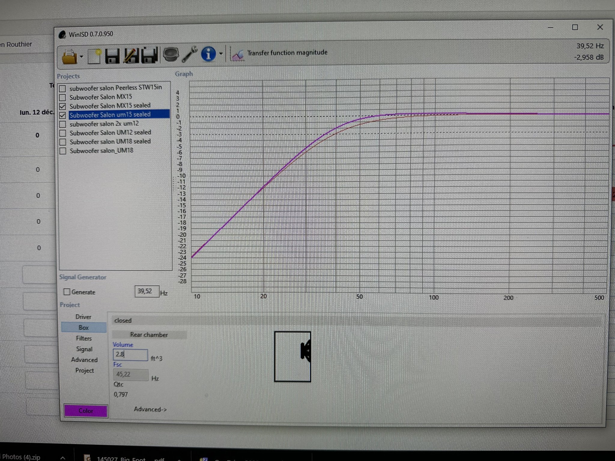

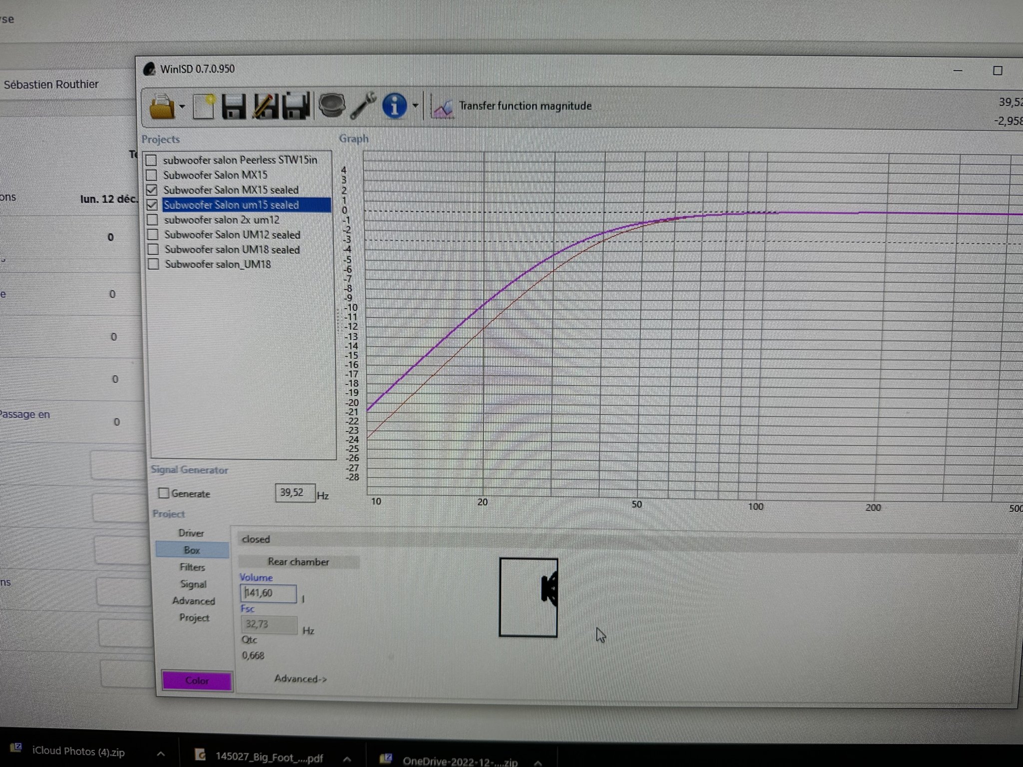

?? Dual (2) 15UM-22 in ~141.58 L = ~0.96 Qtc using the only sealed math I know whereas Hornresp (HR) computes it as a 1.0 Qtc, so no audible difference, just included it for completeness.
Using 'my' math: 150 L for a single (1) 5UM-22 = 0.743 Qtc.
For an optimal 0.707 Qtc = ~177.5 L, so x2 (dual) = ~355.1 L.
As per winisd, I get quite the contrary of Horn resp.
@141L with 800w I get an f3 of 35hz with a qtc of 0.66.
@ ~70l (2.8cuft) I get a qtc of 0.797 with an f3 of ~ 35hz (?!) too. Still 800w.
Whatever I seem to be doing, I can’t get lower f3. Didn’t play with filter tho.
Look at excursion, down low it can't handle 800 W sealed.
These the specs you're using?
Double checked my math for 141.58 L, so no clue why you're getting 0.66 @ 141 L unless not using the same specs as me.
2.8 ft^3 = ~79.28717 L per this nifty little freeware I've been using since its inception after finding that the DIY audio 'world' had become metric since I had last been an active 'member'. 🙁
Regardless, whether (2) in 141.58 L or (1) in 141.58/2 = 70.79 L = 0.96 Qtc.
As for how accurate the math is, have never done accurate enough measurements nor done any sims to compare with, though others have and TTBOMK no has noted it being off, though from sims it's obvious it can be off a fair amount in some cases and still not be audibly obvious due to room acoustics, etc..
F3 is a fairly complex math problem for me, but my math's link has an F3 calculator using Qtc, Fc, which are easy math = ~0.96 Qtc, ~39.83 Hz Fc = ~31.92 Hz/F3
..........but F3 (2x power) isn't of much use since we can barely perceive the difference, F6 (4x power) or higher is where we want to start looking for audible differences.
Sorry. With drivers taking a lot of power, the f3 of the "too small" cabinet can simply be ignored. The air inside the box works like a spring, the less air =the shorter= harder the spring gets. So you need more power to move the cone to the same excursion. Also, the cone instantly returns to zero, when the signal is cut. So the heavy cone does not flap around.
If the amp can deliver this power and the voice coil can take you are done. Sure, from an economical standpoint, a larger volume is better and needs less amp power. If size is not limited, a Qtc as low as .50 is fine for active speakers.
