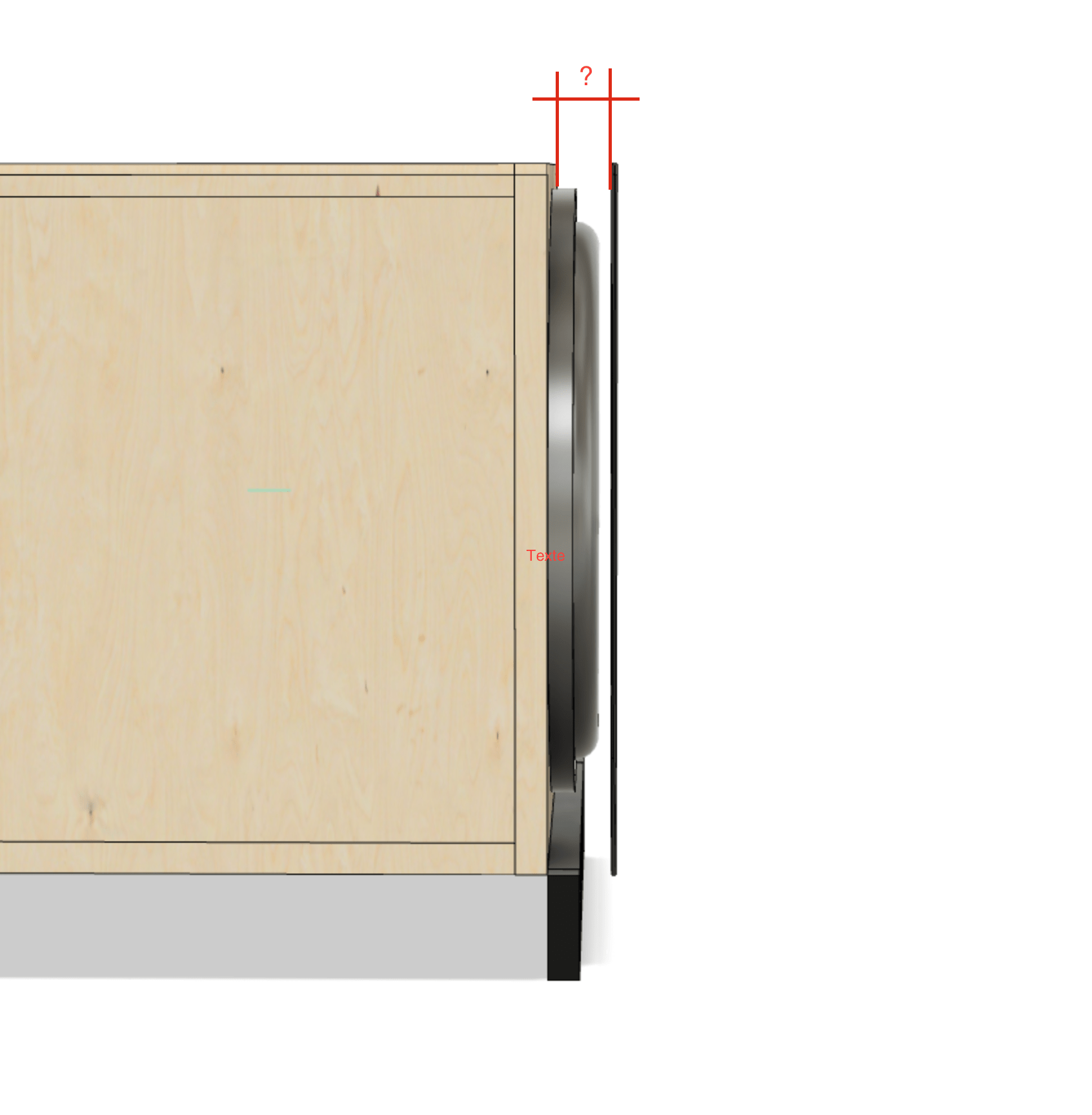

Was asking for my speaker grill. and wanted to know If i use 3/4 birch ply if it wouold cause problem with the excursion. So I understand that it will not cause issue.
That may depend on what kind of EQ you are running, how much power, what frequency, etc. Xmax is not normally a hard limit. It's an indication of the linear range of the driver. Xmech or Xdamage is the physical limit of the suspension, and on some drivers it can be significantly larger.
I'm also not clear on where your 19 mm of grille depth is starting. The flange of the driver and the surround both may protrude beyond the baffle depending on how the driver is mounted. Sorry if you already dealt with this earlier. The thread is getting long, so it's hard to keep track of everything.
yeah, its getting long. No worries. I didnt think I would have 10 page of reply when starting this thread haha.
In the past, the box had double baffle, but from previous comment, this is not required (since there will be bracing).
so the I had the woofer on the first baffle, and I had a second 0.75in plywood on top of the first.
So basically, my question is, what is the 'safe' distance for a grill to be (from flange, baffle, or anything else)
I'll probably recess the driver like 6 mm in the 0.75in plywood.
From Dayton audio tech sheet, the flange thickness isnt spec'ed.

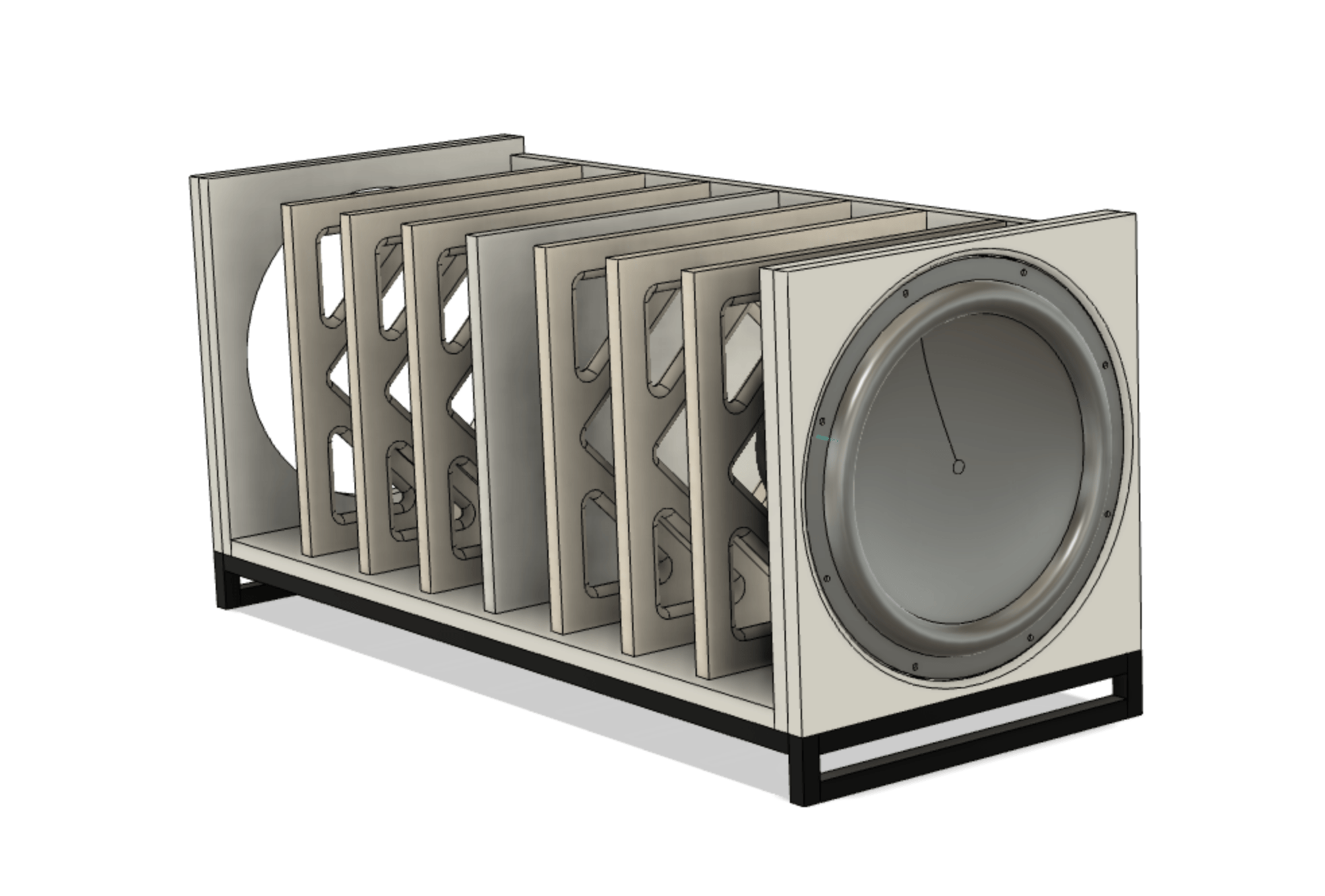

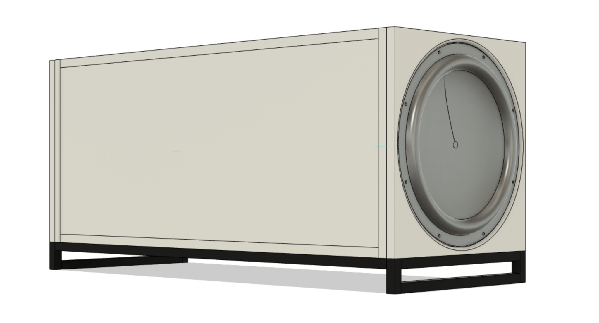

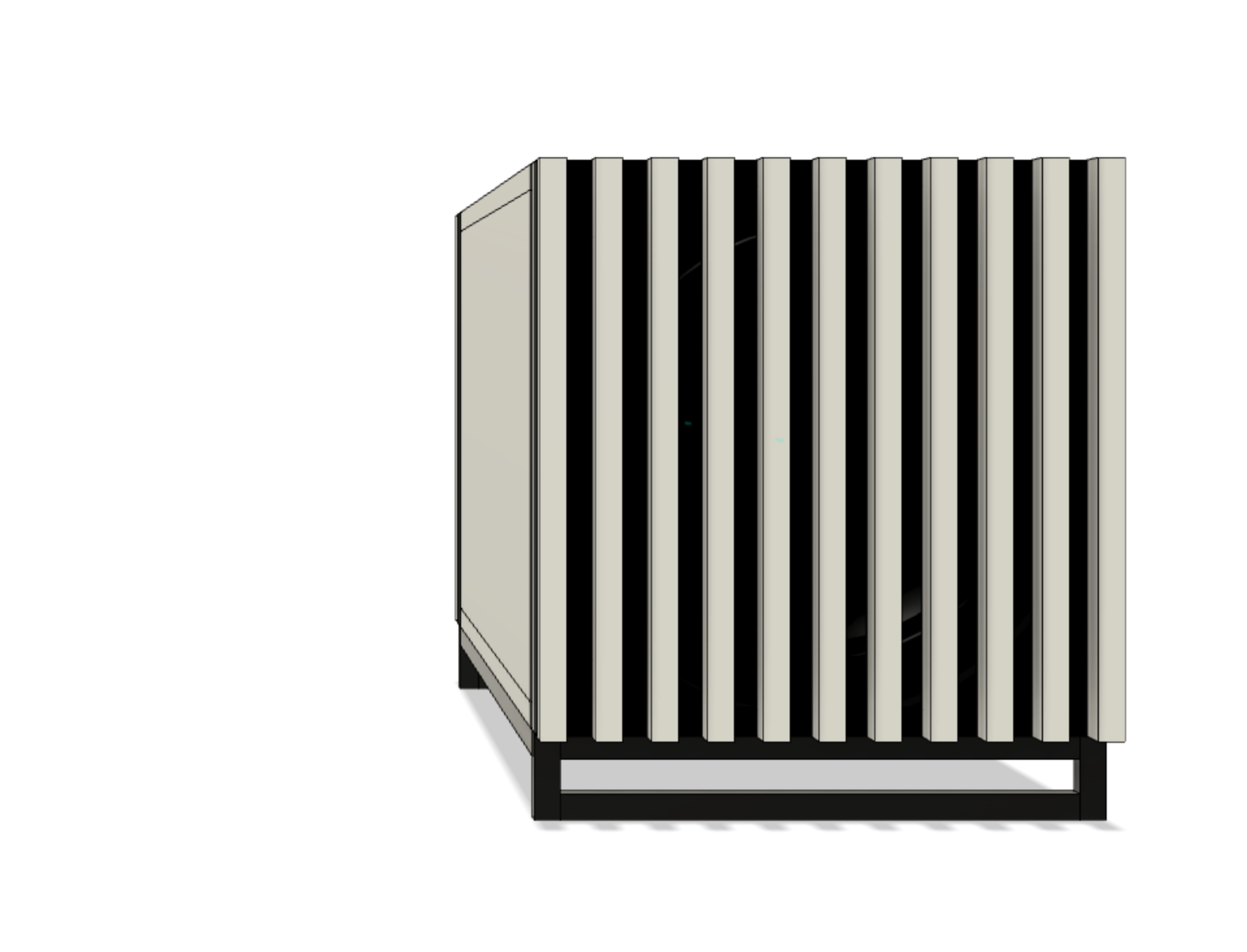

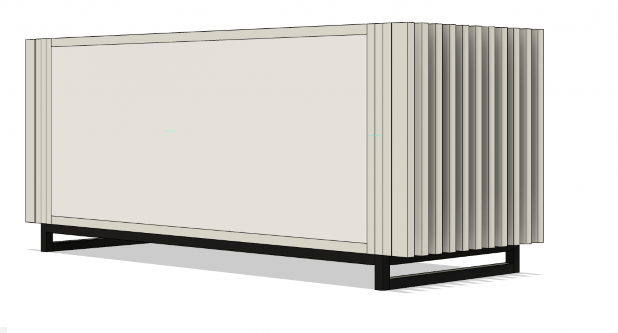

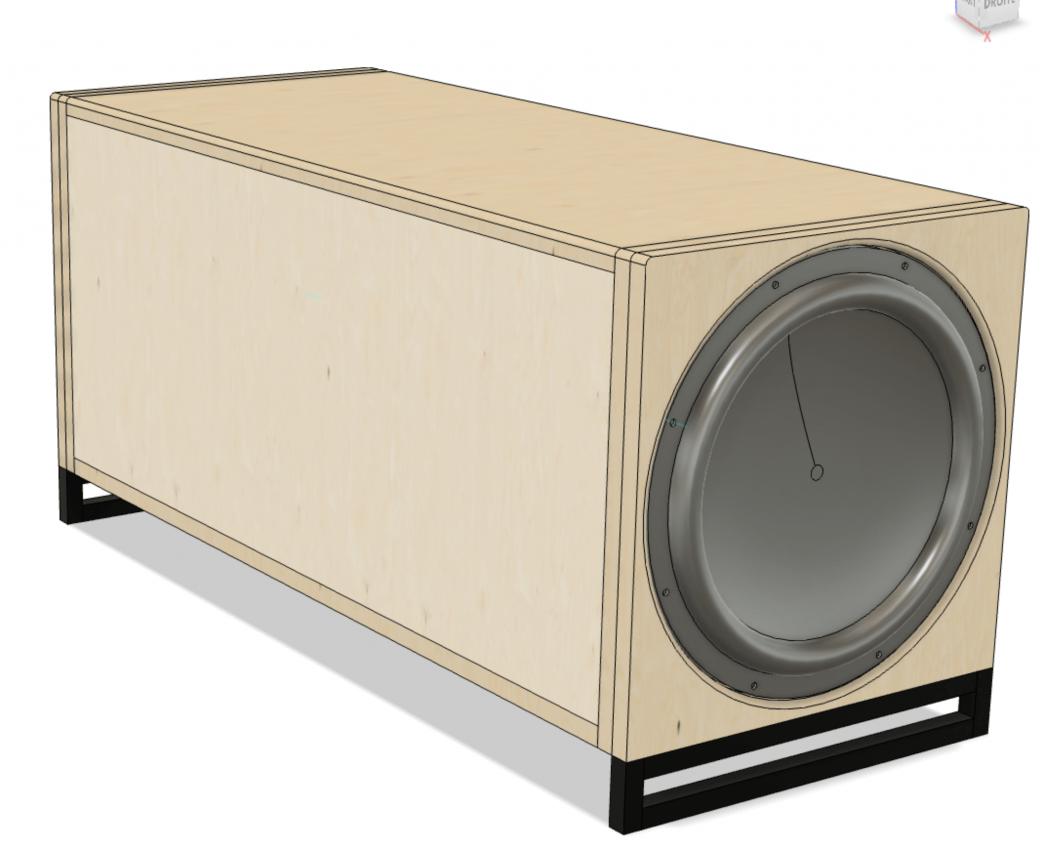

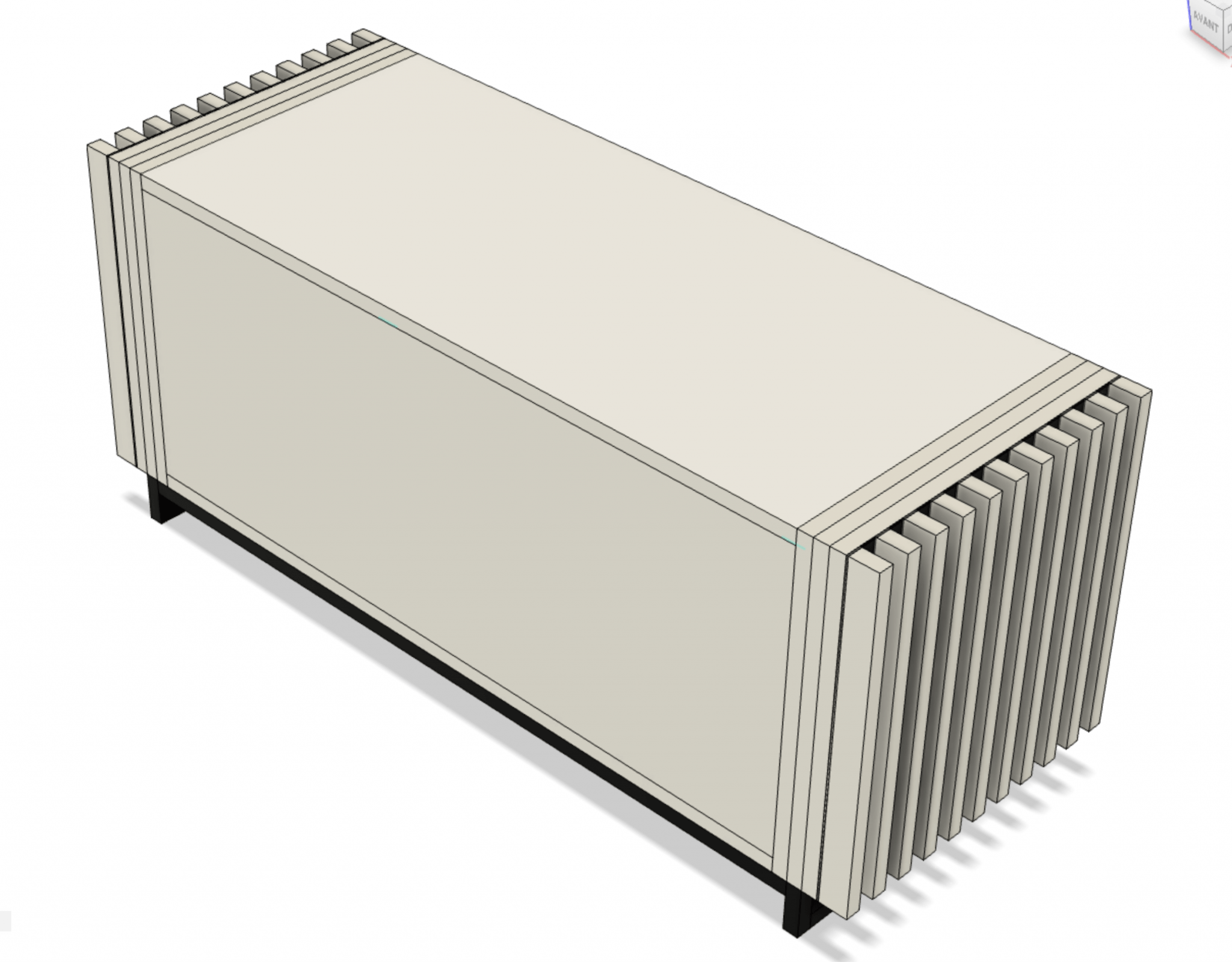

Updating on the ''gril'' design: as in the screenshot, the woofer is recessed in the second baffle (outermost).
One 3/4 plywood is added for distance from driver. Bug/pet screen, or maybe laser cut acrylic. than 'slat' for aesthetic.
Last Screenshot is without the grill...

If you build a divider, just do not make it in a 90° angle, but something from 25-45°. That way the sound does not get reflected as a straight wave, which fits exactly one wavelength, leading to a strong resonance, By the way, inside bracing has some sound wave diffusing properties too.
This is something I do if it is possible, just to make a good design better. It is no "must do", as the usual sub woofer theoretically does not emit high frequency which will fit between the walls. Anyway, it can not do any harm, is usually no extra cost and can reduce harmonics.

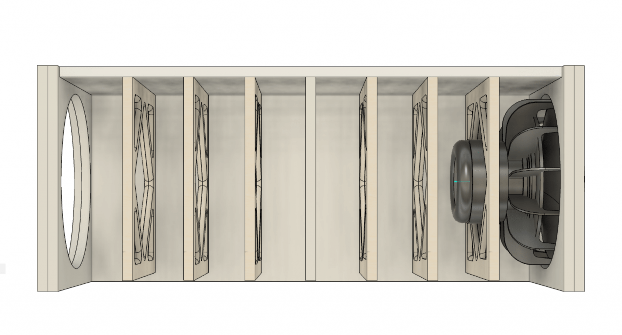

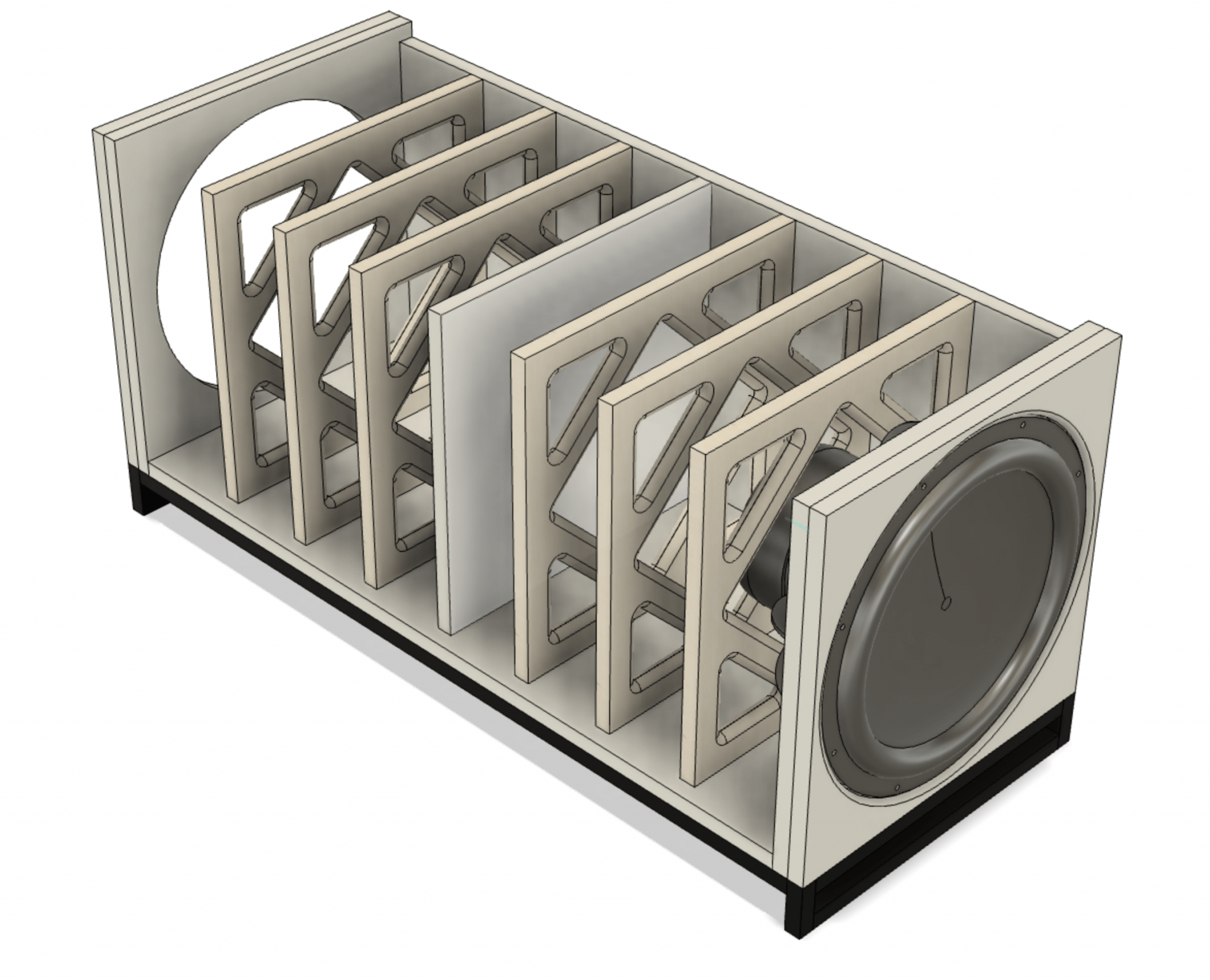

I know the divider is not 45,
But how’s that for bracing?

That cabinet looks really good.
Calculating costs, I think you shoud use stripes of wood, as otherwise you would have a lot of waste. On the other hand, you could use cheap particle board for the braces, which would not matter cost wise. The strength of plywood on such braces is overestimated. Particle board even has better inner damping properties, it's acoustic is more "dead". You can do the cut outs with a good hacksaw free hand. Might be too expensive to have so many meters CNC'd.
I would go for ply on the outside and particle for the inner parts, even when the wood was for free. MDF is fine, too. The divider can be particle board as well and 16mm are OK, because it does not see any pressure if both drivers get the same level. The wheight sums up....
The divider, as I told you, does not have to be angled, it is just a "nice to have" if it fits the design.
