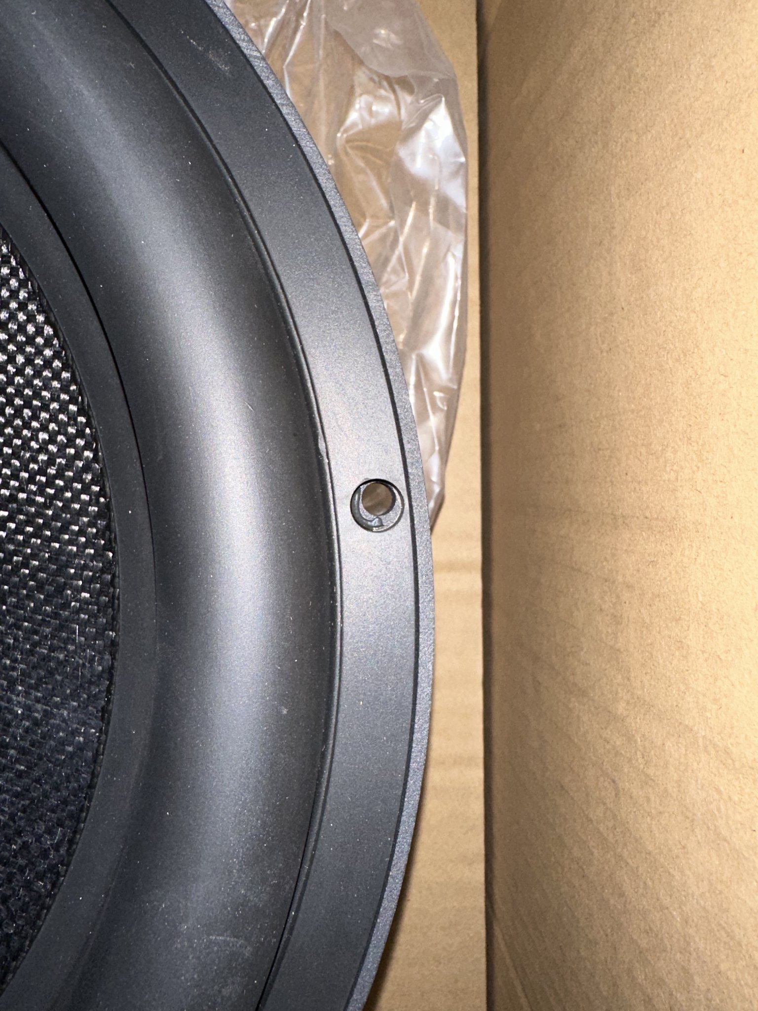

So I got the driver home for a few days now.

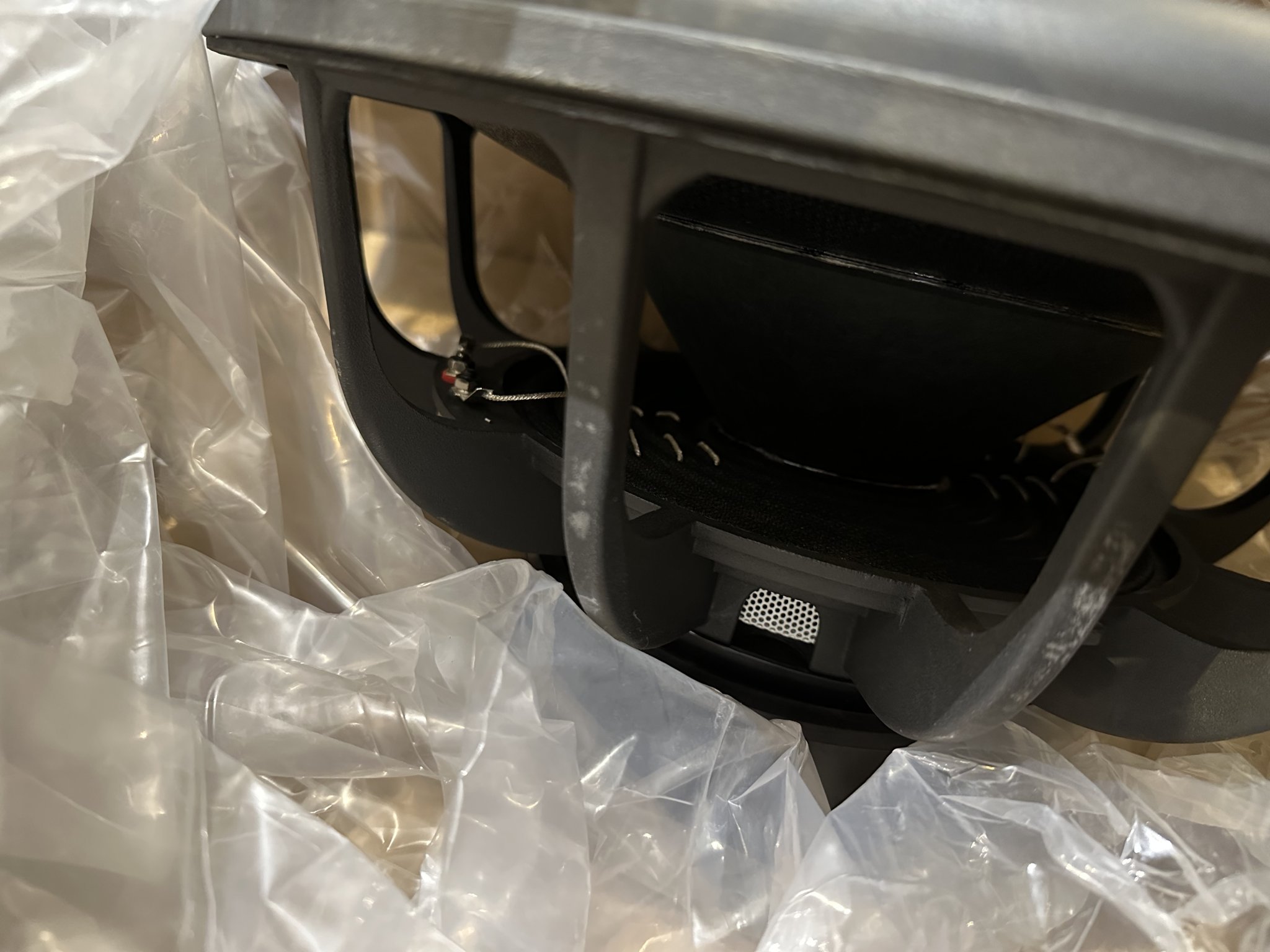

Got in touch with Solen because it seems like the drivers are missing powder coating, or are scratch.
Solen are coming back from holiday next week. So I’ll have to wait.
Also, I don’t know if I can rotate the top or anything, but the hole doesn’t seem to be align/Centered

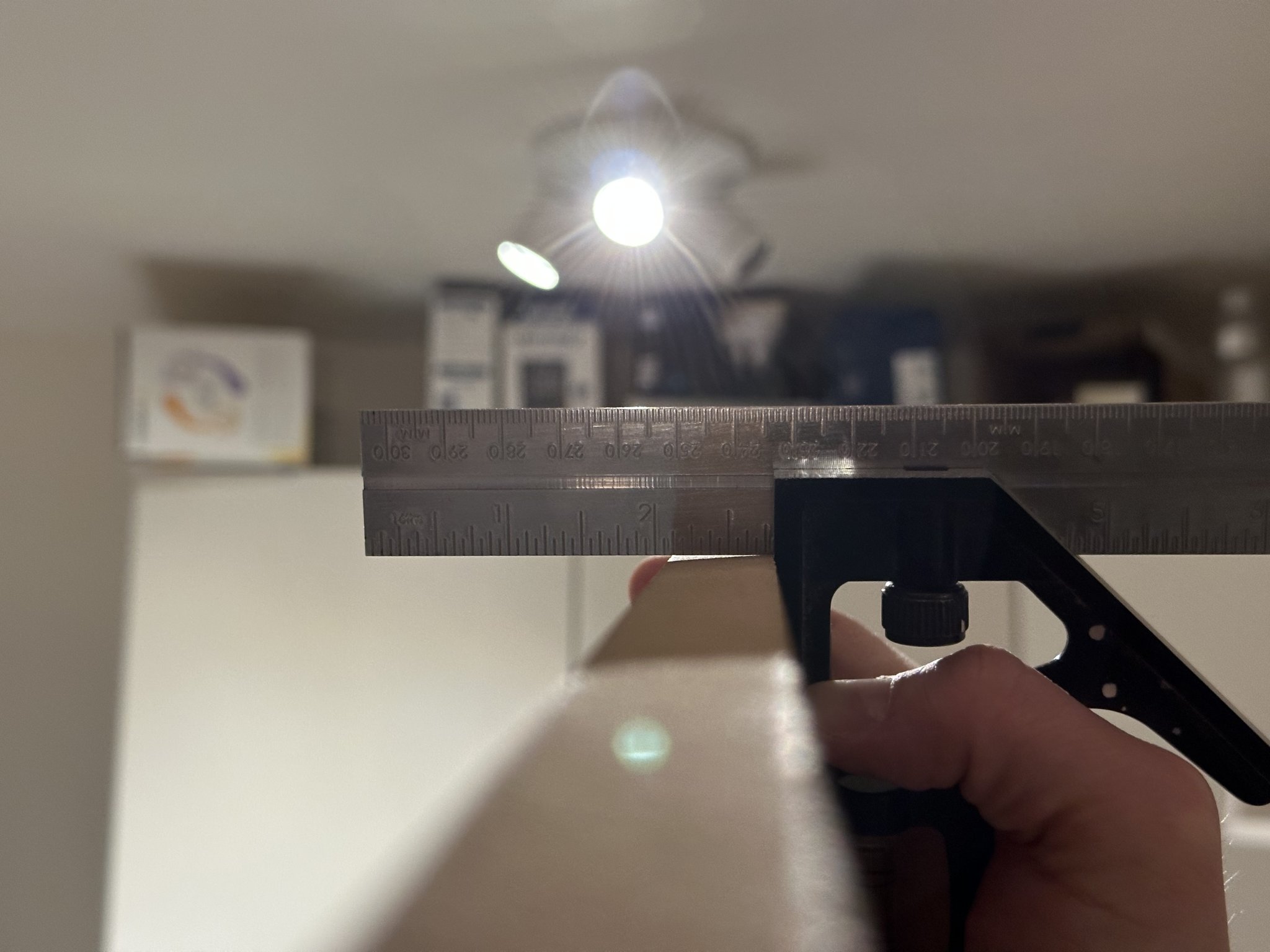

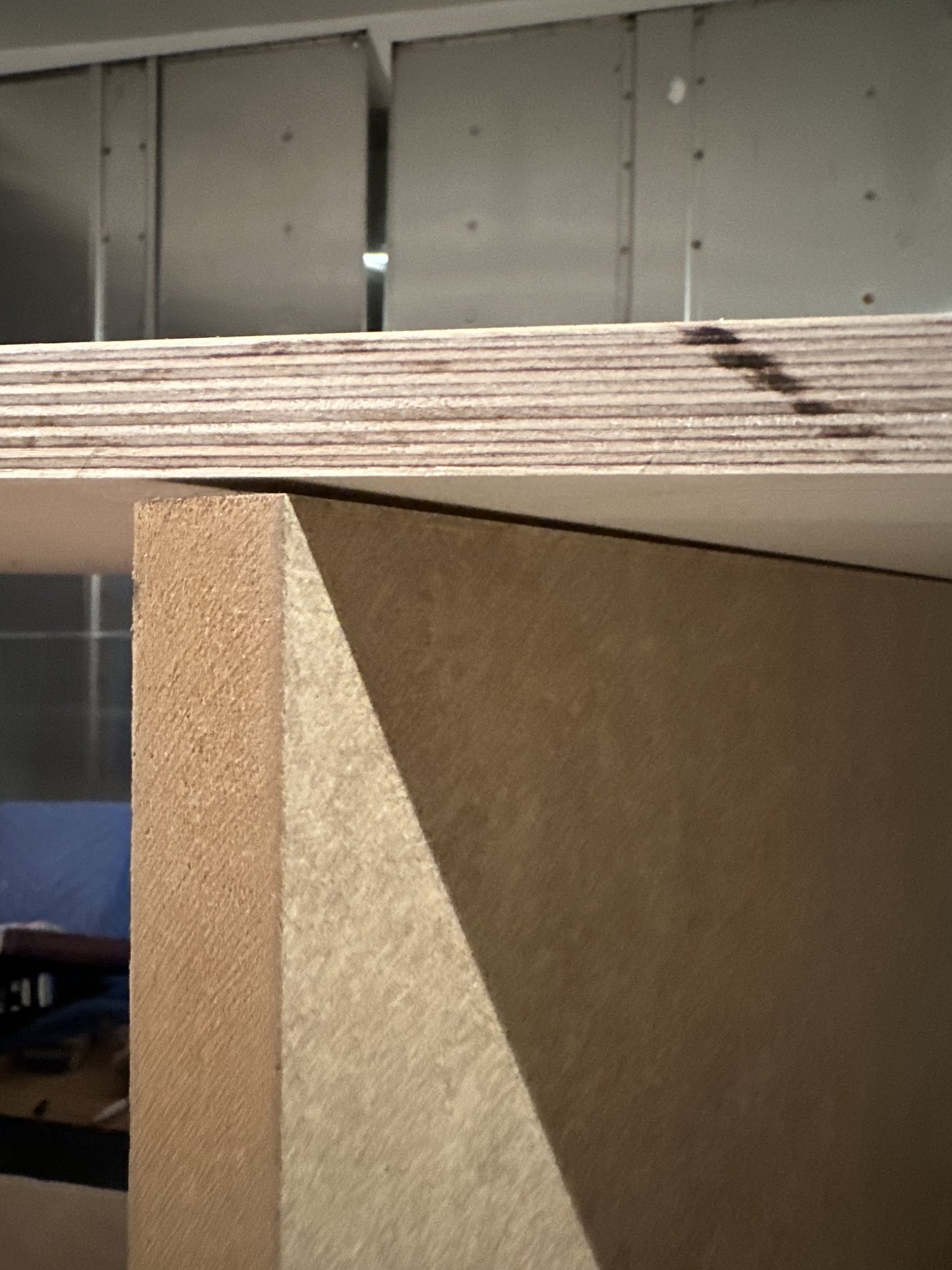

Also, I cut all the pannel 2 days ago.
None of my cut were good.
So I had to make a pass on the table saw on all the baffle pannel (4) and (4) grill baffle (pannel that will be used for the grill as spacer before the slat).
Fortunately, the other pannel seems to still fit the size and the newly sawn panels.
Also, I knew 3/4 plywood wasn’t really 3/4, but never measure and update my cut list accordingly.
Think I saved it today tho. Nothing bondo and/or pl glue can’t fix. But time will tell.

With the drivers, the hole not 100% matching is a very usual, minor fault.
The scratches at the basket may be from putting them into boxes. Nothing I would even think about. They are quite heavy and may get scratches from their own weight.
At least nothing has anything to do with sound quality. Remember these are very low priced in comparison to comparable drivers.
Is there anything to do with the un-aligned holes?With the drivers, the hole not 100% matching is a very usual, minor fault.
Manufacturing tolerance is +/- 10% for drivers [ mostly] so that misalignment is nothing, cosmetic only and will in any case be hidden by the washer you need to use when screwing them down.

10% is huge when it comes to tolerance of such a big company.
It’s like sayin on a 10cm (or 10in)lenght the hole can be 1cm (or 1 in) away. That’s huge.

If you look at the product image on Parts Express, you'll see the same kind of misalignment.If it’s only glue and gasket I can unglue it and rotate the gasket to align the holes, from gasket and flange, together.
There's no way I'd even think about trying to unglue something like this to improve a purely cosmetic issue. Of course you can make it relevant to you, but you're just increasing your misery.
Like it or not, many drivers are still partially hand assembled, and it's common to see minor issues like this on surrounds/gaskets/frames. Soft parts are also difficult to trim precisely because they deform easily. This isn't a boutique item that's making money off cosmetic perfection, so they're also not going to spec everything like it is.

If you "unglue" the cone, it will not be centered any more and the driver unusable.

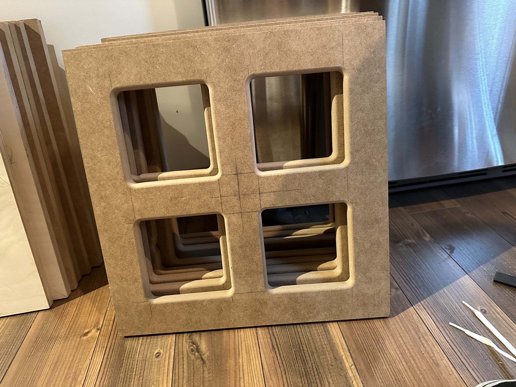

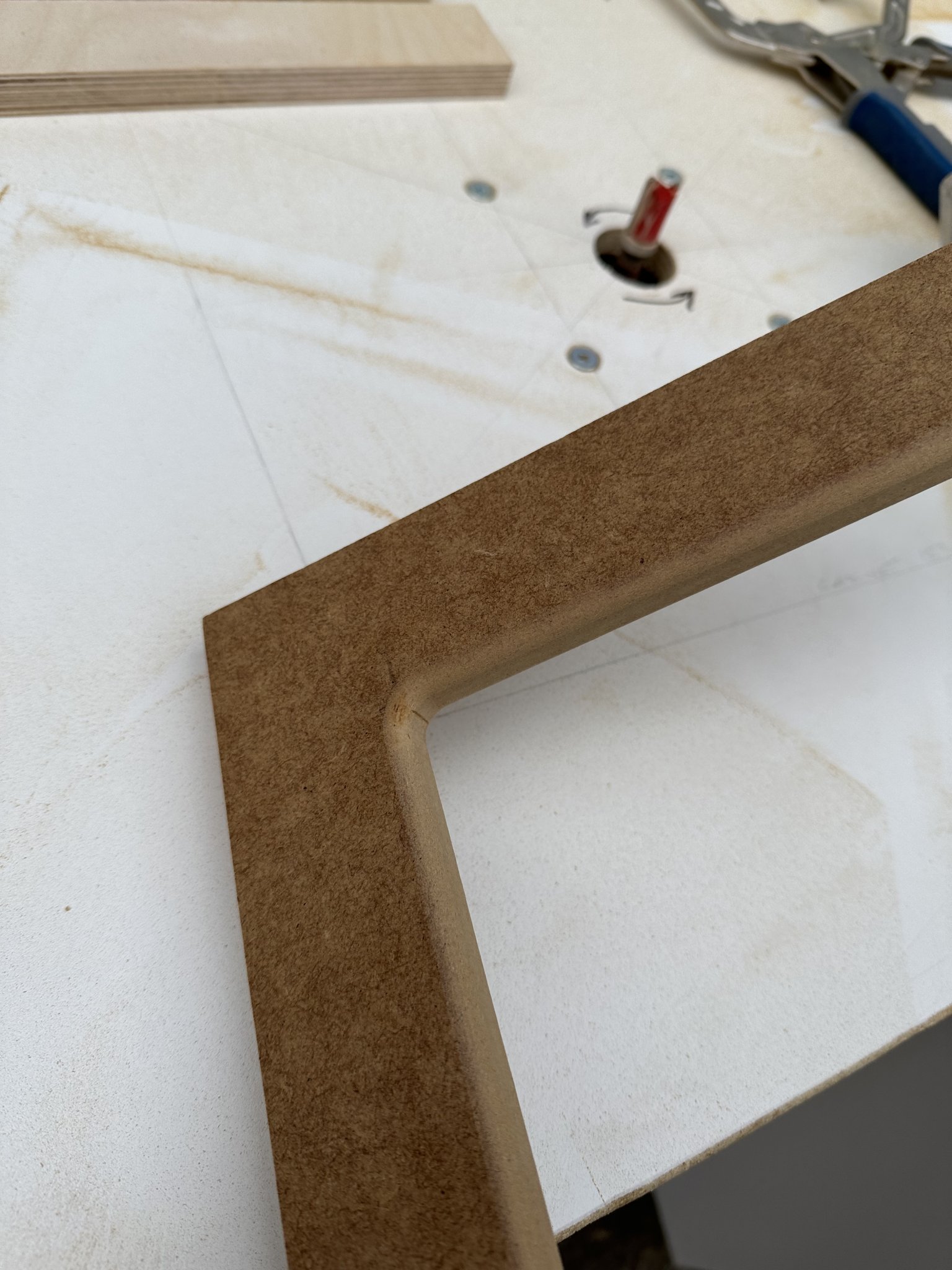

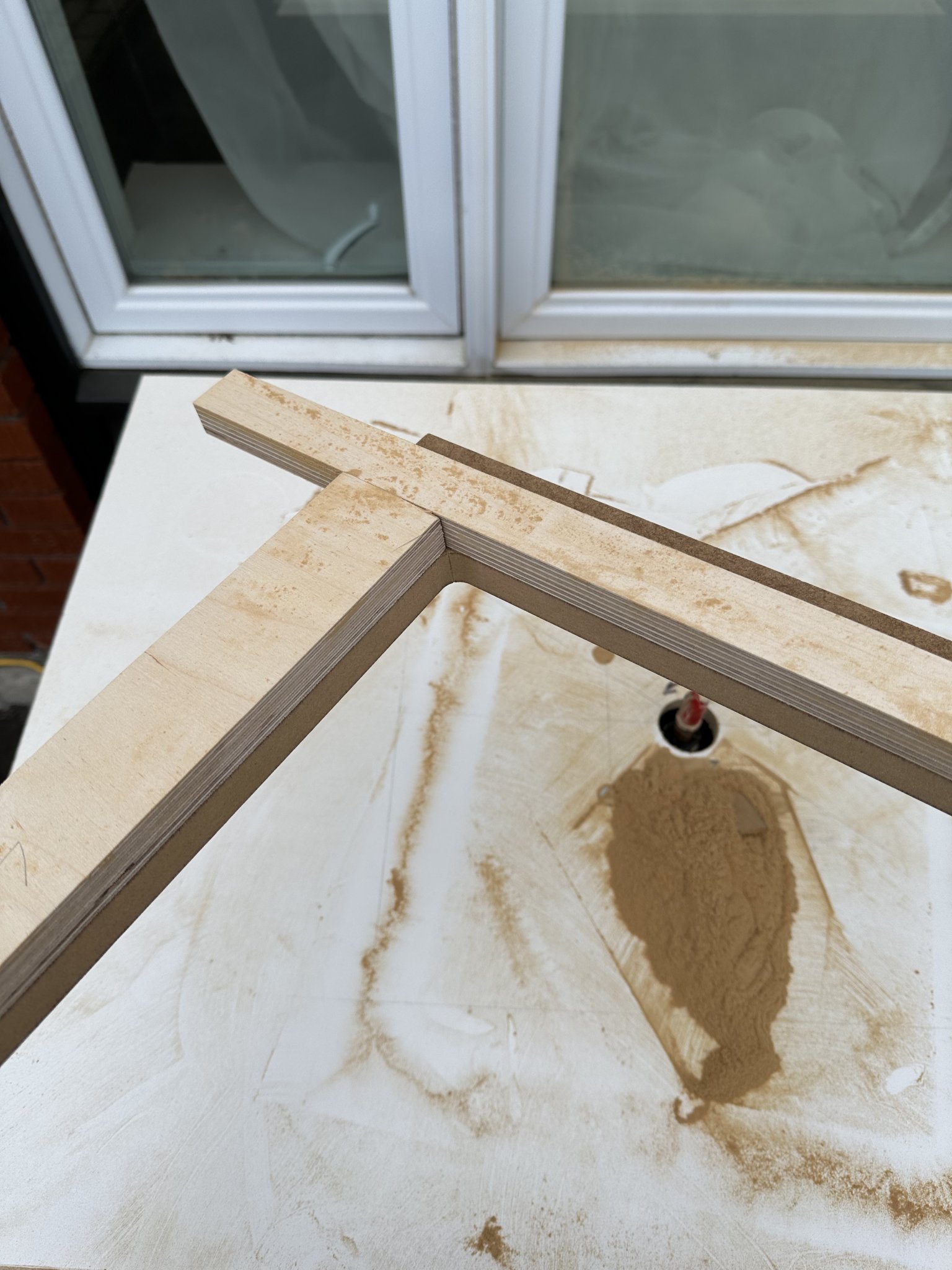

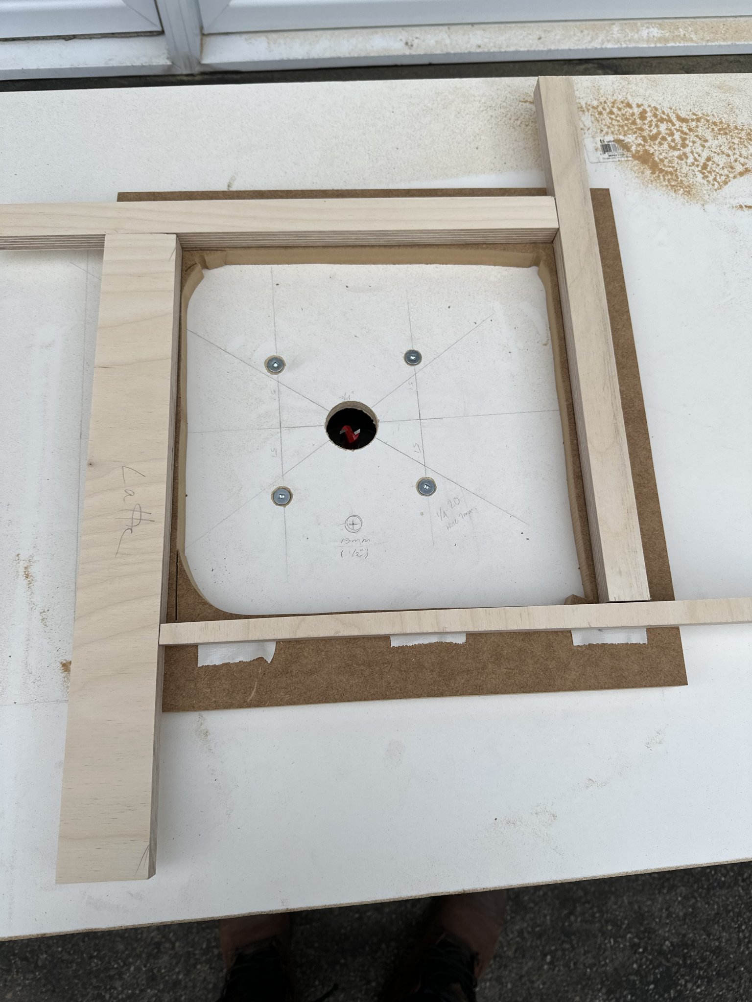

In the meanwhile, I cut all my pannel and made all the brace. Did 2 window brace because why not. And quarter rounded all of them.

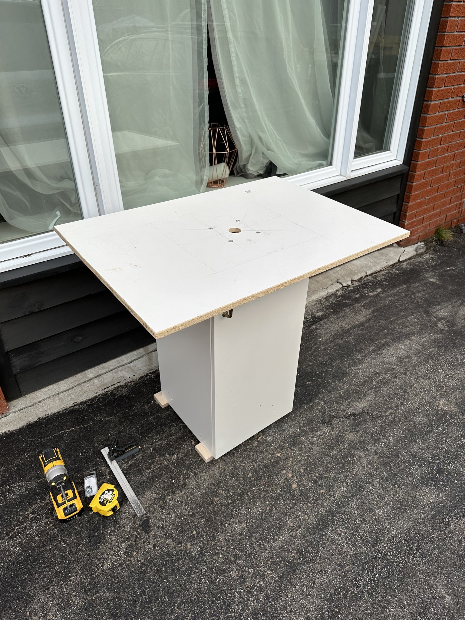

In order to do this, I upcycled an old ikea 15in wide cabinet. And used a 24x30 melamine sheet I had from a temporary counter we had when renovating the house.
I have to say it again.Didn’t mean to unglue the cone.
Juste like the “gasket” spurns the flange which seem to cause the unalign problem.
It’s hard to tell it’s it’s a soft or hard part in the Center of the flange/surround. Don’t know how to call this part.
It isn't a "problem" it is merely a very minor cosmetic issue and will have no effect on the performance of the speaker, so long as you use washers under the bolt head.
Excellent repurposing of an old cabinet
Nice work on the window pane braces
I add small blocks of scrap timber/MDF/Ply where the brace meets the box sides, and at random alignment.
Some people thinks it helps with breaking up vibration on the panels

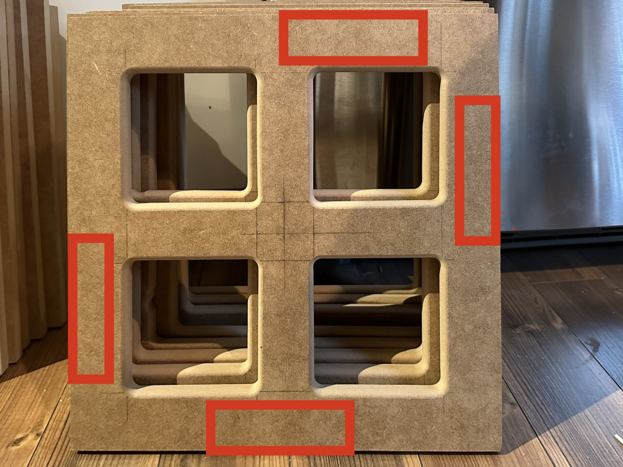

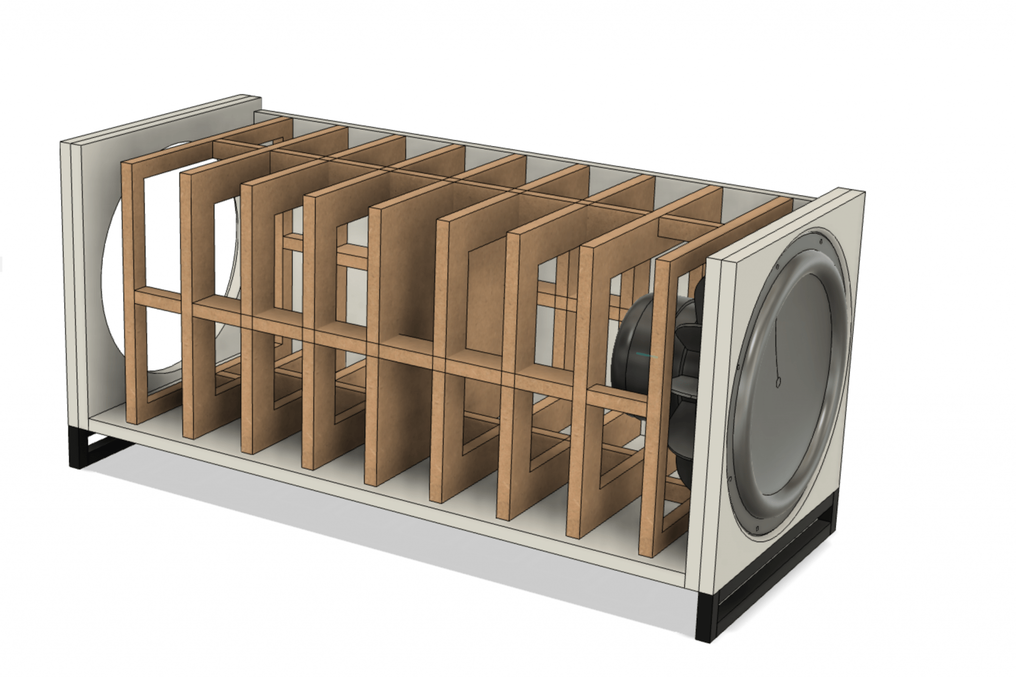

As per your tips on the bloc you add, you want to make sure I understand it right.
You’d do something like this,
even tho I have brace that will look like this:
Or is it the same thing, but instead of placing them all in the middle you would place them randomly?
Note that the middle pannel that divide the box into 2, will be at 30%. I now have 2 window pane brace as I wrote a bit earlier that will be install towards stage 1/4 of the box, on each side. So let’s say, #3 brace and #7 (starting from the left)

I think that with 4 braces evenly spaced you will do ok, what you picture is a waste of material and just add more weight, is like when you have laundry for 1 measure cup and you put 3 measures, you just waste 2 measures cause wathever you add more than 1 measure will not make your clothes cleaner, just wasting resources.I know it’s not a problem for most of you.

It’s hard with bracing.I think that with 4 braces evenly spaced you will do ok, what you picture is a waste of material and just add more weight, is like when you have laundry for 1 measure cup and you put 3 measures, you just waste 2 measures cause wathever you add more than 1 measure will not make your clothes cleaner, just wasting resources.
My 2 cents.
Some people says 4 will be enough, some people says what I did is a good starting point 😂😅
I use in addition to the bracing you show, but much smaller than the detail in your drawing, say 42 * 70mm; I use a lot of 42*19mm planed timber but I don't use as much window pane when I do use it.
If those longitudinal bracing bits are centred as per your drawing them all the sub-vibrations add up, as per Planet 10 the ideal is for those to be staggered, say for instance 1/4; 1/3; 1/2 or at random by adding or subtracting some nominal amount like 11mm to each spacing.
GM mentioned in my build that the usual amount / maximum amount of bracing is 10% of the internal volume, I never bothered to add it up or guess it tho but I am sure it was a less

Just build a cylindrical cabinet with longitudinal braces... mount that in a "normal" box. The box won't be subjected to any acoustic pressure so it can be light and the cylinder should be the lightest geometry per internal volume.
Sure, too late by now.... but that's why the El Pipe-O design exists.
