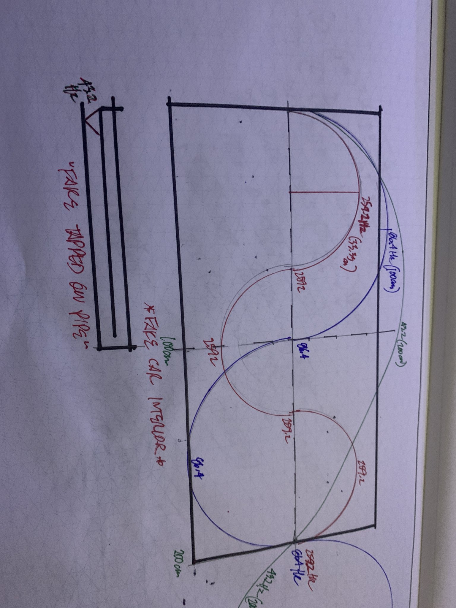

-( random sketch)

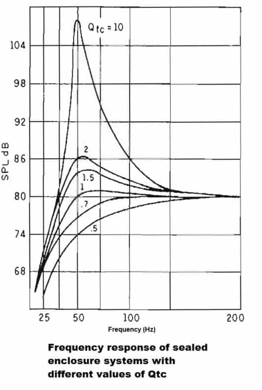

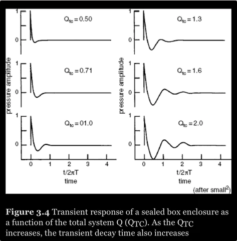

Between 0.707 - 1.0 with how much being very room dependent, where the speaker and you are and how 'intense' the audio is, i.e. the more noticeable the lower the fundamental since the lower the frequency the wider its bandwidth (BW), ergo the more it impacts the 'quality' of the higher frequency speaker's performance and one reason why folks are often very 'picky' about a speaker's performance in their acute hearing BW to point where they often prefer not to have a speaker go very low.
Oh I see. So a qtc of 1 will play much louder those lf. That’s why you were saying this.
But I think that the box will be way too big in order to have a qtc of 1 to play those low frequencies.
I’m a bit stuck in all the limitations I have: size, budget, waf, etc.
