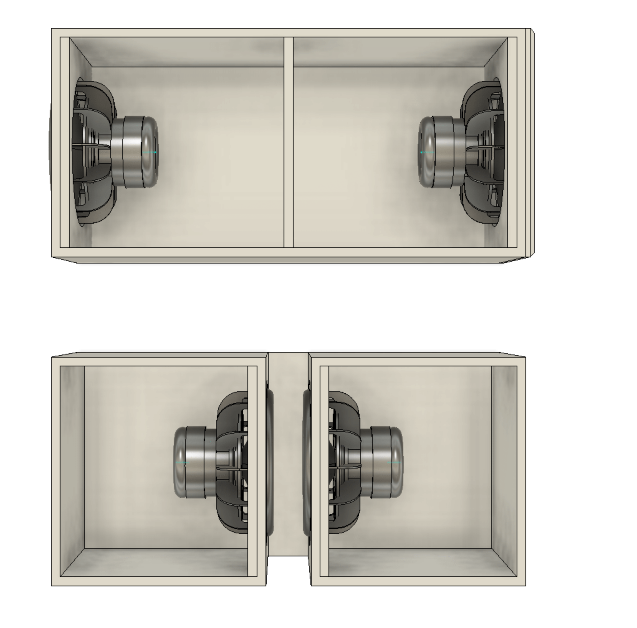

I, currently, am going for the 2: 15in in sealed 2.5 cubic feet.I think I may have missed something. Which box design have you decided to go with?
Because with those graphs I'd have picked the UM12 and built 2 boxes [ if room and WAF allowed] for the extra dB
The box without the slot.
Also going to adding bracing.
UM12 has better low end extension, but start lacking of output at 30hz.
With the um15, at 40 I have 3db more, and by 60 I have 5db.

One logical answer Is a UM15-22, which will give you a very impressive HT sound, you can only match with commercial products in the 4 digit range. If there are any which allow advanced DSP control around.
Your volume can take one 15" Dayton or two. Using two will give you 3 dB more max. level, and use up 4 times that much amp power. This is, with an iNuke 6000DSP, no real problem. (IMO one amp per driver will give you even better sound, as the iNuke power supply limit its output and Behringer is not really trustworthy with power numbers. You mentioned you have two of them).
So build your 5.5' cabinet in a way that may allow a second driver. If, after trying it single, you decide to really need the extra 3dB, you are not limited.
Of course, then use the benefit of opposing cones!

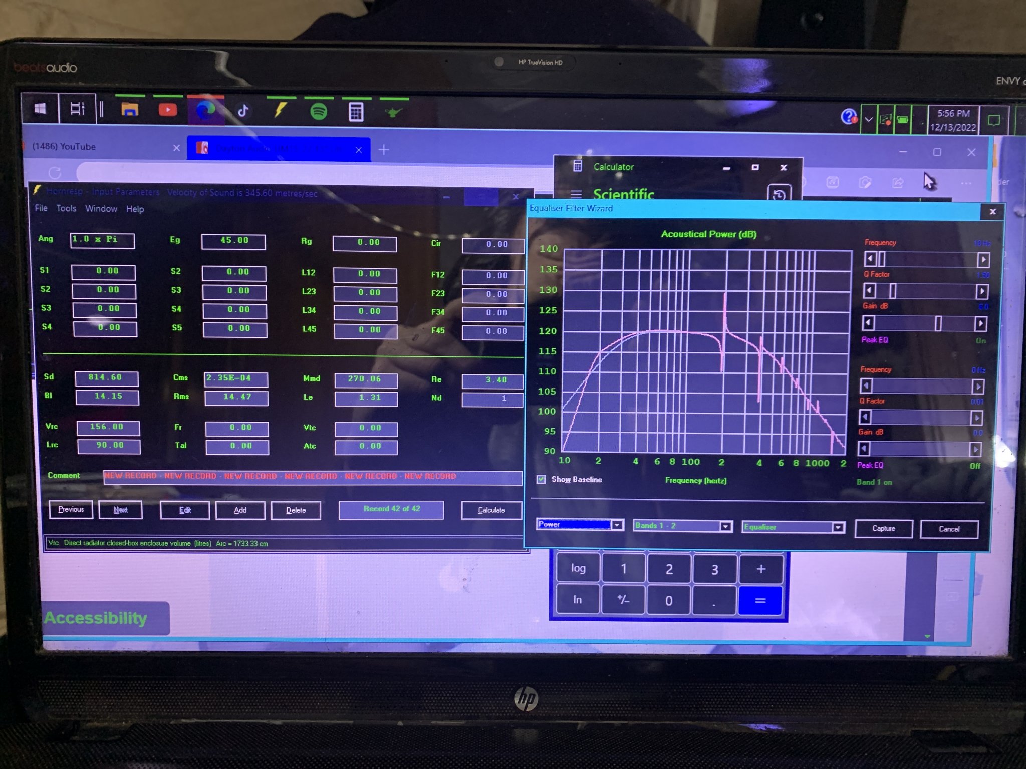

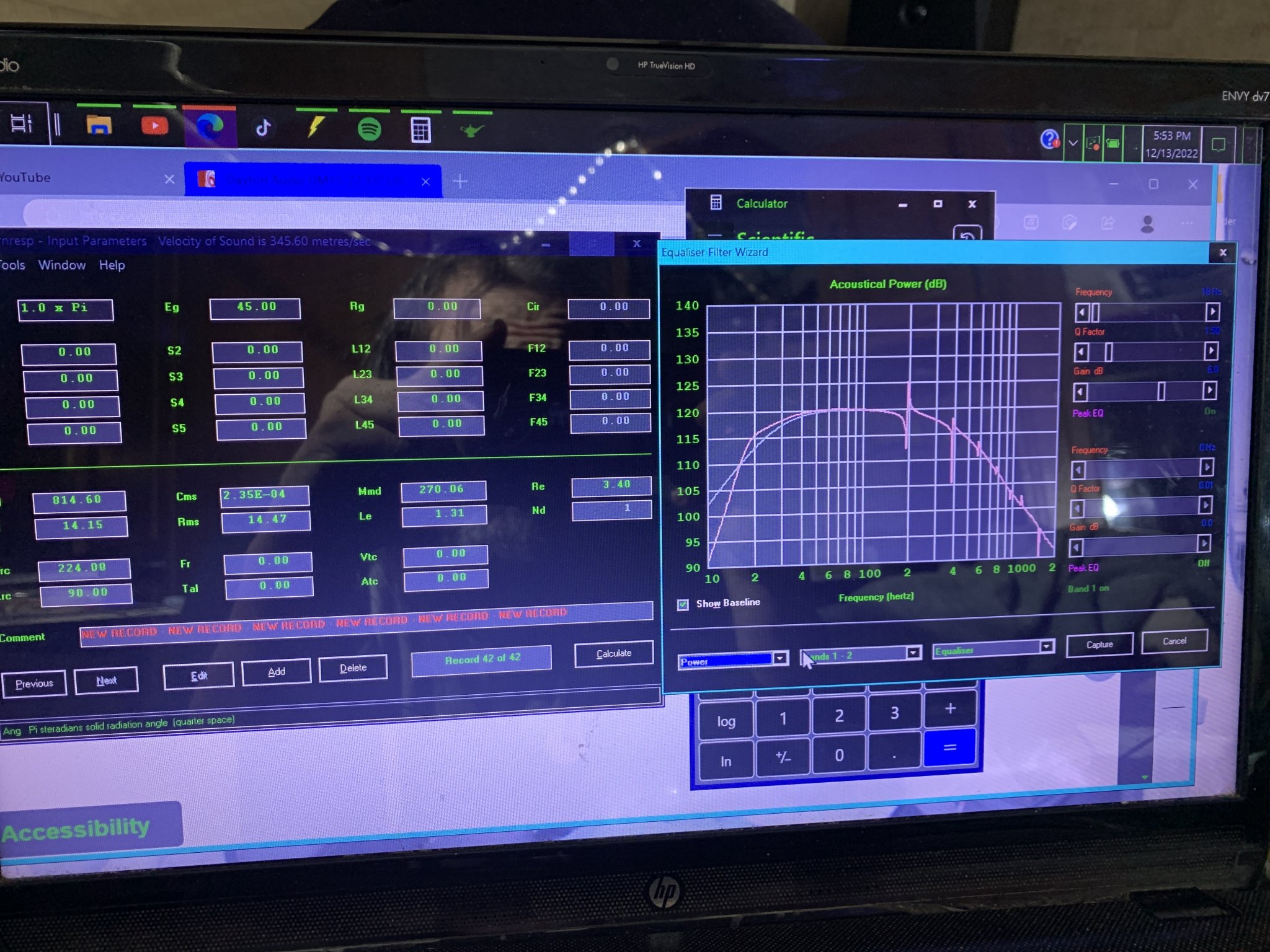

Please do not care too much about the simulated frequency response. If you use winISD, better do not look like hypnotized at the magnitude graph, but have an eye on max spl and cone excursion. You have to understand that in the end room and DSP give the audible impression.
In most cases, such a high power, long excursion 15" should give you anything you can expect from a high end HT.

I really value the time you guys take to answer.
You said to not pay to much attention to transfer function, because in room response won’t be the same and to look at max spl and cone excursion. Max spl, I get it, it come excursion? What information should I get from this graph? What to look for?
Also, I heard somewhere, and correct me if I’m wrong, but the UM15 would have the same “motor”/ magnet than the um12. Is that concerning?

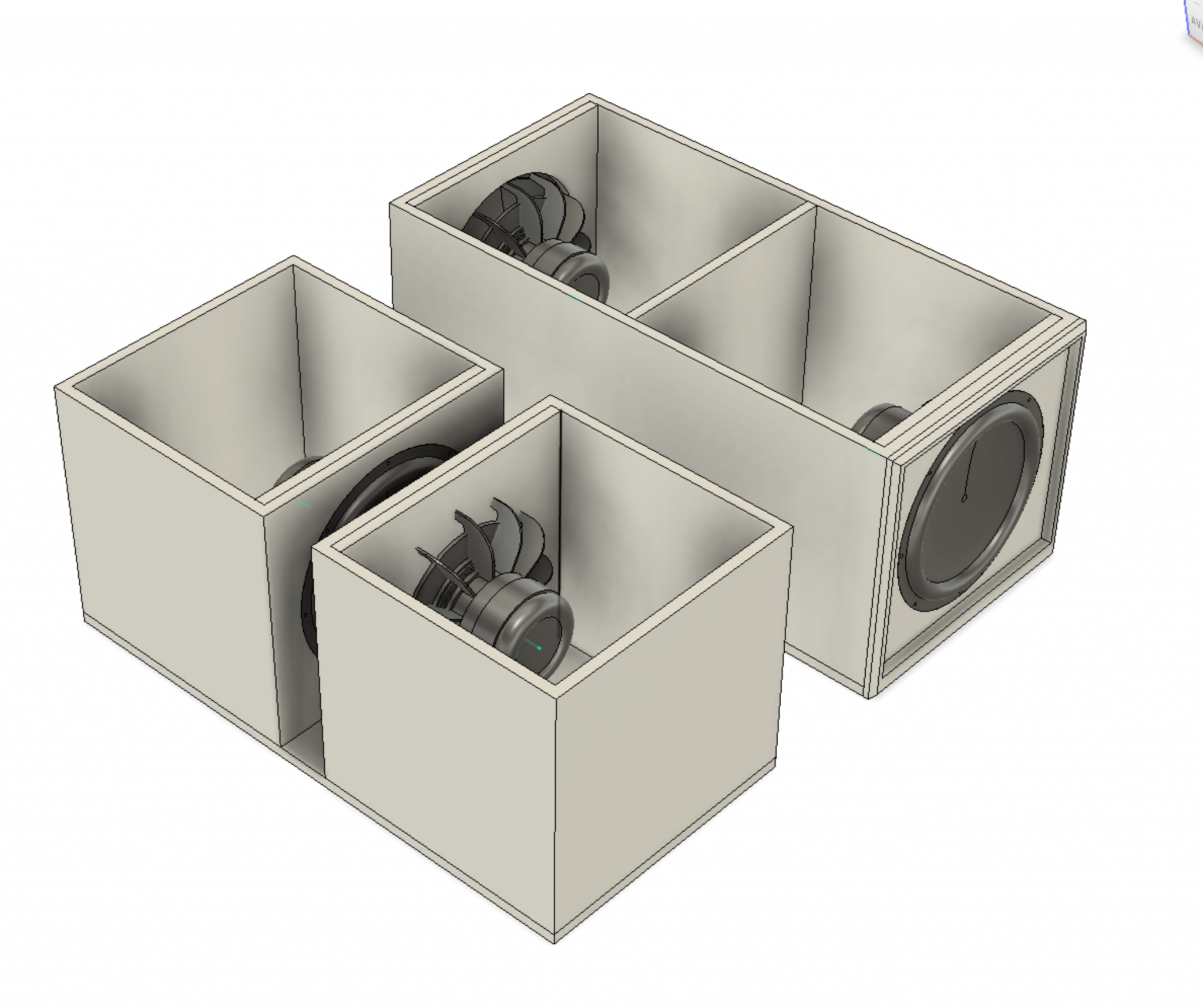

As discuss with GM, would it be benifical to build 2 box of 2.5-2.75 cubic feet, or 1 of 5-5.5 cubic feet?
Also, what are the preferred connector for such build ? Banana plug? Spade? Speakon?
The table box will sit on steel leg and steel legs will be on a thick carpet, on hard wood floor. Do I need anything between wood box and steel leg? And between steel leg and carpet/floor in order to transfer the least amount of vibration and all?
Thanks again for your time.
Cone excursion
is the way the cone has to travel for a certain spl at a frequency. Linear travel is what shows us the limit.
Mechanically it is half the height of the voice coil minus the magnet gap. With the UM15 this is 19 mm in and 19mm out. The red line at cone excursion. There are other ways to define it, as the magnetic field has no sharp ending point. Some brands would add like 1/4 to that value, making it 23.75mm linear. "Klippel" measurements define it when the driver reaches a certain distortion level and show this to match reality quite well. This is only of interest if the amp has enough power and the frequency is hit. Short bursts, like explosions, do not have problems with 10% THD for example. Music is something else.
If your driver data have been entered correctly for winISD, they should be like 19mm and 800W rms.
If you enter 23mm and 1600W manually at the point -driver-edit-parameter you will have a more realistic prediction for HT use with your amp.
Then go to cone excursion and open "signal". With a single UM15 you will see that about 1250W drive the cone to 23mm. "Maximum power" will show you similar results. This is the safe short time limit.
Please, take all these data with a grain of salt, as the in room result of a real sub working will be quite different. You see what such a sub can do to the air in front of it's cone(s), but not what the air does to your living room. With such a machine, be prepared to fix all kinds of rattling things, sometimes even not so well build dry walls resonate.
These are also the data you should keep in mind when setting the DSP. All this will become quite easy to understand when you have the sub in your room, a microphone connected and the DSP menu open. The iNuke has a very clever, level and frequency dependent limiter you can design around max cone travel. So if for some reason you increase volume over the safe level, the lowest frequncy will simply not get louder than the set limit.
So 20 Hz will stay at 109dB, while 30 Hz can still hit 116dB. In theorie, the in room level will sure be higher. As you can pass word lock the DSP settings, you can make your sub "teen party proof" that way.

Volume of cabinet.
If possible, I divide such a volume diagonally, as it reduces resonance inside the cabinet. Parallel walls are not the best in this sense.
You want to start with a single driver, in this case I would leave an opening of about cone area in the divider. Maybe close it with a prematched panel, when the second driver is installed. No need to go take very strong material, as the pressure on both sides will be near to identical. Same with the opening for the second chassis, screw in a piece of wood temporarily. This cover has to be braced from the inside, if becomes permanent.
The question single or divided volume for identical drivers is simple to answer. To prevent problems from tolerances within two identical chassis, separate is better, also, the smaller the volume, the higher the resonances inside are.
Last, a sub woofer usually works fine without any material inside. If you ask me, I will in almost any case fill it with some material like rock wool. First, it increases the virtual volume, leading to a lower f3, second, any higher frequency is damped. You can argue there are none, as you have a steep x-over. As there are no cons with stuffing it, I simply go for the extra 15$ as it really doesn't break the bank on such a project.

As for dividing diagonally, does It absolutely need to be from corner to corner?
I didn’t calculate undistorted level from front stage speaker.
How would I do this? Same way I did with subwoofer measurements?
Set the umik-1, and make some sweep and reading from 50-20khz ?!
If you build a divider, just do not make it in a 90° angle, but something from 25-45°. That way the sound does not get reflected as a straight wave, which fits exactly one wavelength, leading to a strong resonance, By the way, inside bracing has some sound wave diffusing properties too.
This is something I do if it is possible, just to make a good design better. It is no "must do", as the usual sub woofer theoretically does not emit high frequency which will fit between the walls. Anyway, it can not do any harm, is usually no extra cost and can reduce harmonics.
