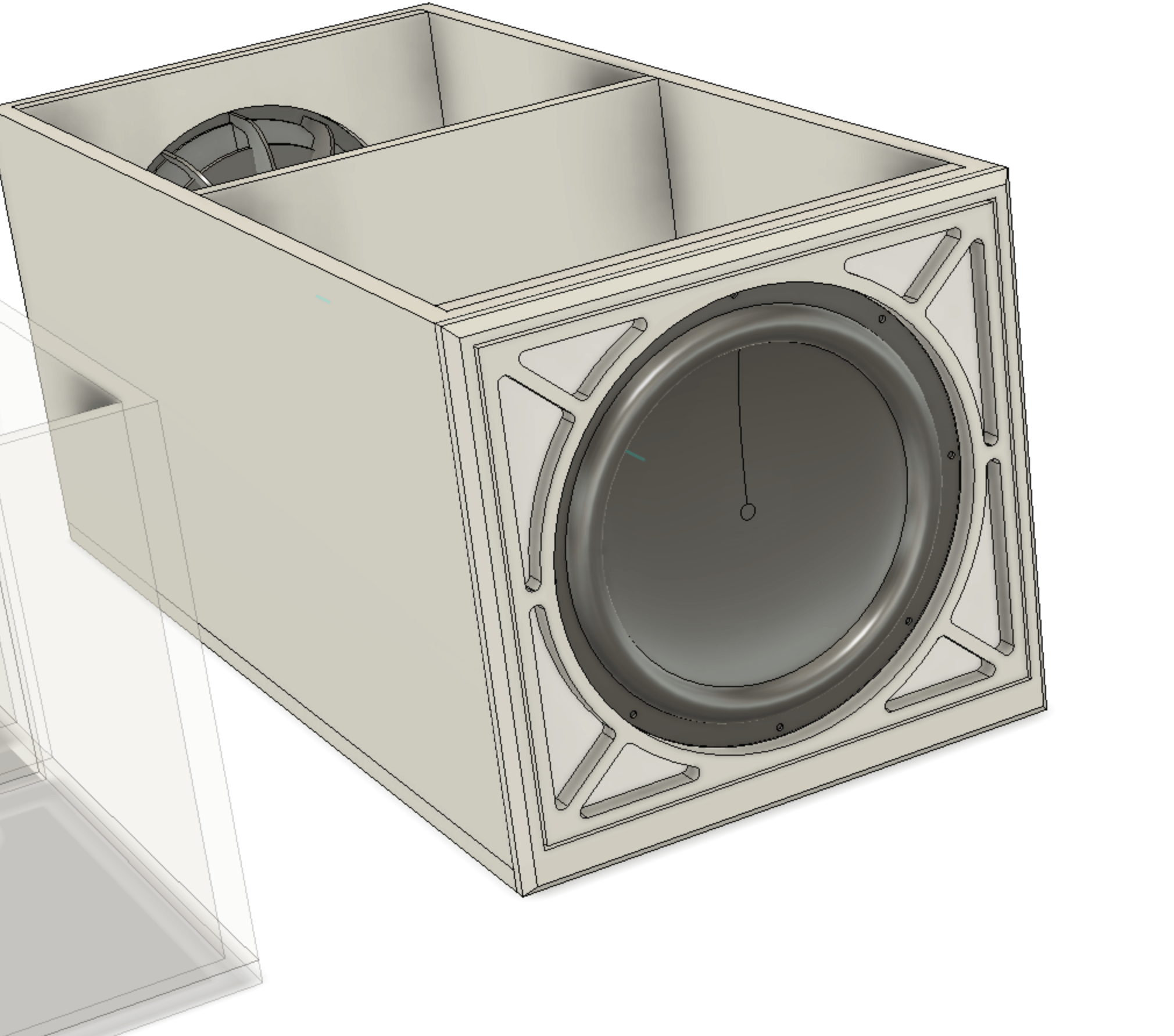

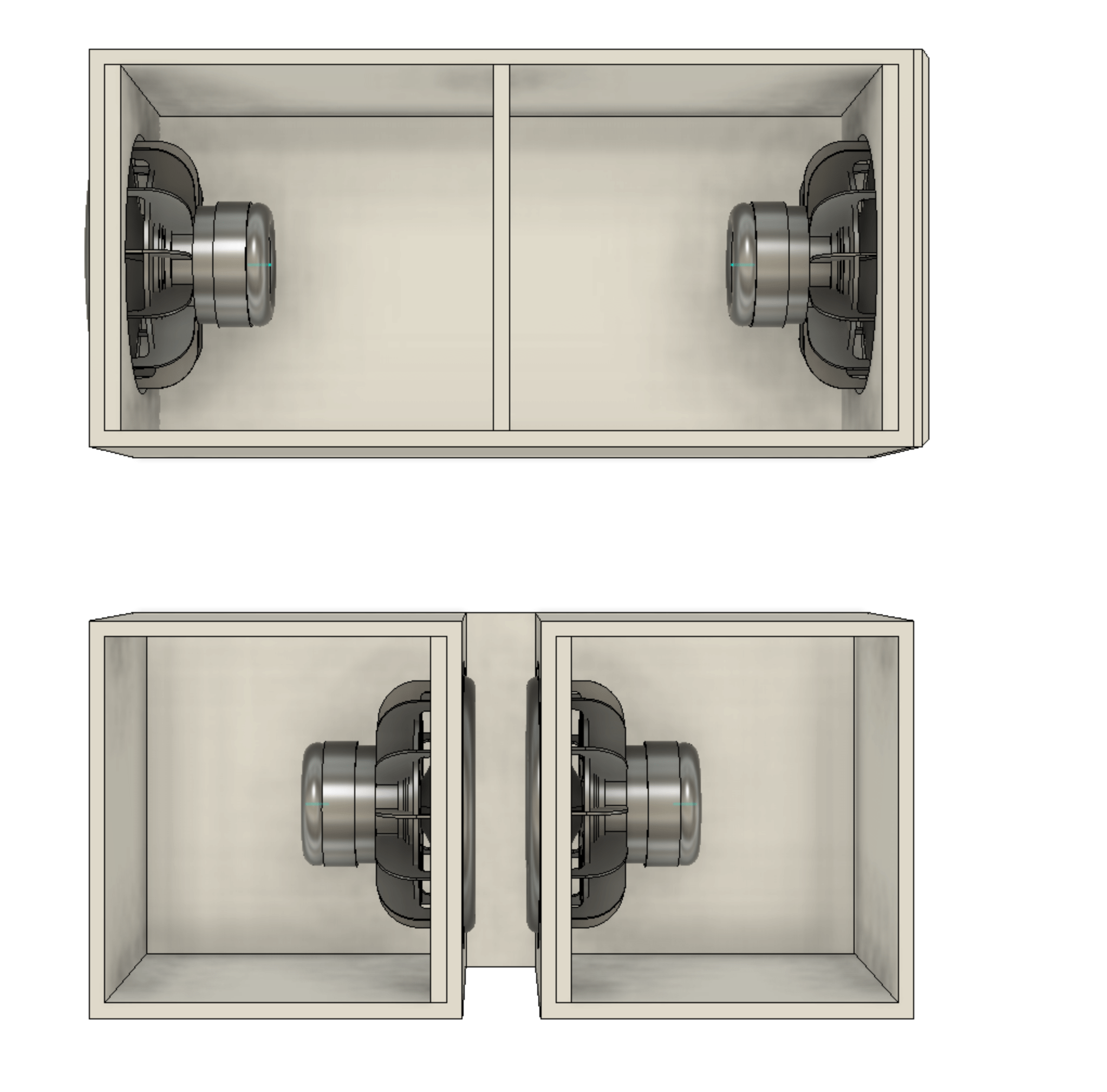

Two drivers on opposing sides of a cabinet are much better than a single driver. Sure!
If one can afford the cost and space, this should be considered. The moving mass of the cones, which can even moves large sub woofer on the floor at high levels, is completely canceled out. The cabinet is resonating much less. This has a hear able effect.
Having the cones left an right may even be an design advantage, if WAF is a factor. Think of a side board with an open shelf in the middle.
Not sure what is 2 side board with open shelf in the middle?!

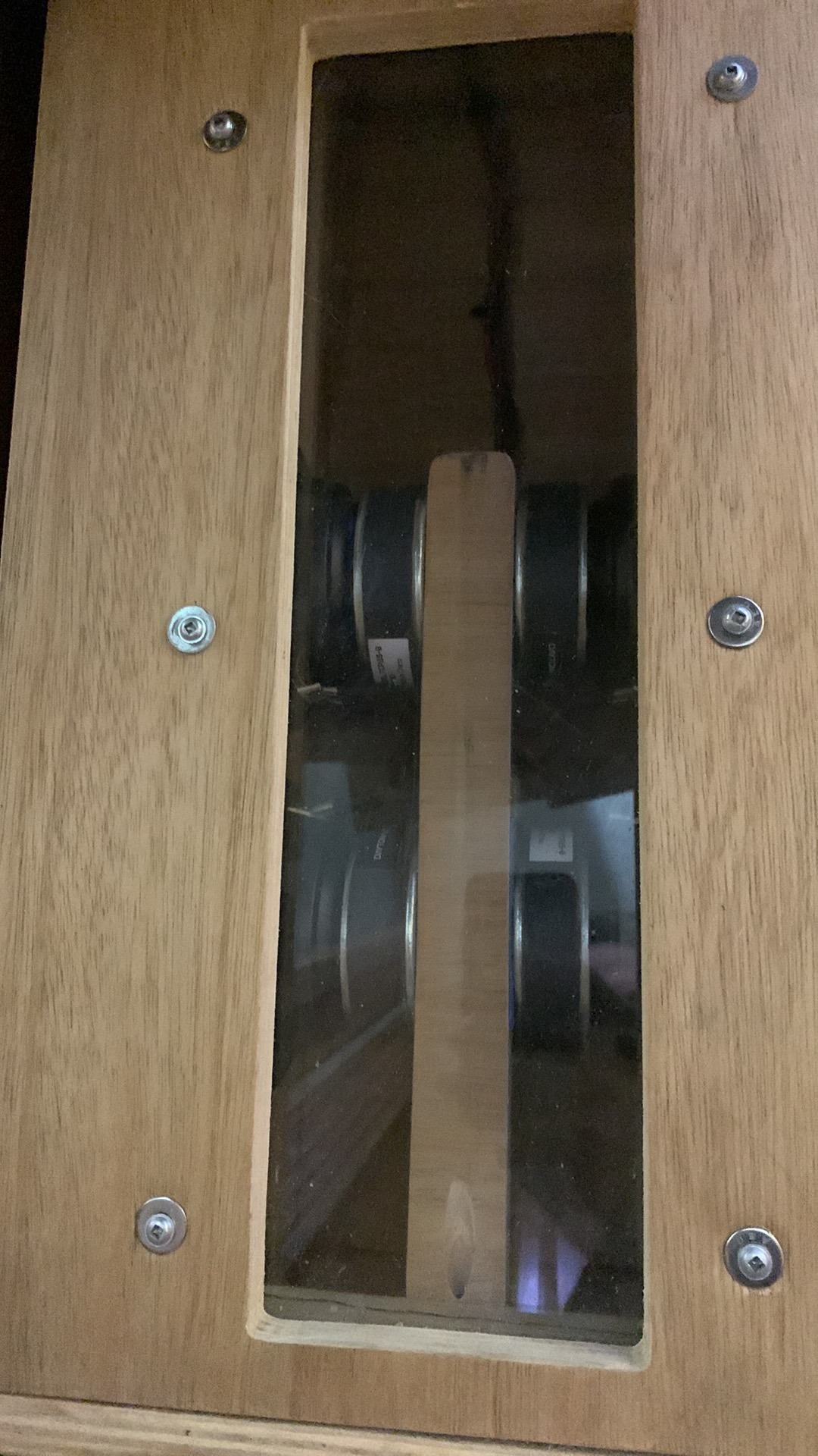

Down firing would have been best for WAF here. But having a slot or even at both end of the table doesn’t seem to offend her.

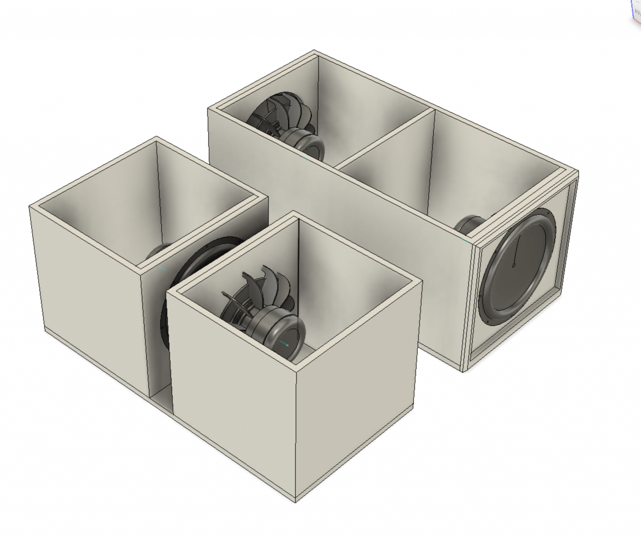

Wanted to naked a post with this, but I did this quickly this morning:
Would need to see if this slot type is appropriate for my use case.

Is this sim txt file the slot port shown (as a single)? (I’m always looking to try new things)

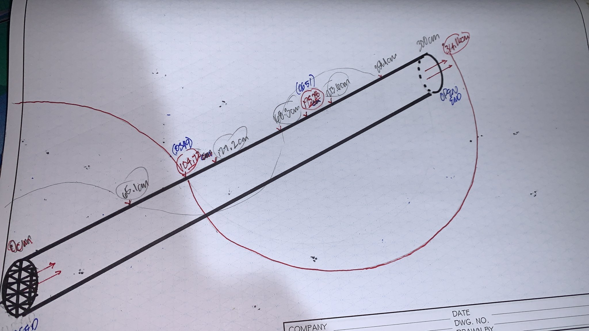

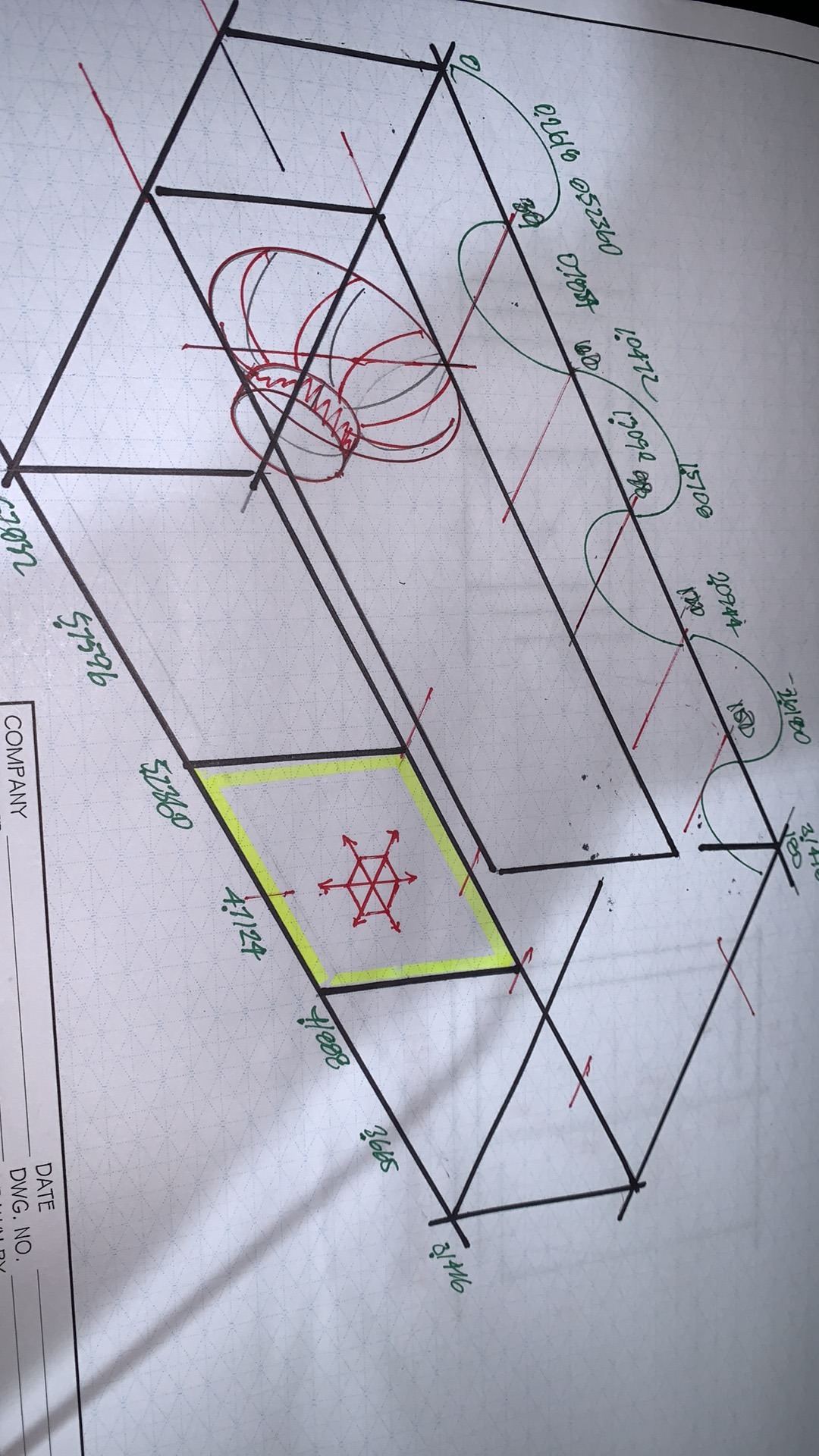

My mind fawk currently:

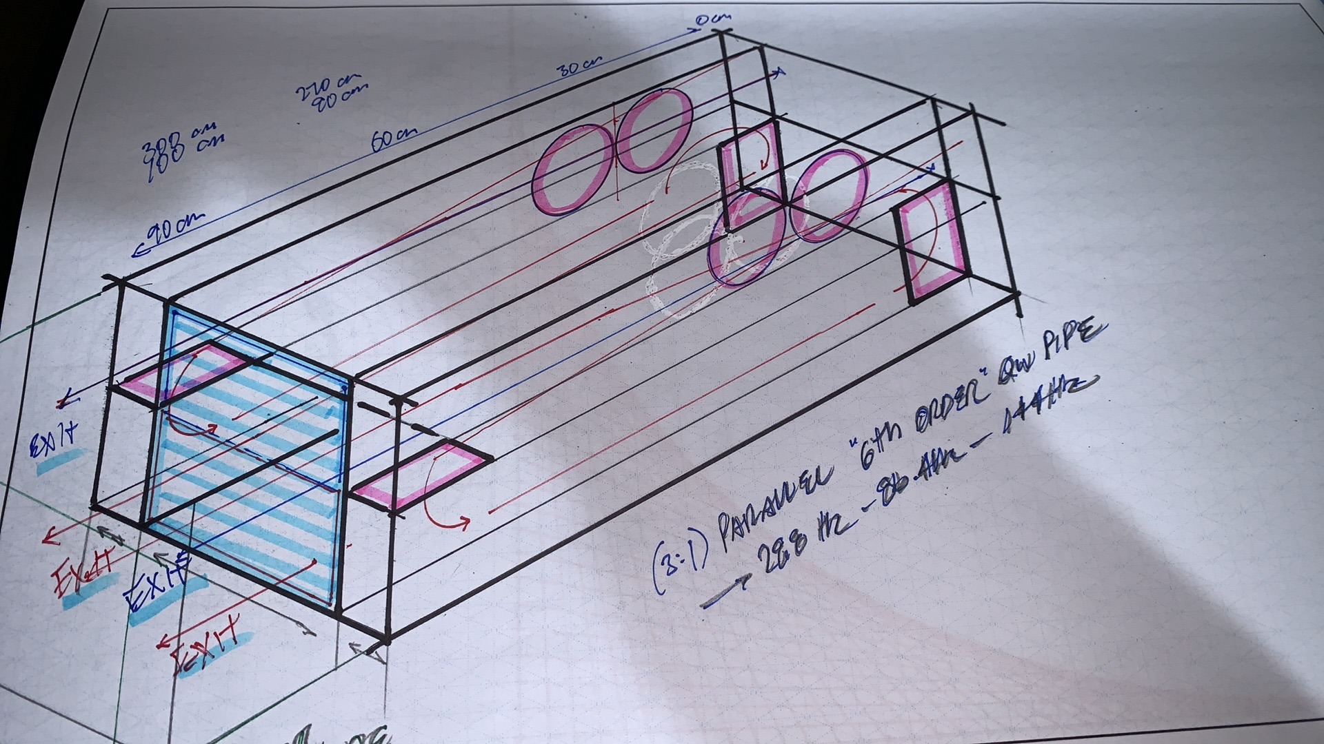

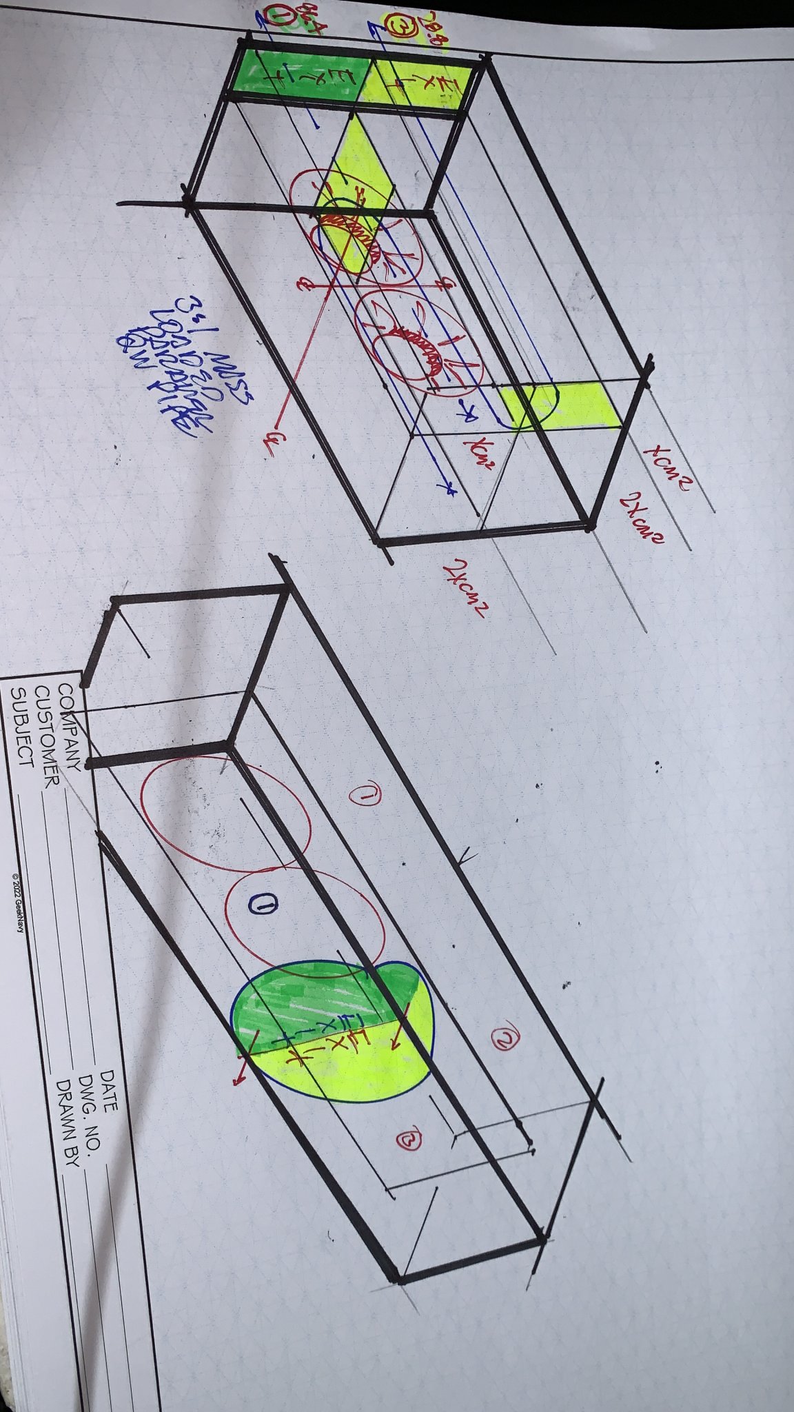

When is a sealed box ‘better‘ than a qw pipe box that only has one exit, as it has been folded up and designed around the three to one ratio of that (second) odd harmonic? A qw bp6 parallel 3:1, for example
as far as using it In the ‘room’ Full of ‘modes’ ?
For newbie like me, what a qw bp6 parallel 3:1 ?!
I guess it’s a quarter wave 6th order bandpass. But why would it be good versus sealed.
I do like special « design » like this (when I google to see picture).

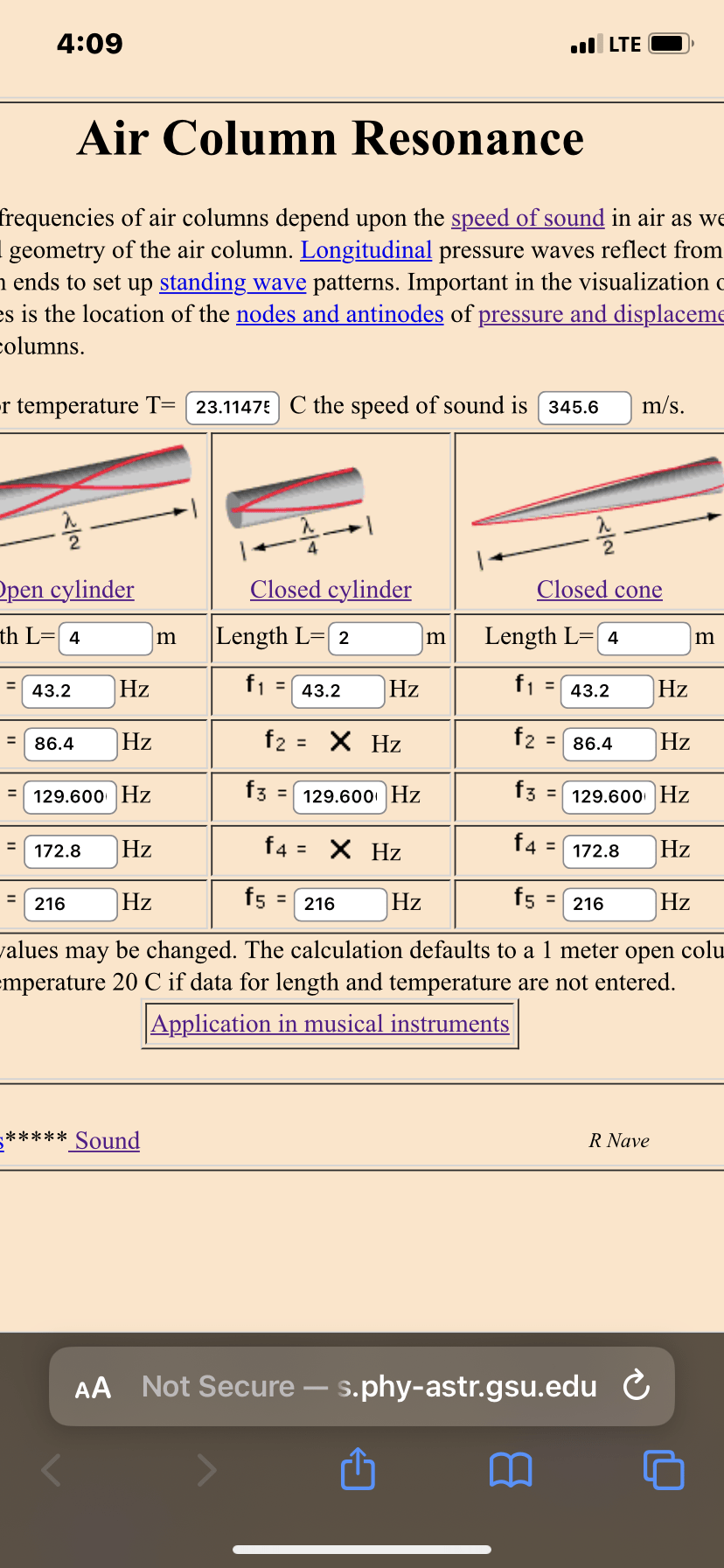

3:1 length and a split of cross sectional area at the ‘middle’ based on the harmonic interval in closed end pipes .
these all sim ‘perfect’ in HR generically. And have offsets driver entry points that maintain the ‘perfect’ as well
