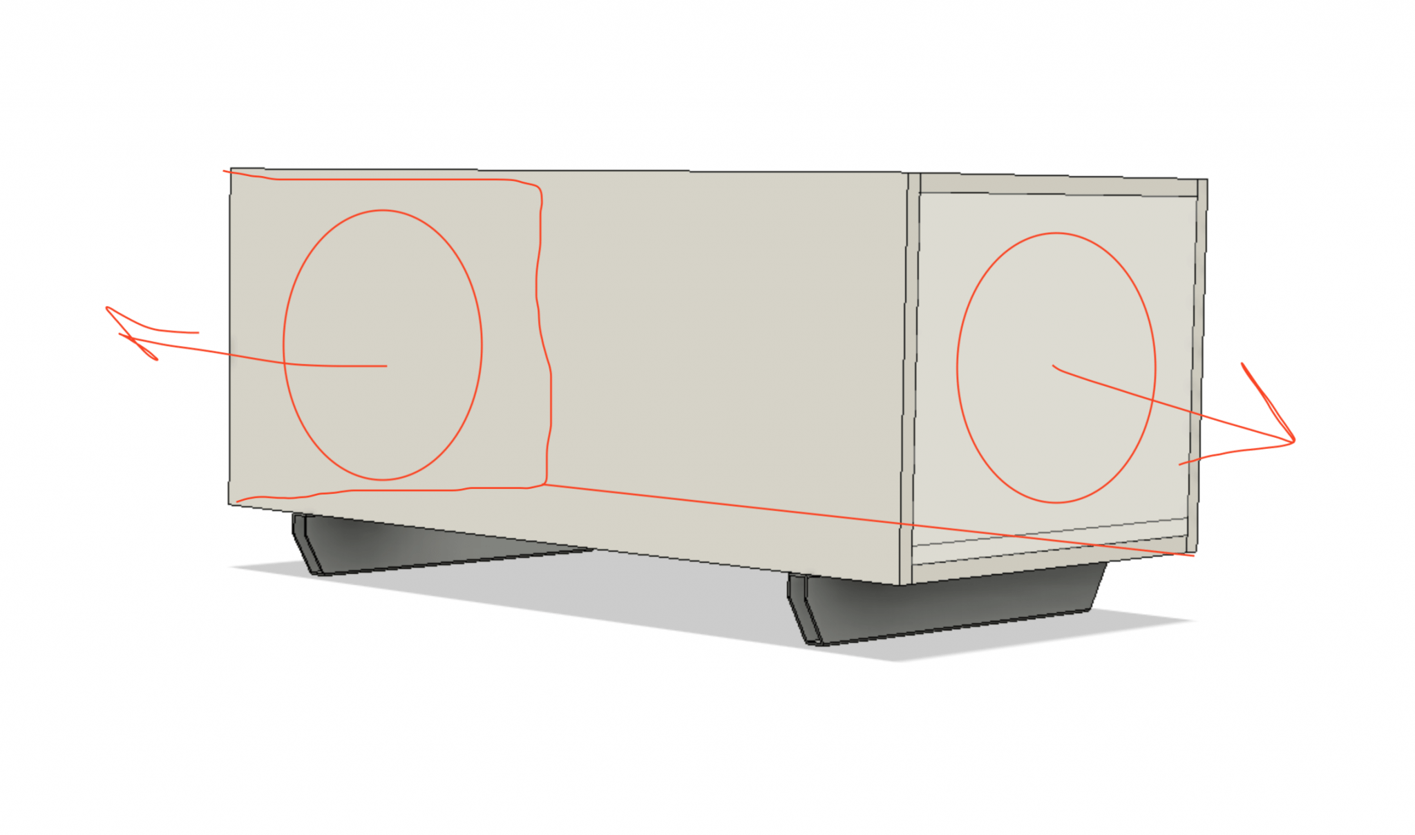

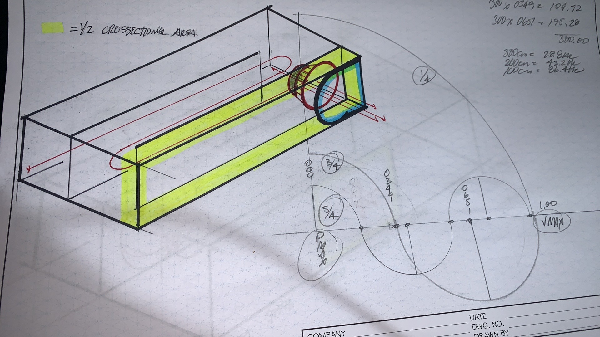

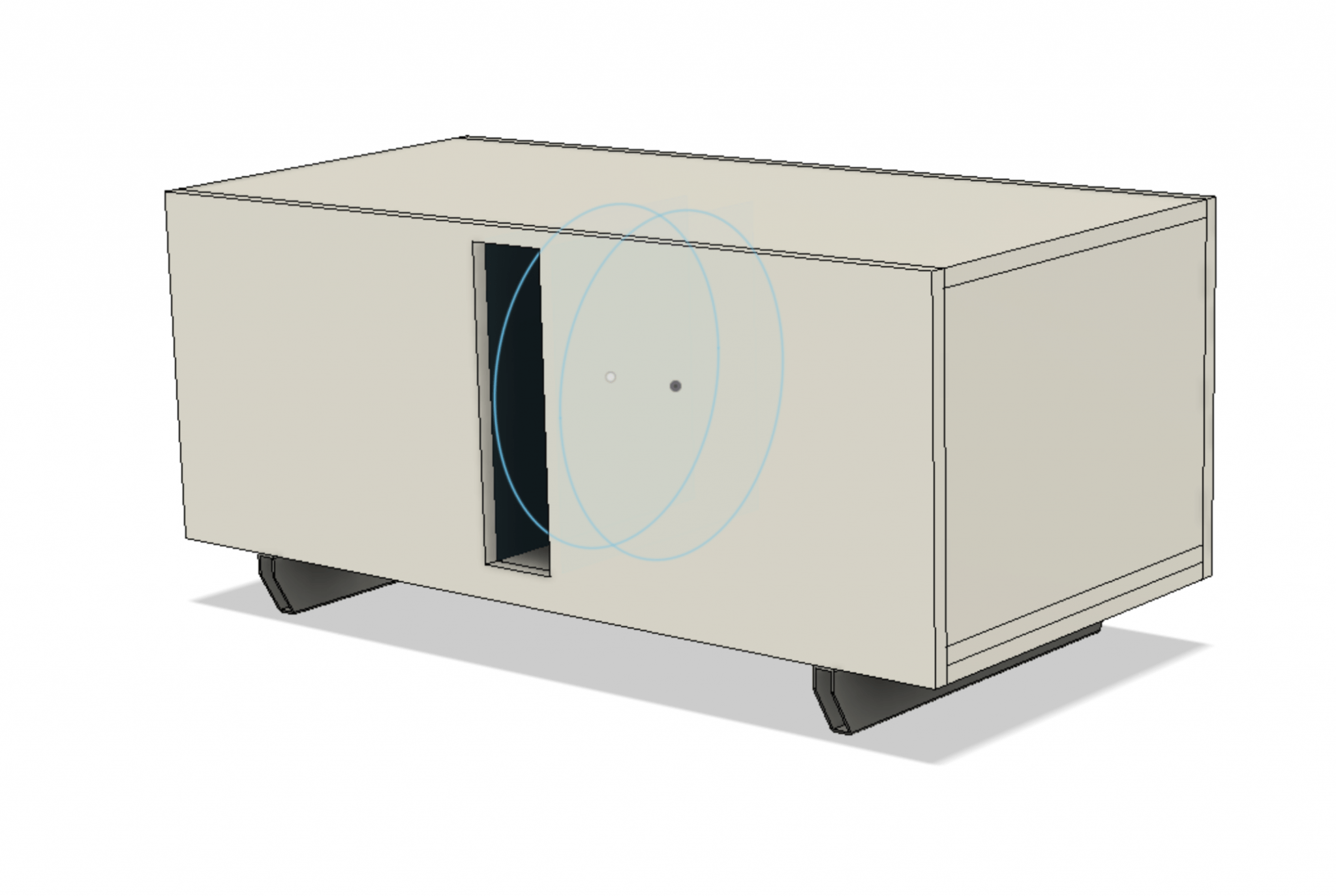

Gotcha, so by definition, they need to be opposed, both 'firing' at the same time, going in the own direction. (screenshot 1 and doodle one)
or could I Make something like screenshot 2 ? I guess its not sealed anymore. or like the back of the driver is sealed, but the front is 'throwing' into some kind of short port. (think its called 4 or 6th order IIRC)

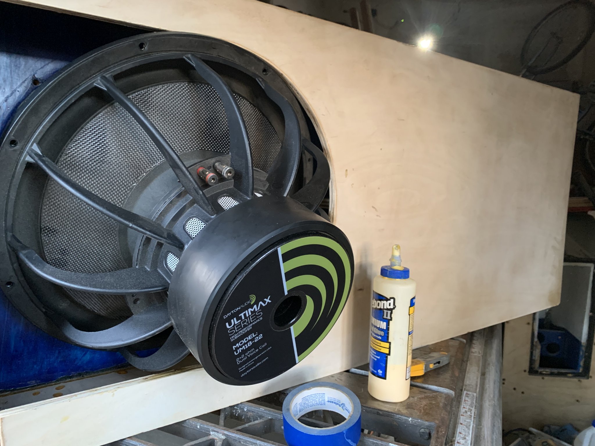

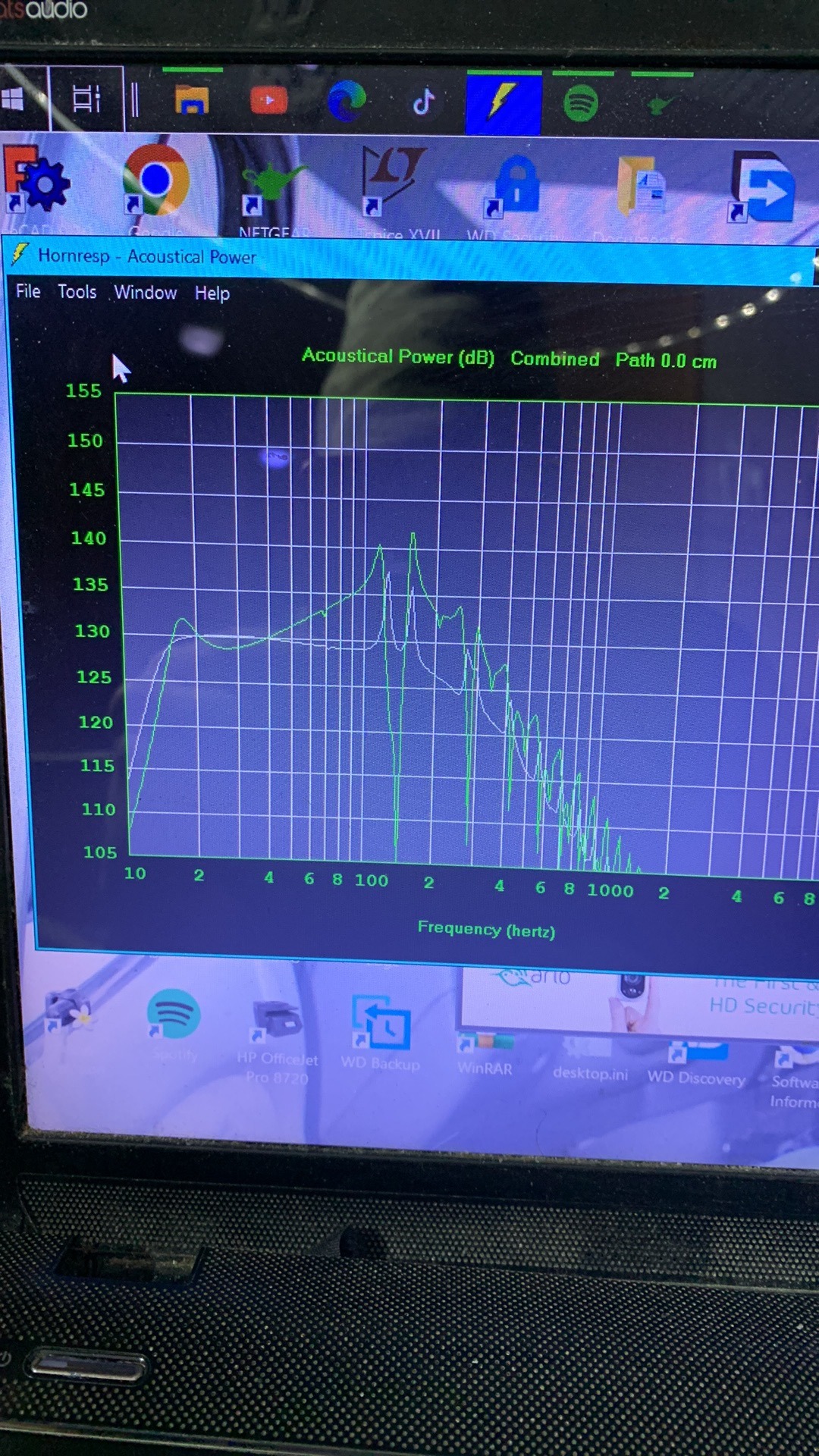

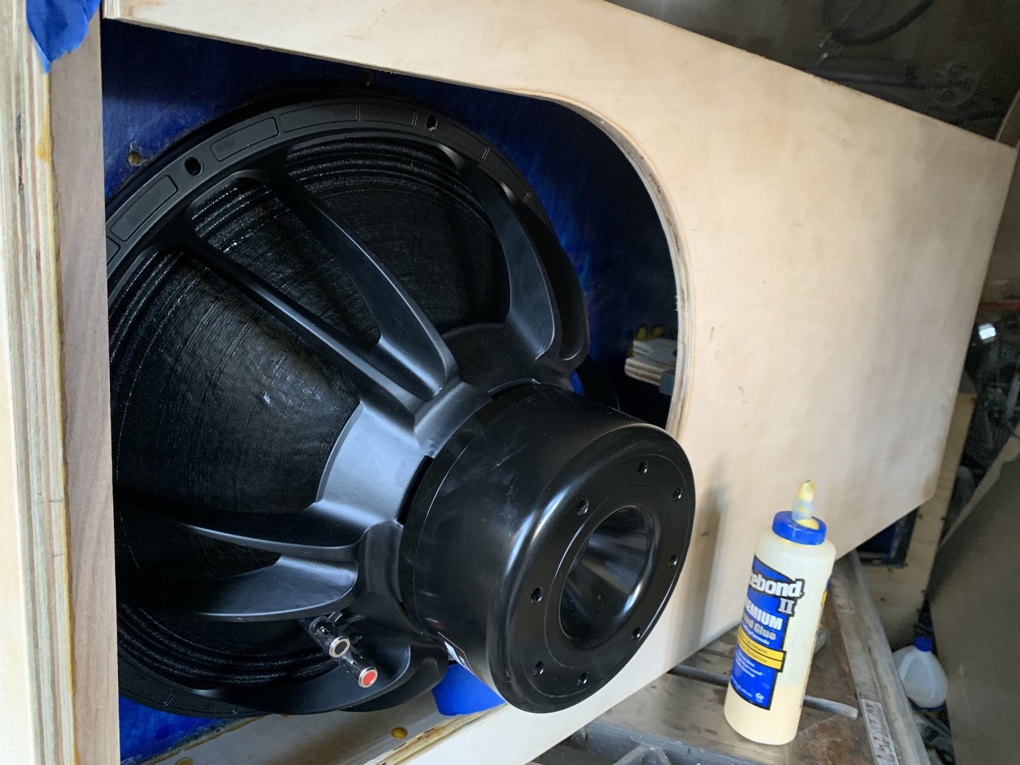

Fun!! But stupid in the house, seriously stupid! 😝 360 liters for the um18. 280 for the b&C .

I dunno about the B&C (18ds115)yet.. havent tried it in this(green graph). White is the dayton. When I grow up I will
likely put the um18’s in sealed boxes with dayton sa1000 plate amp and dsp as suggested.
You could, but don't see the point based on the needs of your app, though if you ever move to a dedicated room with plenty of room and/or corner loading options.........
Yes, I've already confirmed sufficient power.
Correct.
It's slot loaded, so 4th order with the vent acting as a low pass filter, but no experience using them out in the open like in your app, so if wanting to explore this option, might be best to post your Qs on one of its dedicated threads.

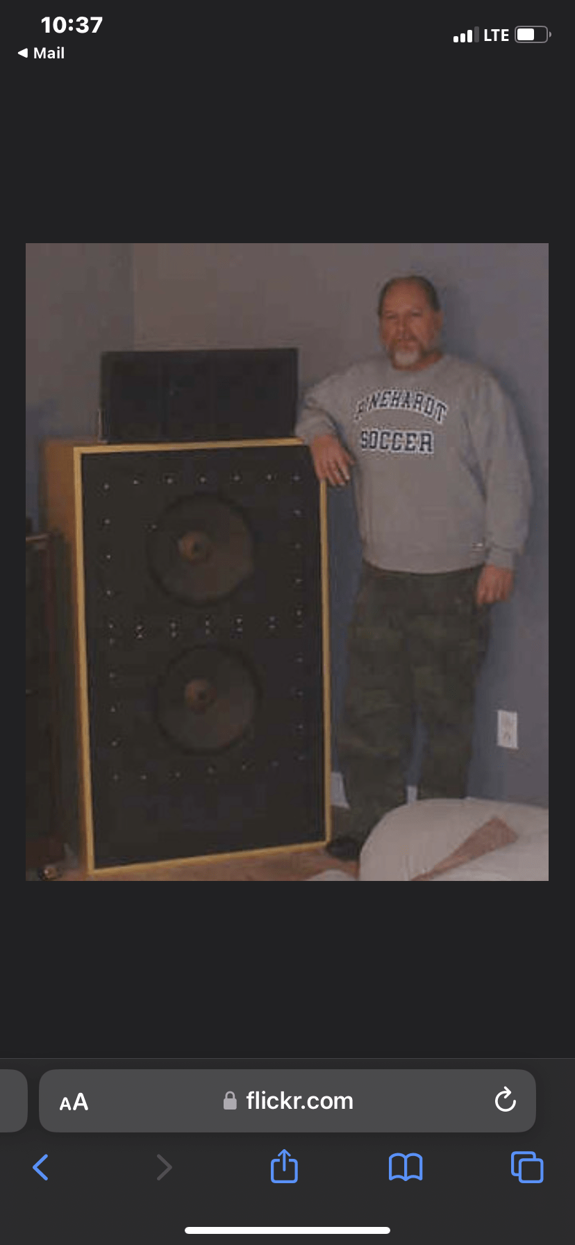

BTW/FWIW, here's one of my stereo pair of circa 1970 20 Hz Fs, ~20 ft^3/567 L dual 15" Altec 515B prosound wide range TQWT 'subs' mass loaded/vented/tuned to ~14 Hz, so nowadays referred to as a ML-TQWT w/500 Hz/2nd XO to a 500 Hz expo horn, though capable to XO as high as 1200 Hz/2nd.
They were originally tuned to 32 Hz, the lowest recordings available back then, so would be a big waste of time/$$ at 80-120 Hz XO (having 25 lb AlNiCo motors, each driver is significantly? more expensive than any you've mentioned once inflation adjusted), hence my observations/recommendations/reservations re using prosound in your app, though back then there really weren't any other (non prosound) woofer options that went anywhere near this low without using higher Fs woofers either bass horn loaded or IB loaded multiples.

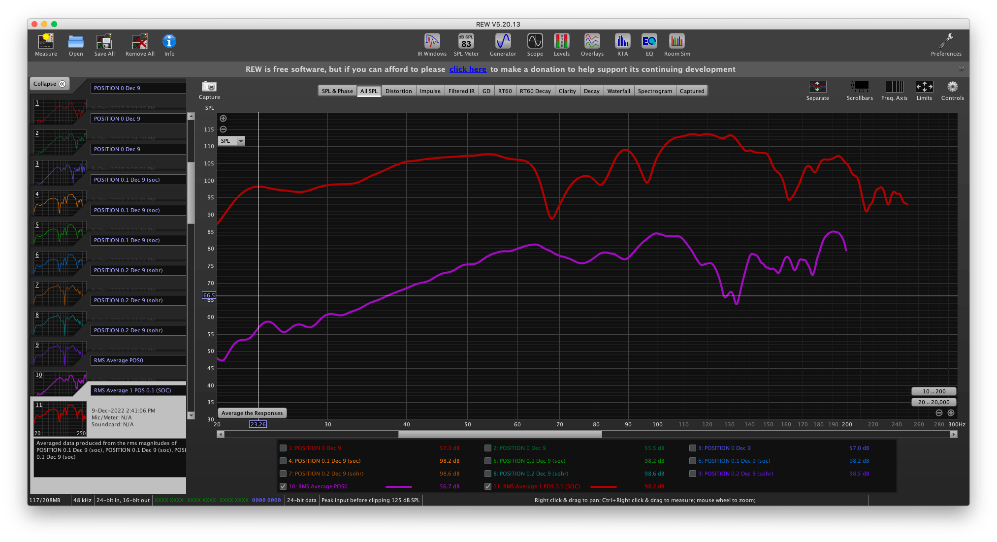

I just strated using rew in order to see if the subwoofer at the center of the room will have a nice response.
Started with subwoofer at the its usual location, and mic at the MLP (purple) and then switch the two, so subwoofer on the couch at the MLP and mic at the subwoofer location
got 2 very different reading.
I started a thread in the software forum to see what people think. But I think that i should keep the mic at the MLP and move the subwoofer around. I fear that if I put the subwoofer at the MLP, and the mic on the floor (rougly at the center of where the driver would be) the response wont be the same.

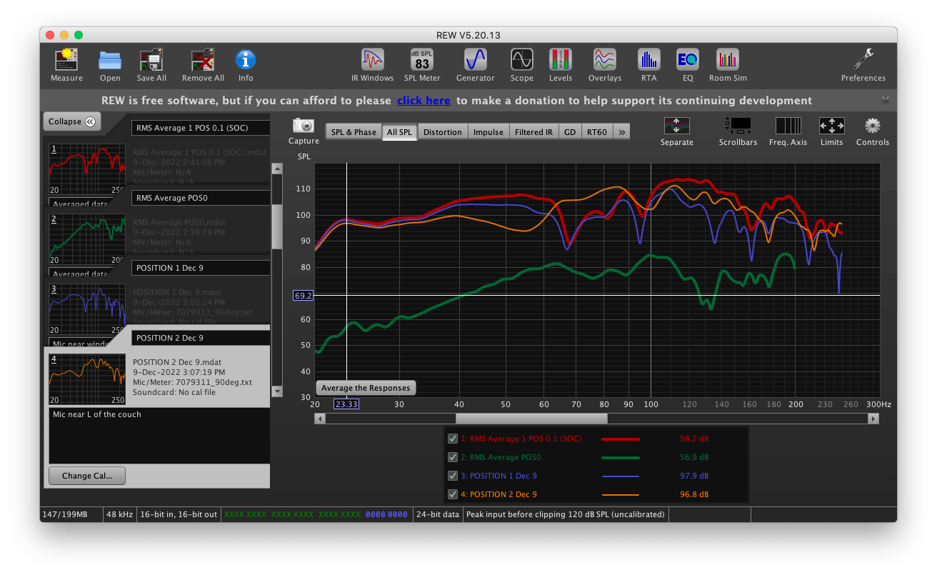

Here’s with 2 other reading, With subwoofer at mlp, and umik-1 where the middle of the 2 15’s would be.
Orange is « toward » the couch, and the blu-ish is closer to the wall on the left (when sitting on the couch looking at the tv)
Also, it’s crazy to see that I get roughly 100db when it was set at 75db using the generator.

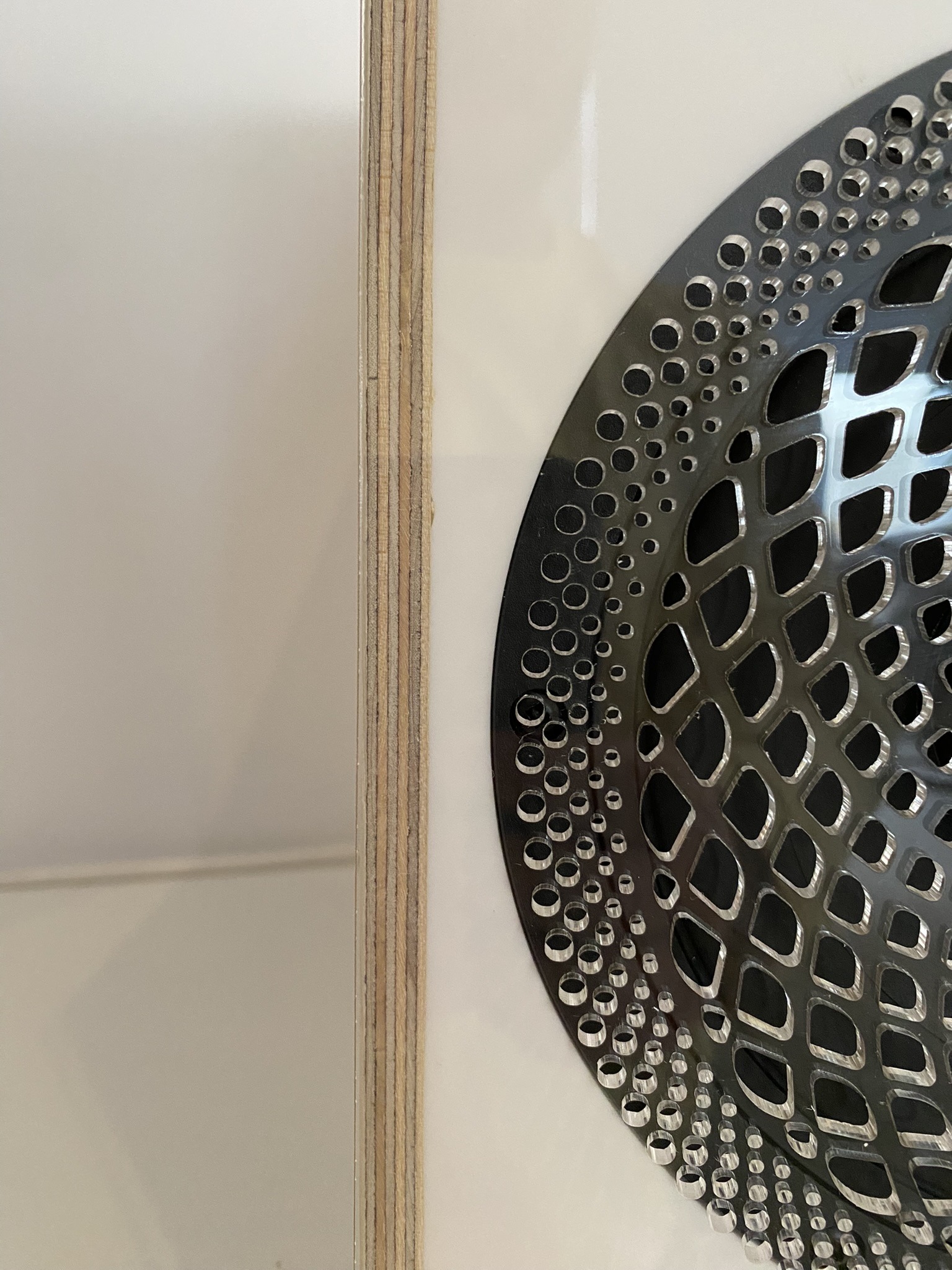

Also, in order to hide the driver from my 1yo little finger.
Would a « conventional » cloth grill would be okay? Do’s and don’t to know when it come to grill?
Could I make clear acrylic with a pattern in it like I did with my Criton?
