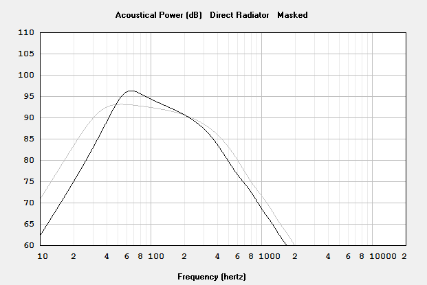

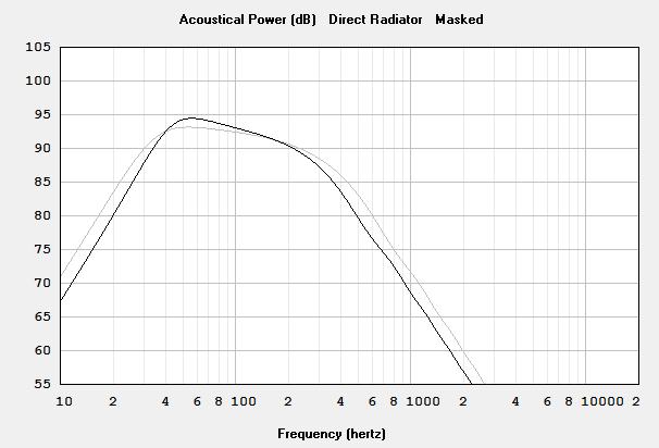

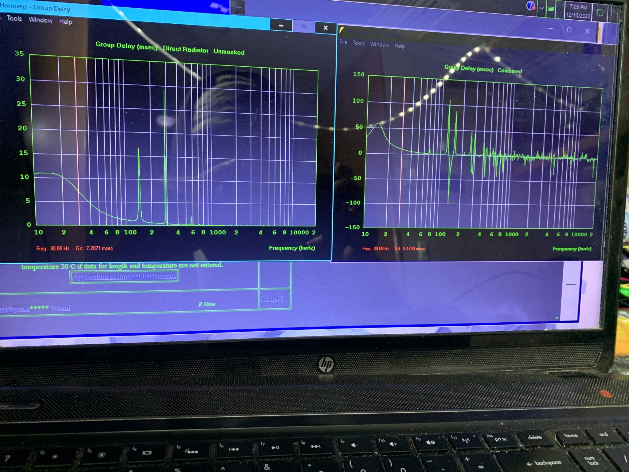

Not really since they will be EQ'd to a 'fare thee well'........... HR simmed 'FR' overlay of one in 5 ft^3 (light line), dual in 2.5 ft^3 net (less driver/s and only slightly different once bracing is deducted)
edit: Not really since they will be EQ'd to a 'fare thee well'........... HR simmed 'FR' overlay of one (light line), dual in 5 ft^3 (less driver/s and only slightly different once bracing is deducted)

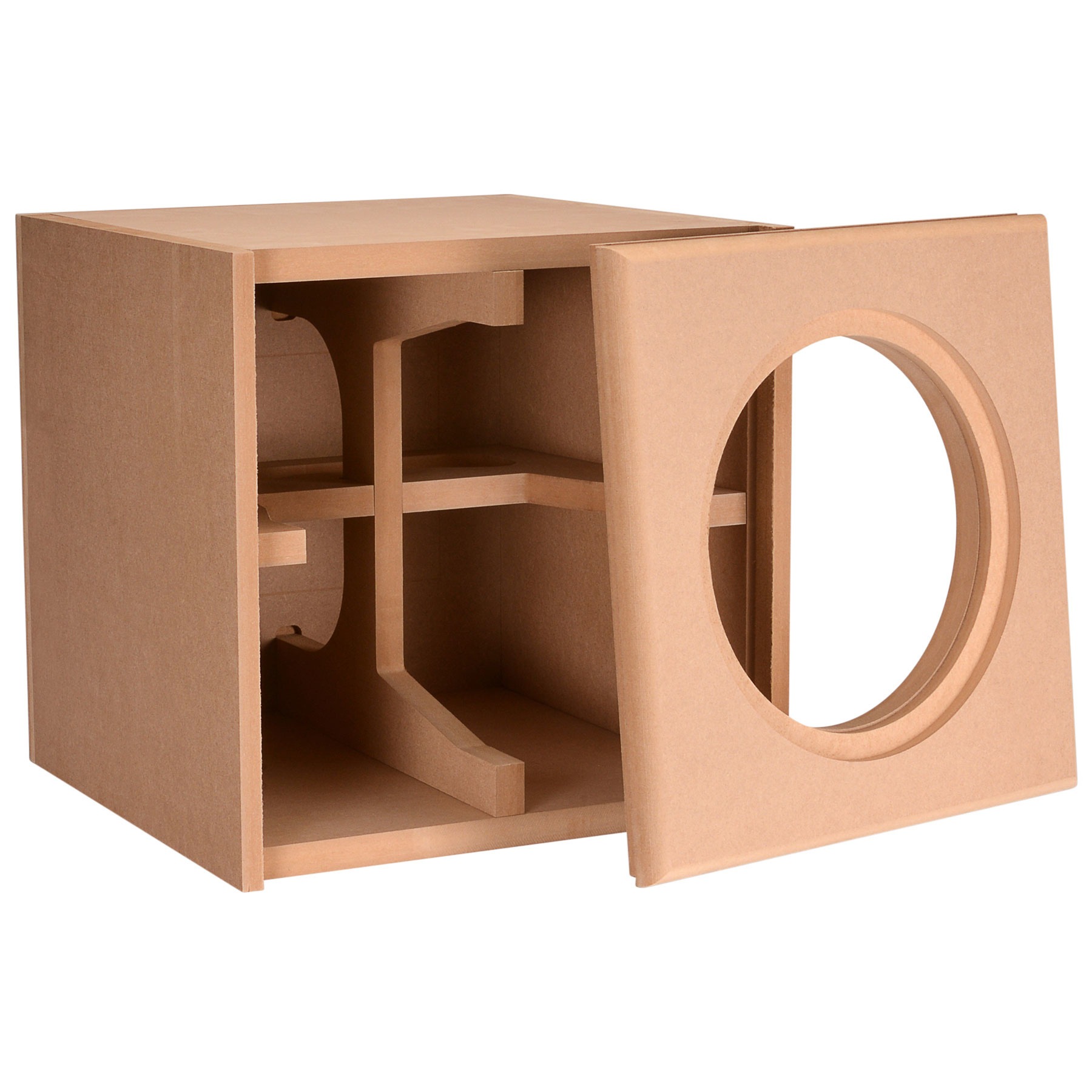

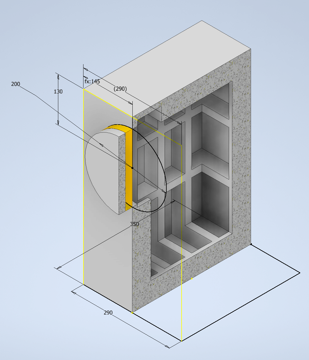

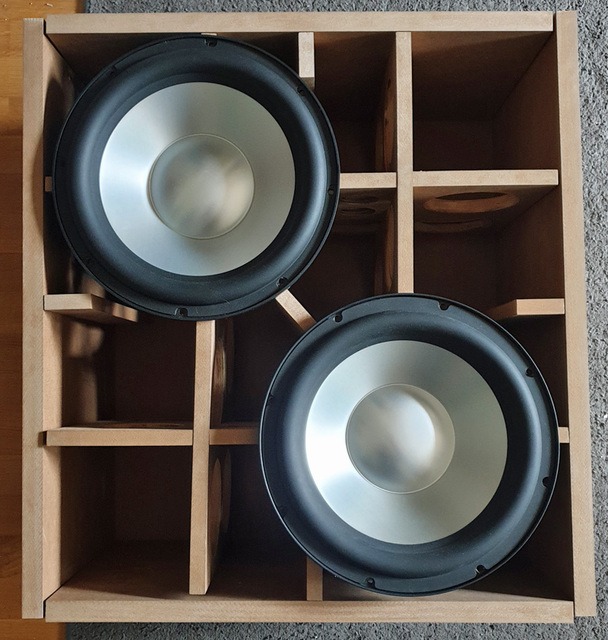

This is my "personal style" of doing it, which has been the result of some centurys of speaker building and independendly verified by DIYS publications.
There are other ways to do it, which will give compareable results, but add much more weight and cost to your build.
The best one I ever build was repurposing the concrete space of an under floor heater into a 180 liter subwoofer cabinet during a house renovation. I calculated it's weight to be about 1.2 metric ton's.
You get the picture?

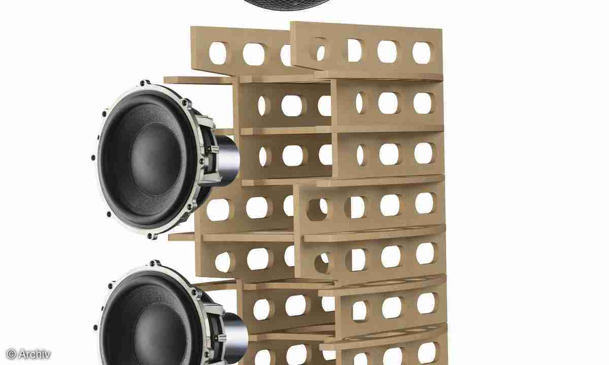

Staying conventional, you often see very confusing "bracing" inside DIYS speakers, maybe the result of try and error with the error not removed, once glued in place. Others are a bare minimum, as many builders look for simple, less time consuming plans. Of course, any builder knows best and any build is just perfect... near to a religious discussion. Basically it boils down to mass versus intelligence.
You sure know what a T-bar is? The same principle can be used inside loudspeaker cabinets.
This systematic approach is to take stripes of wood ("wood" = ply, MDF, OSB, particle board or any other processed material used), the same stength of the outer wall. It's height should be about 3 times it's strength, so for 3/4" something like 2-2.5". Then you choose a matrix size. If we stay with 3/4" ply, a distance of 4" should give very good results. Modify this measure a little to fit your cabinets inside.
When the outer 5 sides of the cabinet are joined, I start with the short 4" pieces at one wall and then add the long one, oriented 90° to them, then short row 4" and so on. The last row of small bits has to be matched for tollerances.
Sure cutting anything in advance is a nice idea, but you may not be able to include the glue gap and swelling of wood to all measures.
.0001% tollerance CNCing or laser cutting find limits with a living material like wood that may change it's size by .5% in a few days. Usual pannel saw tollerance is about +- .5mm, depending on gear and operators motivation. A huge advantage is modern poluretane wood glue, which uses moisture to harden and foams up a bit, filling small gaps. Not even expensive, if you check online for pro sources. Take the large bottle for your project!
Here are pictures, one that shows the bare minimum and some over the top matrix, last what has best results. If you want, add some connection between opposing walls when practical.

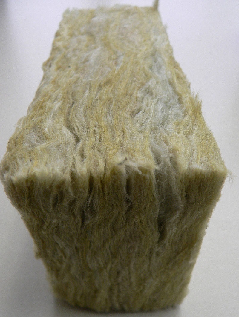

I disagree about using Rockwool, as it takes away volume being a solid compressed brick. It is good for absorbing like a black hole, but not better for open cell damping.

Sorry, the "Rock Wool" you mention seems to be another quality than that what I and the loudspeaker industry use.
Inside the sub woofer the speed of sound is slowed down in this loosely packed material, which results in a measurable lower resonance frequency of the closed box. Damping is a side effect in this use.
You do not stuff it inside with force, but fill it very gently compressed. This has been done for ages and the effect is not a matter of discussion.
"Glass wool", even as mentioned quite often, is not suited for this task and confused with "Rock wool", which stands for a mineral wool made from basalt or dolomite.
If you want to damp out resonances in vented cabinets, you will not use rock wool, as it may disperse it's fibers into the room. Even as these are non toxic, we are concerned about any foreign matter in our living space.
Here the usual material of choice is acrylic wool, as you will find it in a pillow. Indeed there is a cheap IKEA pillow, which is very often used for this task. Of course any cheap material designated to DIYS suddenly gets extremely expensive... so IKEA saves you quite some money filling your speaker.
There are many other products of this kind, promoted to improve the sound of speakers. In most cases very cheap if used in buildings, renovating, insolating,and huge amounts. Then offered as special quality, from a "speaker shop", costing ten or twenty fold. Don't get fooled, there is hardly any product made soley for speakers, just matching industry products rebaged.
Like bitumen, which is dead cheap as roofing felt.

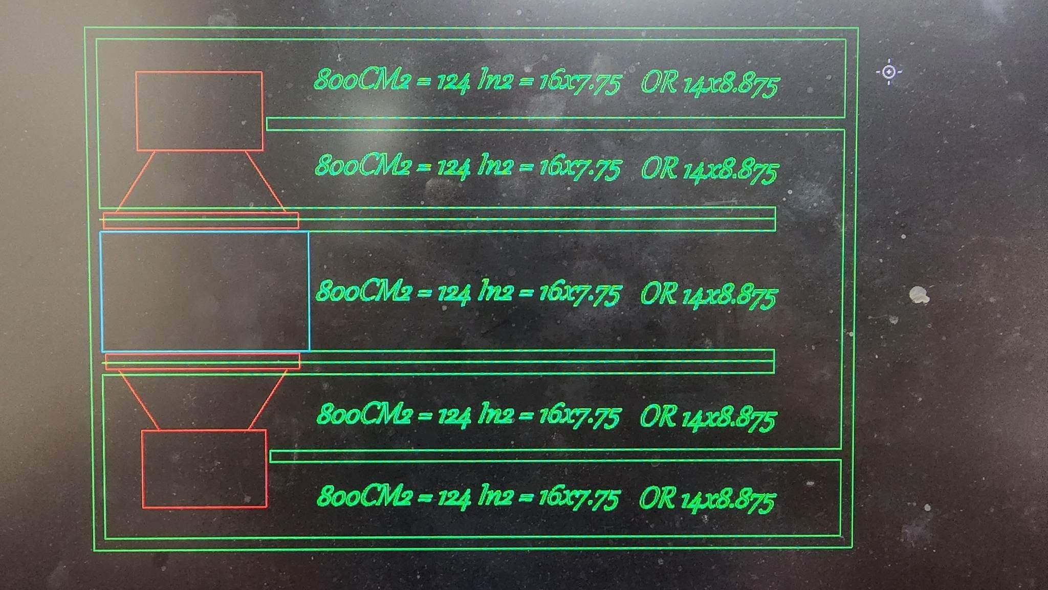

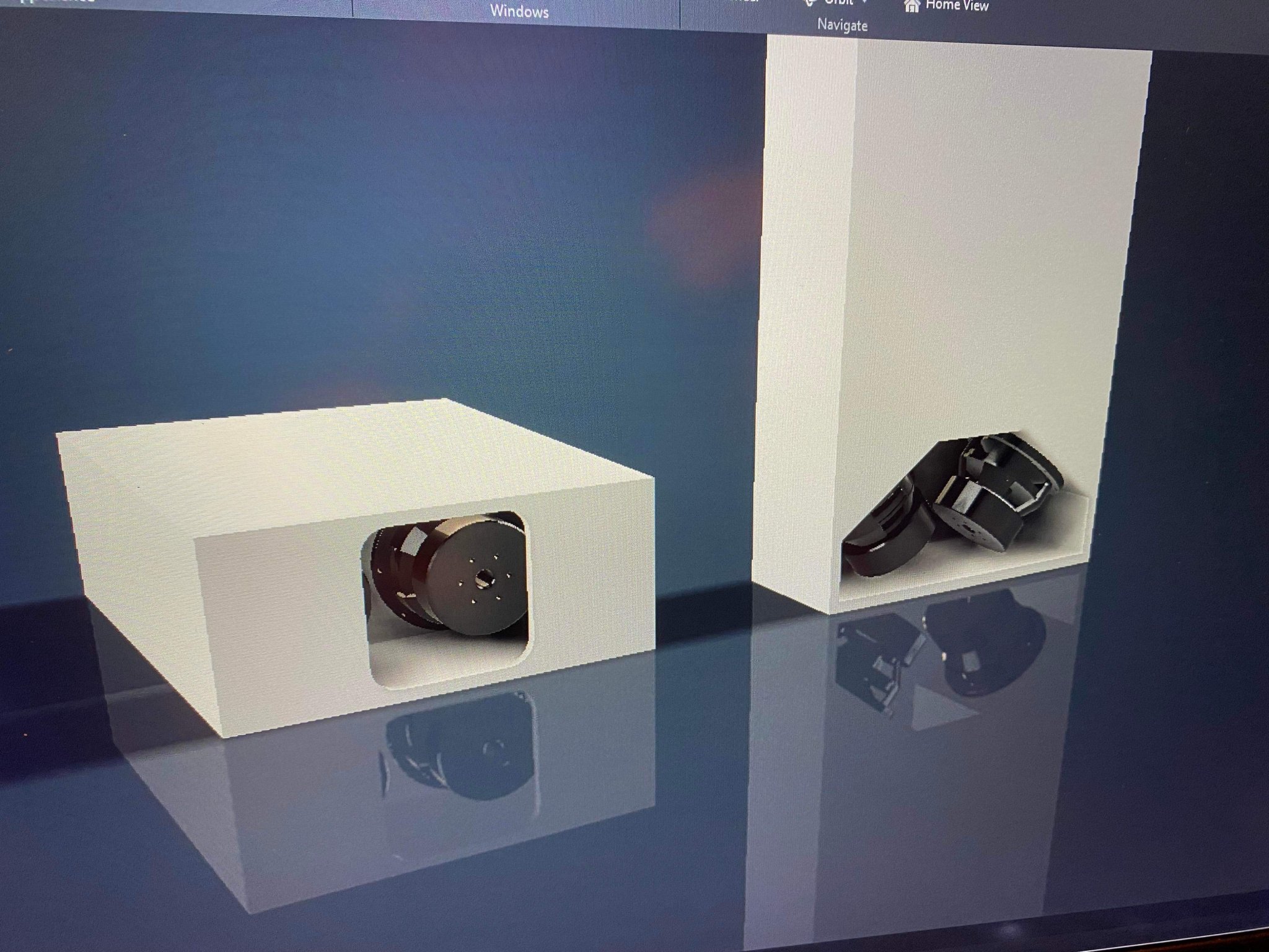

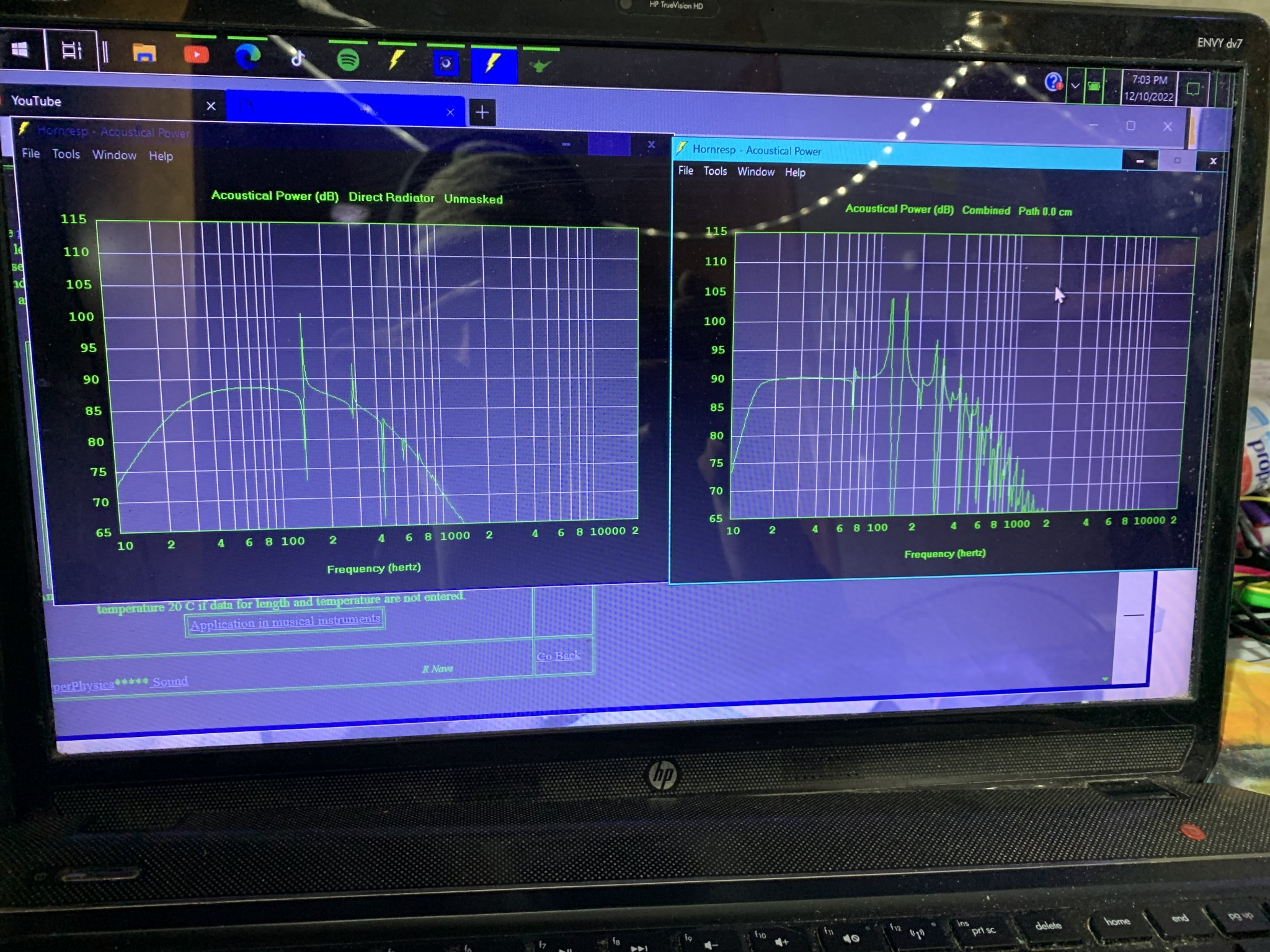

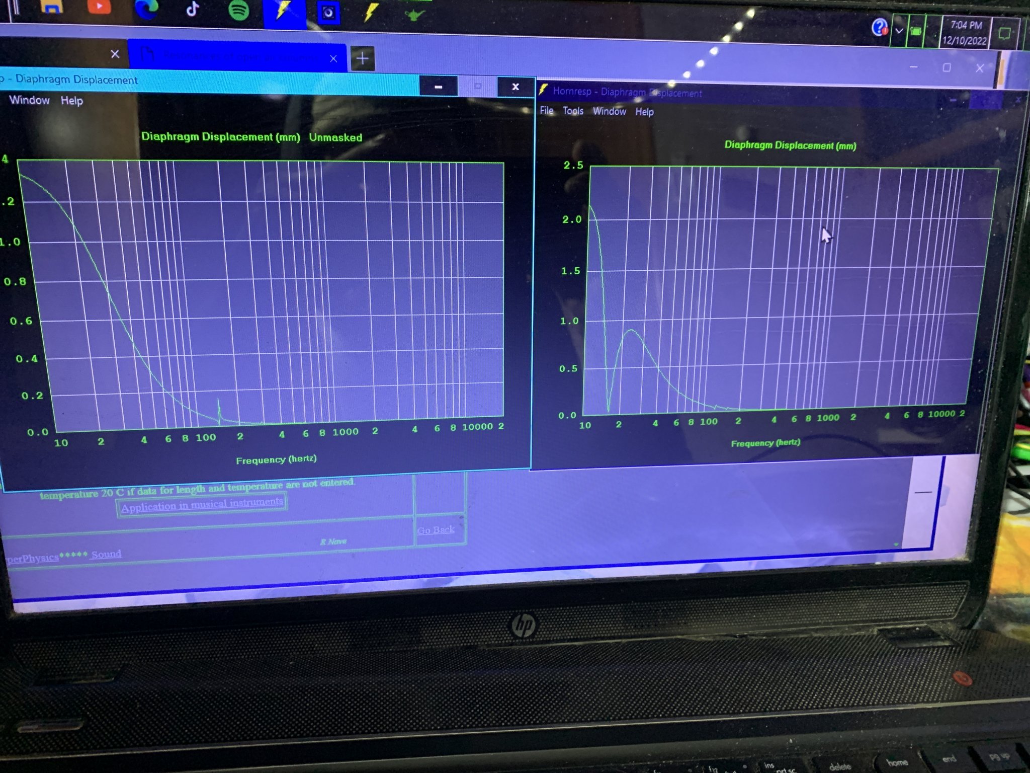

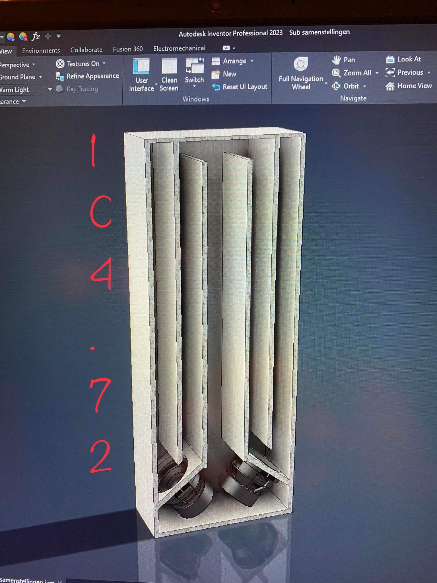

Ignore the numbers in the green rendering on a plasma cam software …. The umax drivers thrive in 3:1 reduction MLTL. the offset entry just eases the construction in this case (and I xo point is freed up) and vent location for a simple subwoofer essentially and allows plenty of room for critically dampening, the driver and vent issues of the higher QTS ‘Spikes’ maybe?

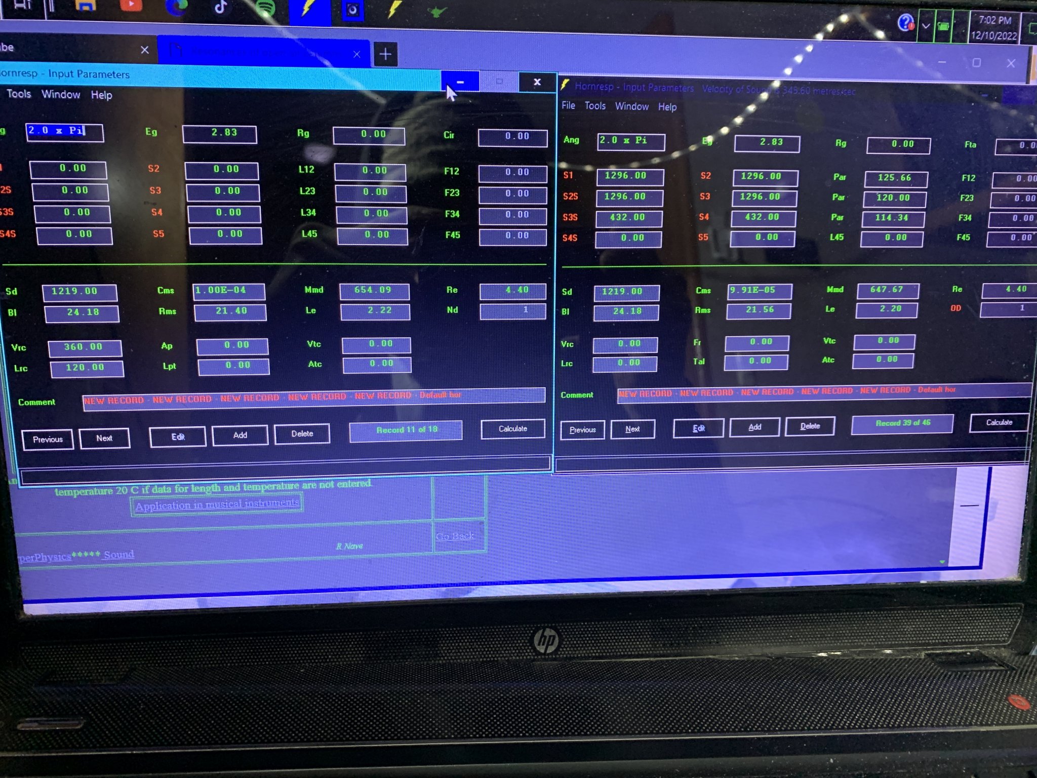

What should I look for in the graph you linked? I’m scared I don’t see it.
Is horn resp better than winisd?
What’s eq’ed to a “far thee well” ?
“Fare thee well” noun. a state of perfection. The meal was done to a fare-thee-well. The maximum effect; fullest measure or extent, which in your case is the mass quantities of EQ required to change the two different box alignment speaker responses to ~flat in room, so nothing to be scared of per se, just shows how much under-damped they are that before digital EQ/DSP would perform much like a mobile audio's boombox in your HT.
The pro version of WinISD was ~ on par with the corresponding early version of HR, but no clue about more recent versions of WinISD and for sure doesn't have any of HR's many special features that allows a novice to design advanced cab alignments with its 'fill in the blanks' box/TL/horn alignment wizards.
That is sexy designs. Love “unusual design” like this.
What’s a 3:1 reduction mltl?
What’s I xo point is freed up?
In shorts im not sur I understand all you said, English is not my first language and this hobby as a lot of technical terms.
Oh gotcha! Thanks you. Will definitely have a look at horn resp one day.
