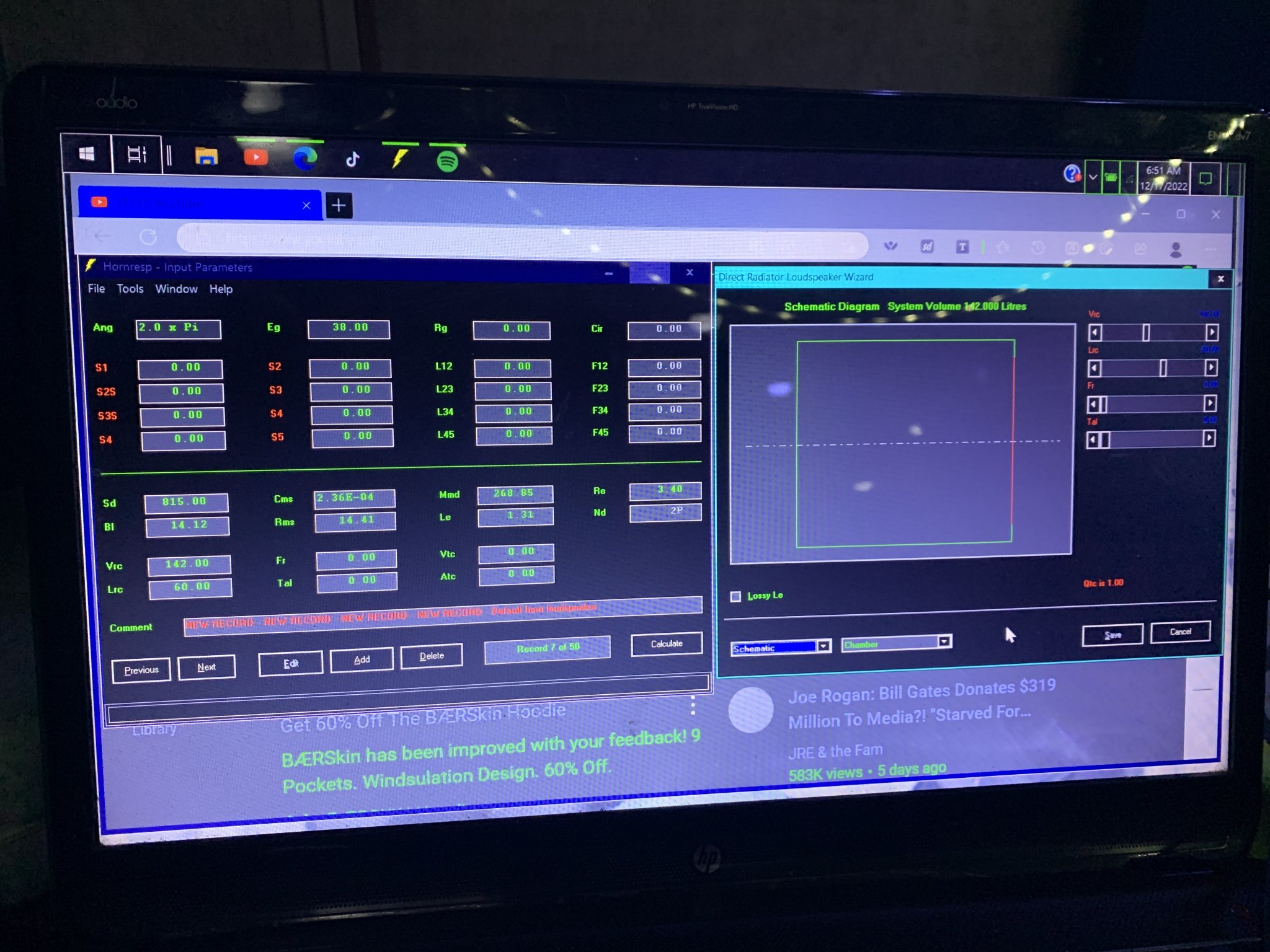

FWIW I came up with a ~141.58 L net Vb/dual series 15UM-22, so a calc'd ~0.96 Qtc (1.0 Qtc HR) based on published specs with max power limited to ~430 W/115 dB_m/25 Hz/2 pi.

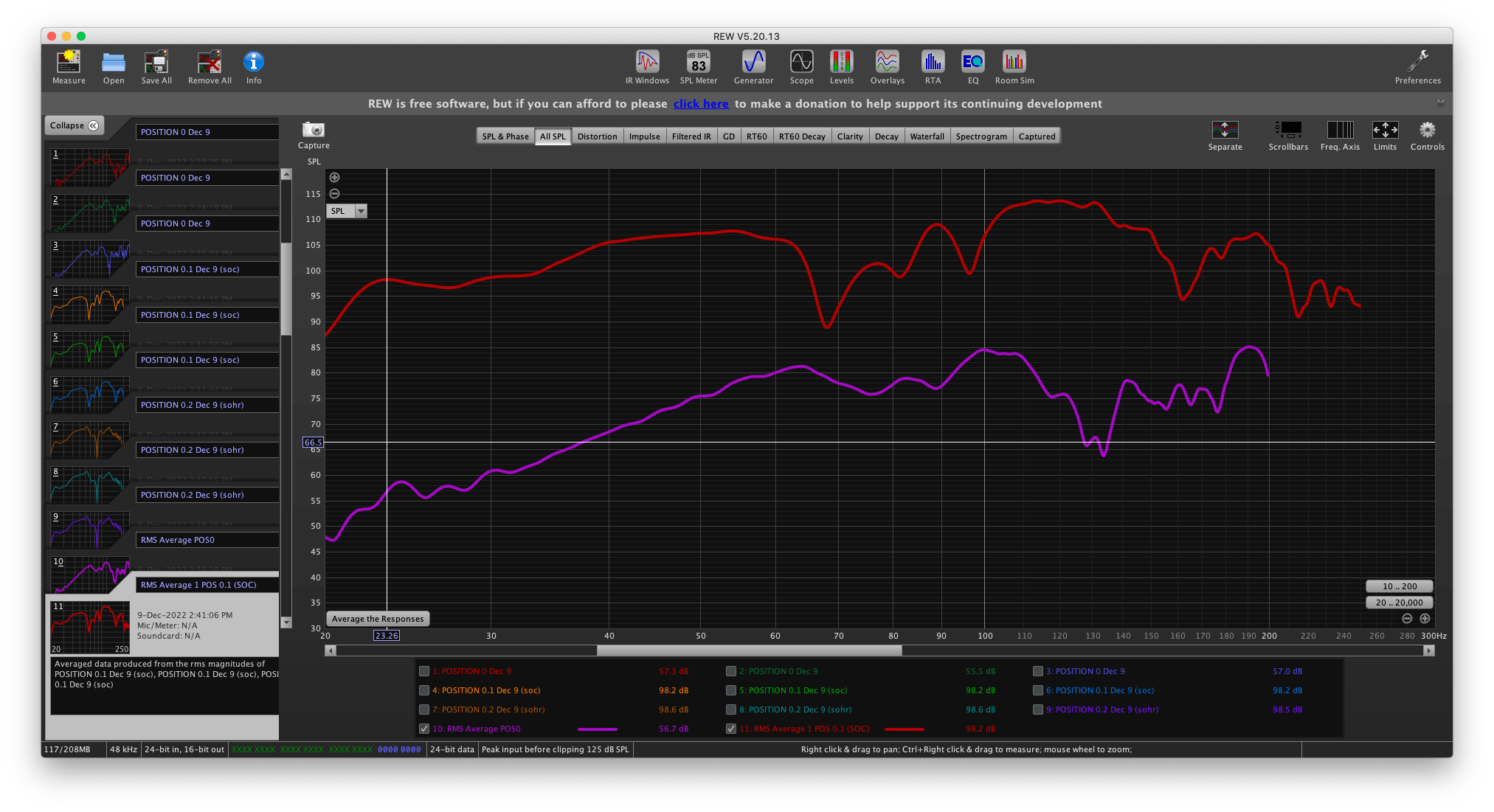

With my current single « cheap » 10in I get 95db at 23hz.
Cant Imagine what 2 um15 or mx15 would do.
Just build that 155 liter 2x15" monster. You will blow the glass out of your windows with it and rattle any object not securely screwed down. Your room will add a ton low frequency gain. Your current baby sub is just not able to activate these frequency at all, as it has a low cut to protect it.

Not sure to understand all this.FWIW I came up with a ~141.58 L net Vb/dual series 15UM-22, so a calc'd ~0.96 Qtc (1.0 Qtc HR) based on published specs with max power limited to ~430 W/115 dB_m/25 Hz/2 pi.
0.96 qtc isn’t that optimal isn’t it?
And what’s 430w/115db.
_m/25hz/2 pi?
Does it mean 430w should provide 115 @ 25hz. But the 2pi?
