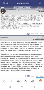

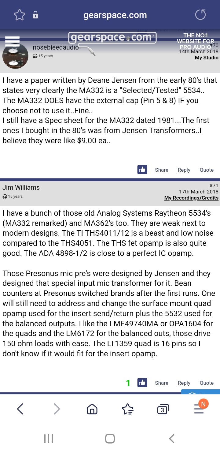

You made me curious.If it's THE Jim Williams telling his opinions...That was not my experience. Some years ago I put together a jig to test CMR vs freq and the NJM's CM performance was deeper at low freqs but not flat vs freq like the Signetics and Raytheons 5534's were. Analog Systems sold an MA-332 which was a Raytheon 5534 selected for, among other things, linear and deep CMR. The LM4562 and OP1642 are both very good in this respect, and quite consistent across different production runs.
https://gearspace.com/board/geekzone/558450-best-drop-upgrade-ne5534ap-opamp-2.html

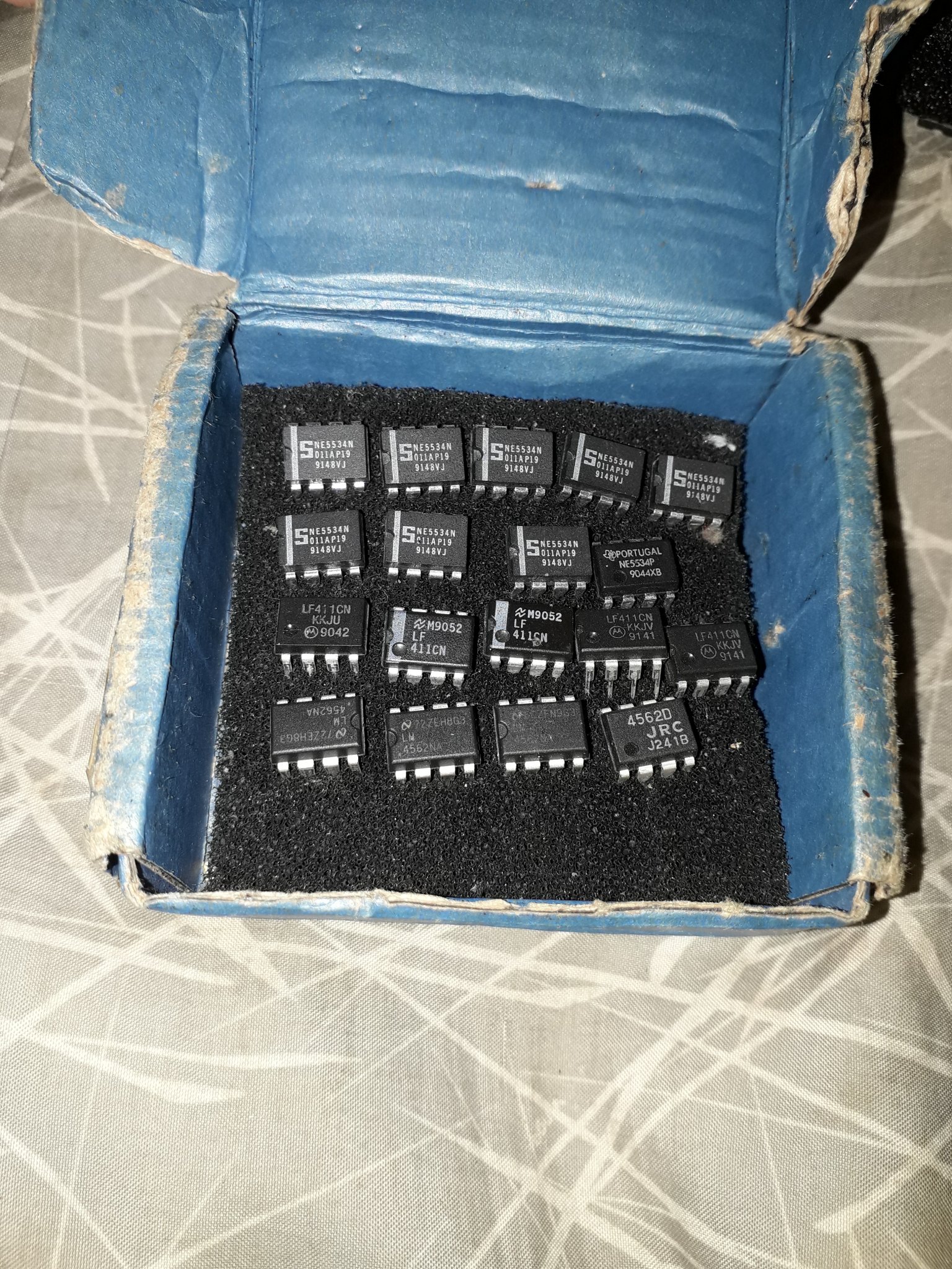

Believe it or not , a few years back I gave up a pair of electrostatic headphones and a highly integrated 4700 $ 32 bit ess Dac + 32 bit adc + xmos asyncronous usb + electrostatics amplifier for just a little bit more op amps than what you see here and I actually don't regret it! Well I bought a 350 pounds Audient id22 to compensate for the digital loss
My real concern though about these ne5534 is why even a circuit with a minimum of 75 x gain based on ne5534 needs serious capacitive compensation (3 capacitors) in a microphone/line preamp when the datasheet says you need one capacitor for gains lower than 3x?

FYI there are two Jim Williams; the analog circuit designer who died in 2011, and the pro audio circuit guy writing in the link.You made me curious.If it's THE Jim Williams telling his opinions...
The info re: Raytheon 5534's and MA-332 is consistent with what I knew. I don't agree with Jim's negative assessment of them, though. In the mic pre's I designed and built at the time, the MA-332 was a clear improvement over the Sig 5534. JW also didn't like the OPA627 which I found to be excellent. Still do, actually.

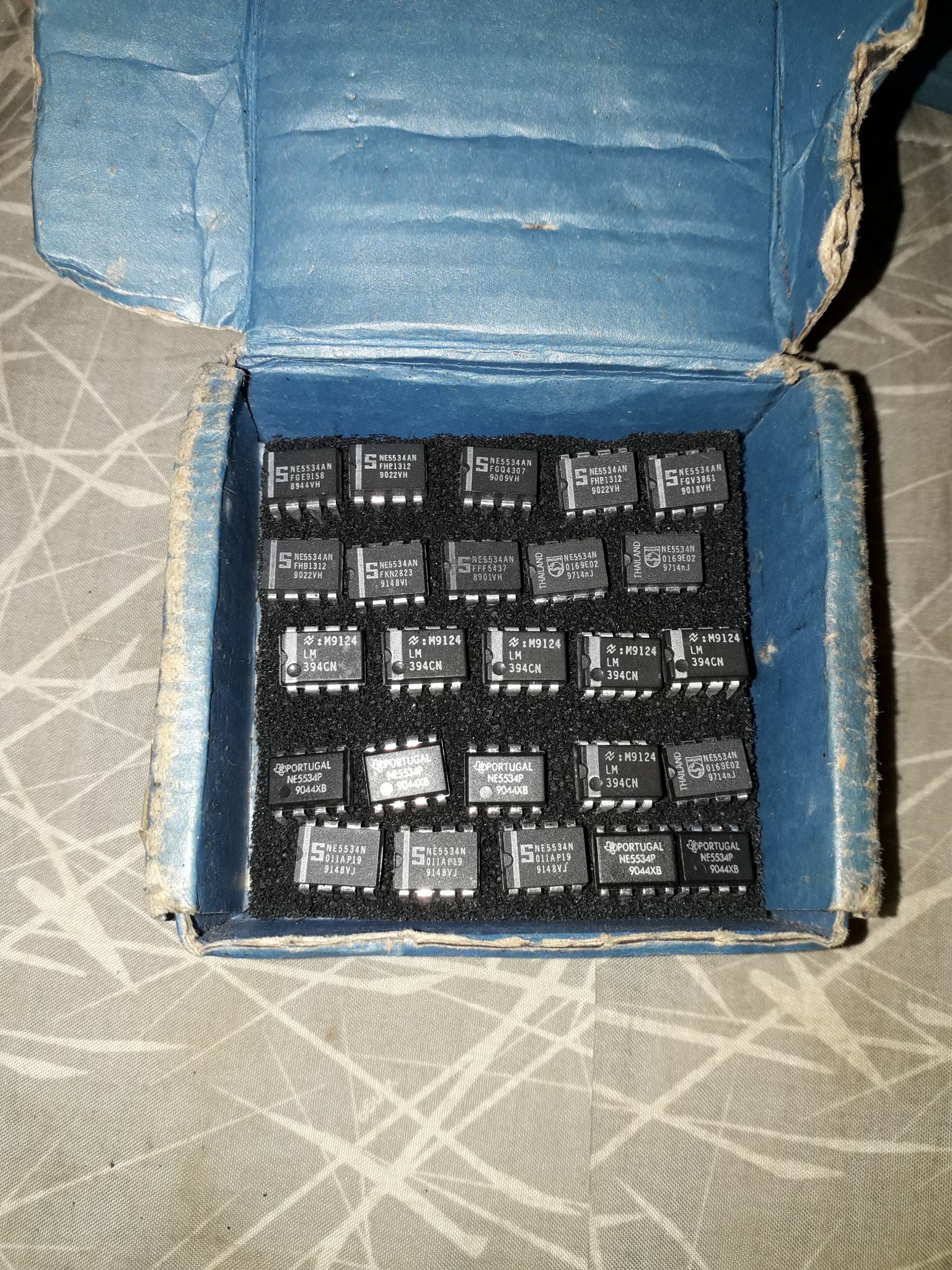

LM394s ... 😍Believe it or not , a few years back I gave up a pair of electrostatic headphones and a highly integrated 4700 $ 32 bit ess Dac + 32 bit adc + xmos asyncronous usb + electrostatics amplifier for just a little bit more op amps than what you see here and I actually don't regret it! Well I bought a 350 pounds Audient id22 to compensate for the digital loss
So I'm rich 😁
https://m.donberg.fr/descript/l/lm_394.htm

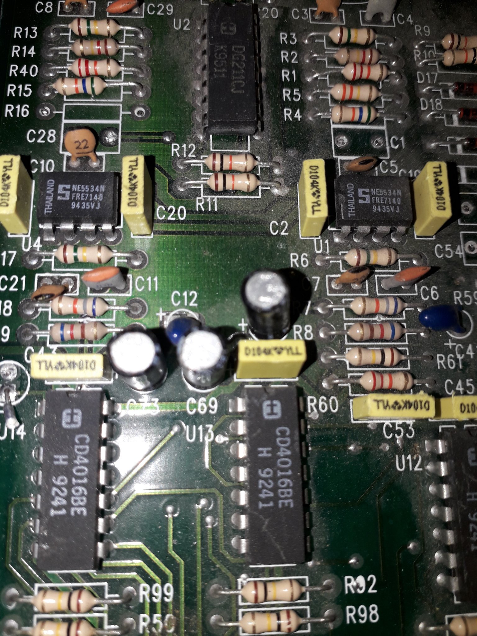

- NE5534N best quality replacement?
