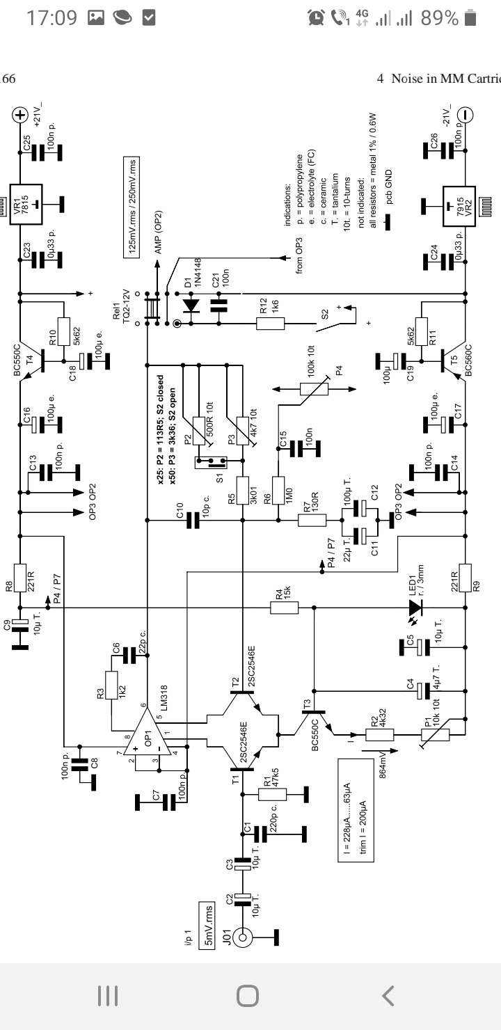

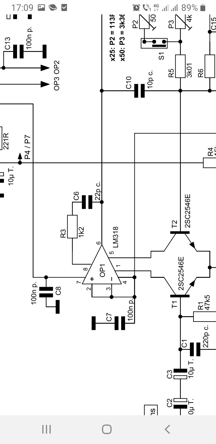

IC401 AND IC402 have two 30 ohms series resistors on the supply rails for the first stage.If you manage to increase those resistors accordingly so that the op amp idle current can drop the supply voltage such as the output of the first stage of the phono preamp doesn't enter clipping you might have a chance to hear how a modern op amp behaves on dusty records
That's if you get there in the first place cause you need to deal with their slew rates first:

Same thing...v supply max =+-18v.if the preamp is not supplied lower you risk using op amps at their max specified voltage...
Most well known op amps specified for phono stages can be supplied up to at least +-25v .Ne5532, opa1642 can do +-22v .None of those phono specd op amps are available today.
