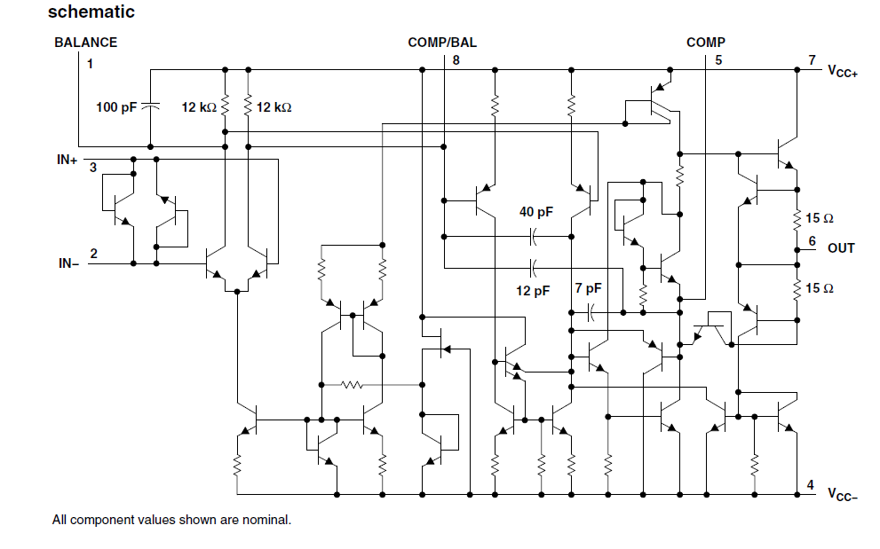

I guess you meant 5534 and 5532 are quite different? I would be very interested to know what the differences are.
The 5534 is internaly compensated for gain above 3 and has
pins for external compensation capacitor as well as for balancing
the input differential tails current.
Since the 5532 use the same 8 pins package for a dual op amp
the compensation is only internal and is set to be unity gain stable.
Otherwise these are the same circuits.

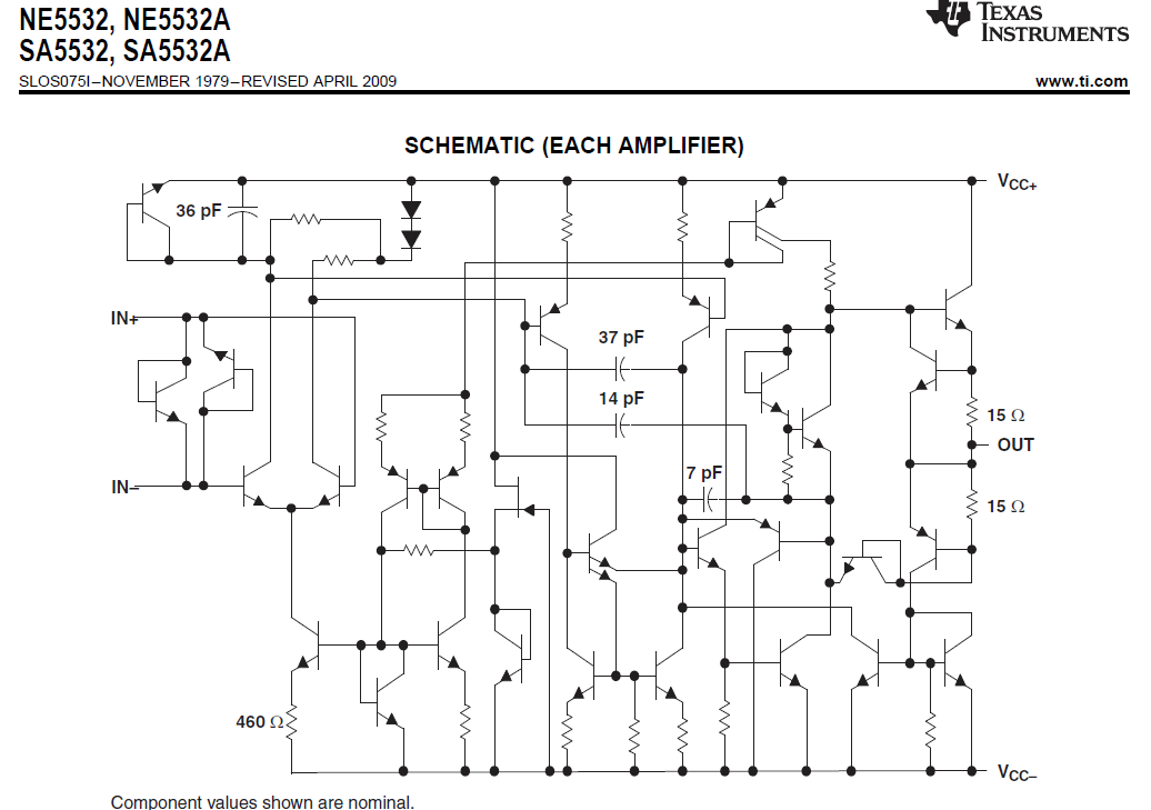

Some pretty obvious differences on the input. Including ability to adjust output offset on the ne5534.
conceptual schematic extracts from the datasheets below:
Typ slew rate of the NE5534 is higher at 13V/uS compared to Ne5532 at 9V/uS too.

From spice models I found a half 5532 is same as a 5534 with a 20pf compensation cap.The 5534 is internaly compensated for gain above 3 and has

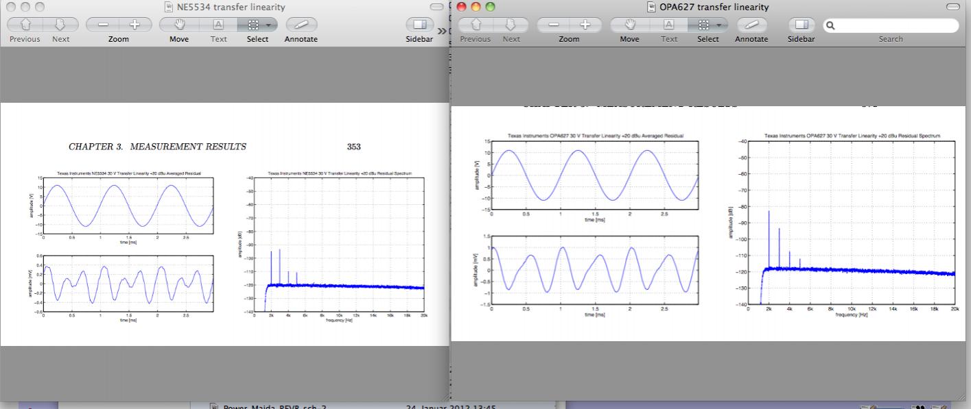

When you use the NE5534 inverted it looks like this, compared to the 40x more expensive OPA627. Neve used the NE5534 in it´s boards not simply in a parallel feedback arrangement. There is more to it to use this excellent and cheep part for advantage.

I have noticed on simulations that in inverter mode the 5532/5534
has way better linearity than any other op amp , to the point that i did
conclude that it was due to some inaccurate spice model....
Now when we think about it , the 5534 is the op amp of choice
for I/V converters and it happens that it is used in inverted mode.
Indeed , Texas instrument say explicitly that it must be used
at the output of their PCM1794 DAC to extract the best perfs.
