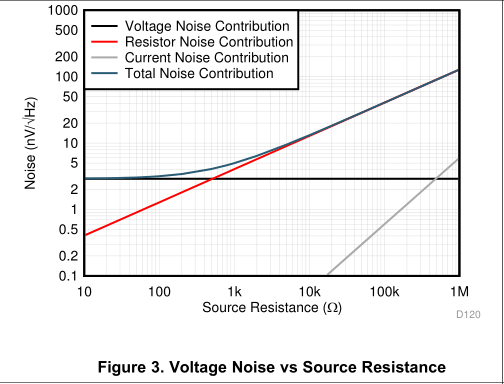

Thanks for the recomendations 🙂 , actually, I was wondering, i dont recall seeing Noise Vs Zsource in opamps datasheets. In this case, building Elliot's State Variable crossover (project 148), feeded from a DAC with Zout =250Ohm, would that mean a bjt would prob be less noisy? (at least some Jfet datasheets show a high increase in noise at low Rgen).
At the same time, in the article of the aforementioned article, he states: "NE5532 opamps can drive low impedances easily with no increase in distortion, but very low values may cause premature overload. High values cause increased noise, and anything above 10k isn't recommended." . I guess drive refers to the Zload? in this case i'll be arround that value entering to a power amp... Would a jfet opamp help in that respect?
EDIT: just in the next tab JRC njm5532 shows NoisevsZgen and the lower the better, and also now opax134, and same thing. They seem to make the same noise at such Zgen, if i mentally converted that unknown bizarre nv/sqrt(Hz) unit well.
There isn't one for OPA1642 but here's one for a similar noise level part with FET inputs, OPA1656 :
A bipolar opamp has a curve which rises above the resistor noise at higher impedance due to current noise.

LT1028 has impeccably low voltage noise but very much higher current noise than NE5534. I'd want to check the resistances in the feedback loop (and biassing) weren't compromising the noise performance - LT1028's own voltage noise is roughly equal to that from a 50ohm resistor but if the surrounding components offer a resistance above 400ohm then LT1028 may not be the optimum choice.
