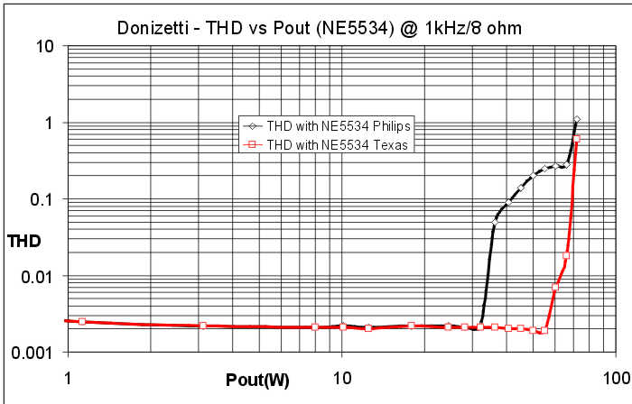

Have a look at this graph:
http://www.analogue-repair.it/Immagini/Doner7.jpg

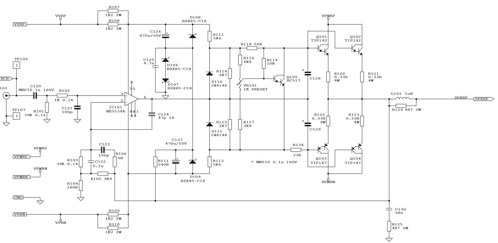

It will probably be true that the LT1028 doesn't improve anything but it is just a try. An amp with the LT1028 will hopefully follow.
I have an Class A Headphone amp in mind. I already simulated a voltage controlled current Headphone amp but built it using the AD8599 on a breadboard so far.
The opamp drives 2 darlington transistor pairs....
A fun fact is that Audio Analogue put a coupling capacitor at the apms input and didn't use a DC servo or the 5534's offset nulling capability but used no coupling caps in the preamp Bellini and a DC servo :D

Look at data sheets of chip amps, generally much lower, orders of magnitude lower, THD at about 90% output compared to 100% output.
Same process here in a transistor amp, so the thought that the 8 pin thingy is responsible, is very foolish, in my opinion.
The graph should represent the quality of the transistor amp, find out first its proper rating, off hand about 30 W/ch./8 ohms, I would expect for those TIP transistors.
Circuit does not mention rail voltage, which affects performance quite a lot.
Distortion should then be considered, if the op amp is safe within the rating of the power amp, then fiddling with the op amp is a wasted effort.
I assume he swapped opamps in the same amp. So a 5534 from a different manufacturer can make a difference.
Different manufacturers have different processes too that can lead to different behaviours of the 5534.
Even opamps from the same manufacturer can be different. Analog Devices got statistics in their datasheets for some opamps.

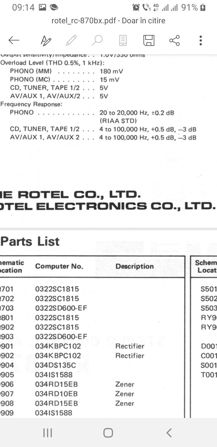

So in the end, is too complicated to change the 5533 or 34 and there is not real improvement ?
I'm trying to get you settled on this subject as you're concerned by your Rotel rc 870 phono preamp.

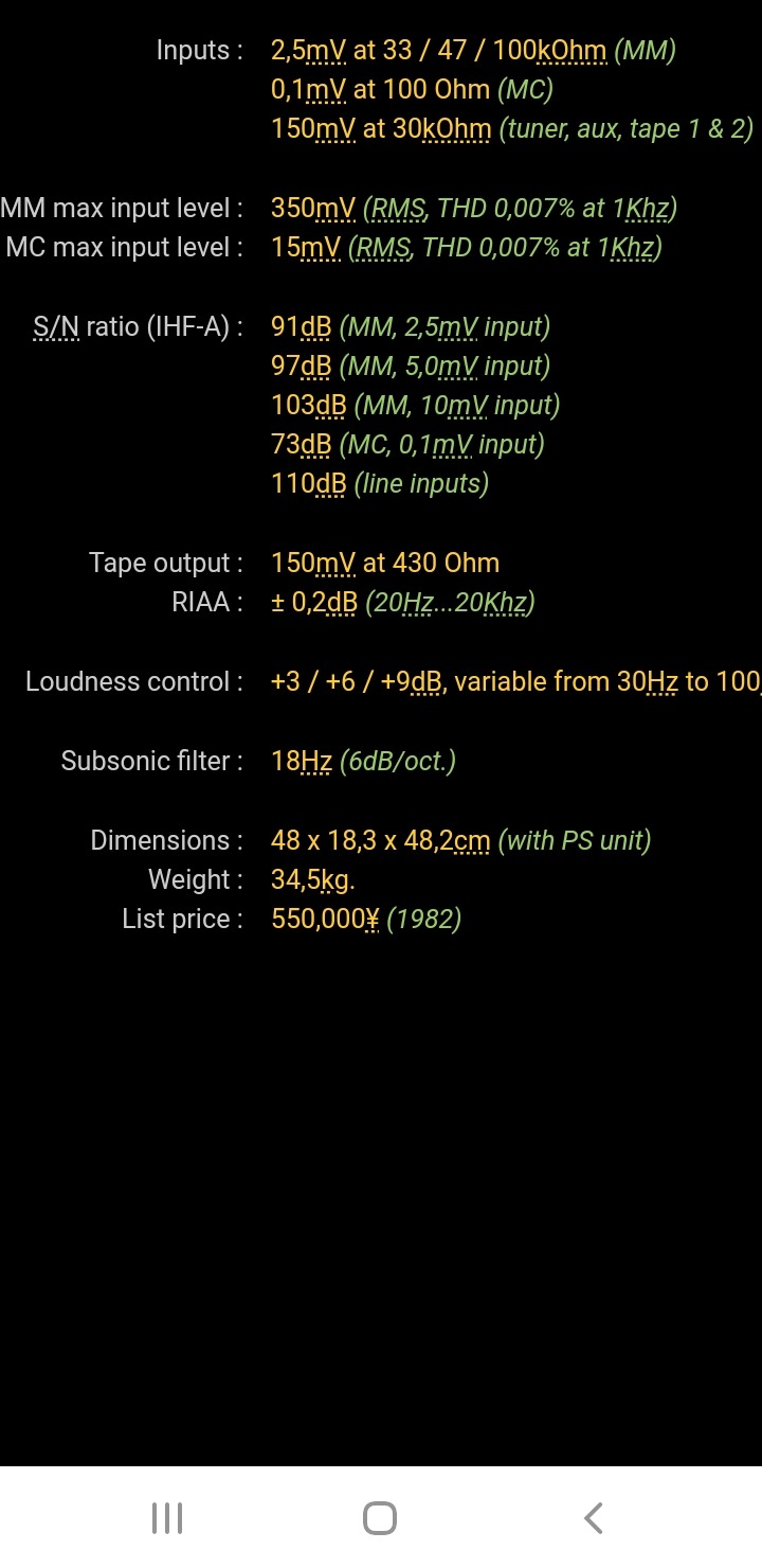

The highest supplied solid state preamps used discrete transistors supplied at 90v(technics) or +-43v( found in kenwood l-02A amplifier). The kenwood allow for max 350mv input signal and is full of clamping diodes and also controlls the input stage max gm to prevent even higher output...

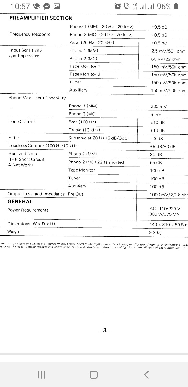

You can study Fisher CA2320 which has discrete phono supplied ad +-25v followed by ha1457 op amps in the tone stack. You substract 2v for final transistors VCE , divide by 40db gain amd you get exactly 230mv max input headroom that you see in the service manual.

You have attached your own Rotel spec sheet , Fisher ca2320 and the kenwood l-02a spec sheet where they clearly mentioned the input overload and the input sensitivity as they are correlated and depend on supply rails and VCE sat.Apparently the mc input max overload in kenwood is identical with the one in Rotel, but it's not because that is also correlated to the input impedance for the mc cart .
Your Rotel rc 870 is different from most phono preamps as it has two stages , one linear noniverting one followed by the equalized riaa inverting stage.Ne5534 works superbely in inverted mode while his common mode distortions in noinverting mode aren't that great as today's op amps using cascodes in the input.I'd say your Rotel as a few other preamps using that topology is on a middle level doing everything it can to utilize ne5534 in the vest interest of the user. There's only one other way of wisely utilizing ne5534 and that's by putting it inside a Taylor phono preamp where the common mode distortions are prevented by showing the same input impedance to both op amp inputs as the mm cartridge is included in the feedback path.I had a try with opa 2228 on that subject which allowed me to scrap the input transistors in the past, but the headroom allowed by max +-18v supplies of the opa2228 is still not enough for preventing hard clipping in Taylor's topology and while its sound on clean vinyls is superb, dusty records sound like hell...
