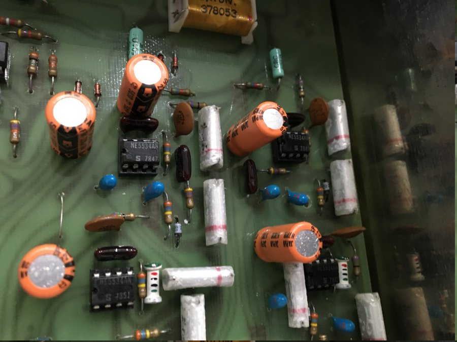

LC audio recommend the AD825 from Analoge DevicesThere are only 2 current manufacturers
onsemi and TI , which one is better ?
My current preamp has signetic, should I replaced with Ti or Onsemi ?

The only place that an NE5534 works best is in a moving coil phono stage. The unique combination of input noise voltage and current matches the audio band impedance of a moving magnet cartridge perfectly, which maximises signal to noise ratio with a real cartridge (rather than a short circuit input). The much more recent OPA1621 comes close though.
But in non-phono stage applications there are many alternatives that are much more suitable. The TI Sound Plus range is certainly worth a browse.

They have the Signetics "S". Signetics was bought by Philips in 1975 so own could say these are made by Philips (with only 1 "l" contrary to the Phillips screwdriver).
That device needs good (not cheap) IC sockets, new electrolytic caps and it seems the film caps have been caught by moisture/mold build up. If you are at it you can also replace the caps that tarnished the reputation of tantalum caps for ever: the blue drop type tantalum caps.
The opamps are really last of your concerns.

If its not broke, don't fix it. Ensure the socket has tin-plated contacts, not gold (never mix tin and gold), and isn't getting loose. Replacing an IC socket carries a risk of damaging the PCB pads.That device needs good (not cheap) IC sockets

I will replace all the caps, the specs for the preamp are amazing, Total harmonic distortion: 0.0003%, no phono section but I dont careThey have the Signetics "S". Signetics was bought by Philips in 1975 so own could say these are made by Philips (with only 1 "l" contrary to the Phillips screwdriver).

From a perusal of the noise plots, looks to me that OPA2210 beats NE5534 in that (moving magnet) application. Lower mid-band voltage noise, similar current noise. Plus lower noise corners.
- NE5534N best quality replacement?
