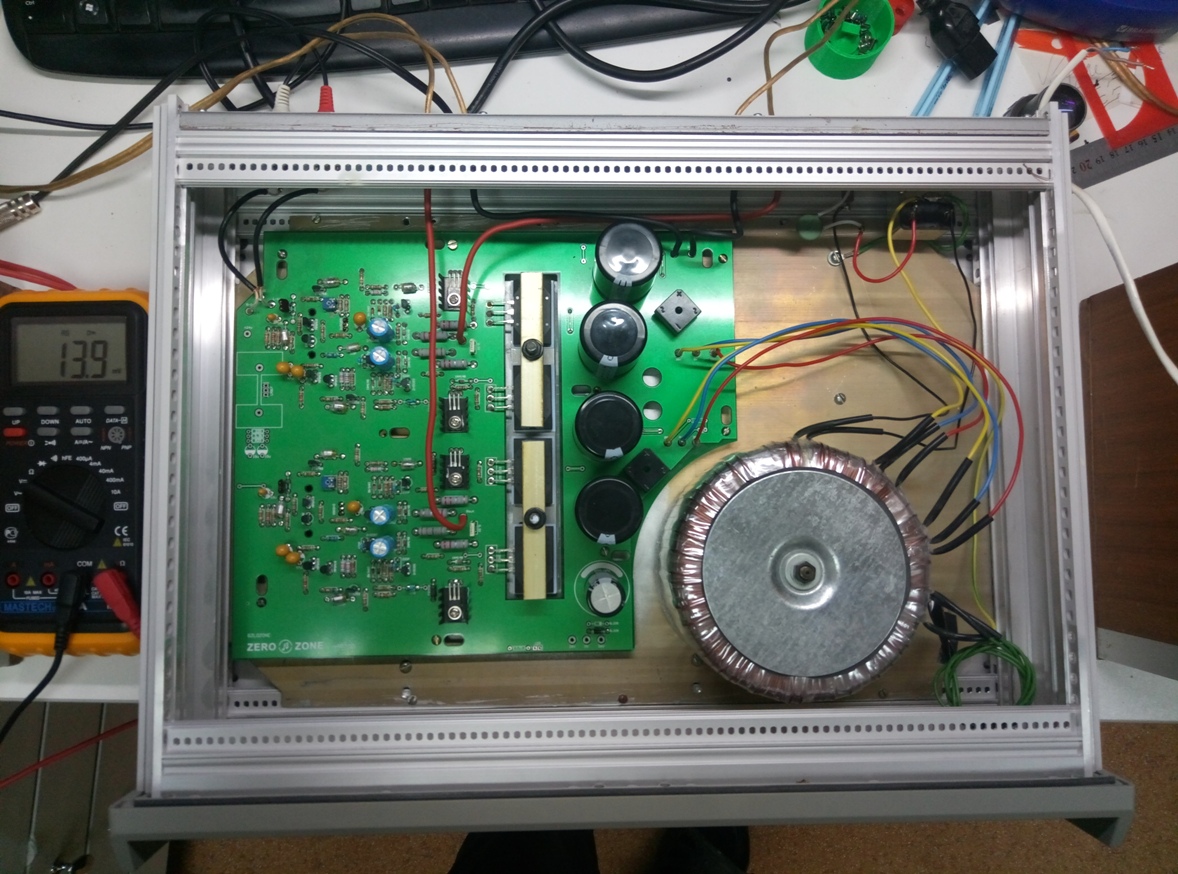

Second question about bias. I put a 2k2 trim pot instead 1kohm that was in this kit and now I can't set the bias more than 8mA. So maybe I should put 1kohm back?
I would look first in the Vbe multiplier transistor, because the bias is definitely not working. Usually, people follow the layout and install the transistor the wrong way. Follow the schematics and the transistor pinout instead.

Today I checked Vbe multiplier transistor and everything was OK just like in schematic. But I've noticed that one resistor is 1k5, as labeled on PCB, althought on the picture of real NAP it looks like 2kohm (according to color chart). Have changed it and it allowed me to set proper bias (it was about 6mV on emmiter resistor).
Now bad things. The hum remains the same. But I've notice that it totaly disapears when I toucing some places on PCB with probes of my multimeter. I marked this places in red circle in attaced schematic. Same thing in both chanels, even when I touched the body of this resistors by fingers. In this case amp is workin good, deth quiet and sound is goit on.

The fact that touching the current sources for the input stage with meter probes kills the noise, does suggest oscillation.
However, is the noise actually hum, where there is a dominant, low frequency? Oscillation (AKA instability) seldom has much low frequency or audible content at all. If it is hum, you should check that your ground wiring and connections are correct. For example, there should not be multiple connections between the chassis and/or between the top and bottom copper layers of the PCB. The PCB mounting bolts could possibly cause a problem by forming a short there. As you may be aware, the original PCB "floats" on rubber mounting posts, so this isn't possible.
Also, the ground connection for the preamp inputs is designed for a single ground wire - not the normal type where there are are separate grounds for the chassis and each signal lead, as you find where RCA connectors are substituted. This problem and a solution for use with the NAP 152 clone kit, has been discussed here recently.
BTW, what is the material you are using for the bottom of your case, Azatto? I can't be certain from the pic. but it doesn't look like aluminium or other suitable heat conductive metal, which you definitely need for the heatsink.
You don't say if you have correct currents and voltages in this area. Are the current sources working as expected? What are the transistors installed there? Are they very high gain devices?
Same as before: first check the surrounding components, values, transistors pinout. Measure the actual currents. Are they close to 4mA and 10mA?
... I don't have practical experience with this type of 2-transistor feedback current source, but if there is feedback there may be oscillation. Adding some capacitance with your fingers or DMM probes kills it.

The end of this article shows similar schematic but they added some base stopper. Not a bad idea to try few hundreds ohms in the base of TR3A, if anything else checks OK and you still have the oscillation.
Yes, transistors in current source is high gain MPSA18 (came with the kit).
Voltages seemed to be allright, as in schematic. Haven't measured curents.

The bottom of chassis is annodised alluminium. You can see sanded area under output transistors and near transformer.
I also ordered plastic spacers to mount schassis.

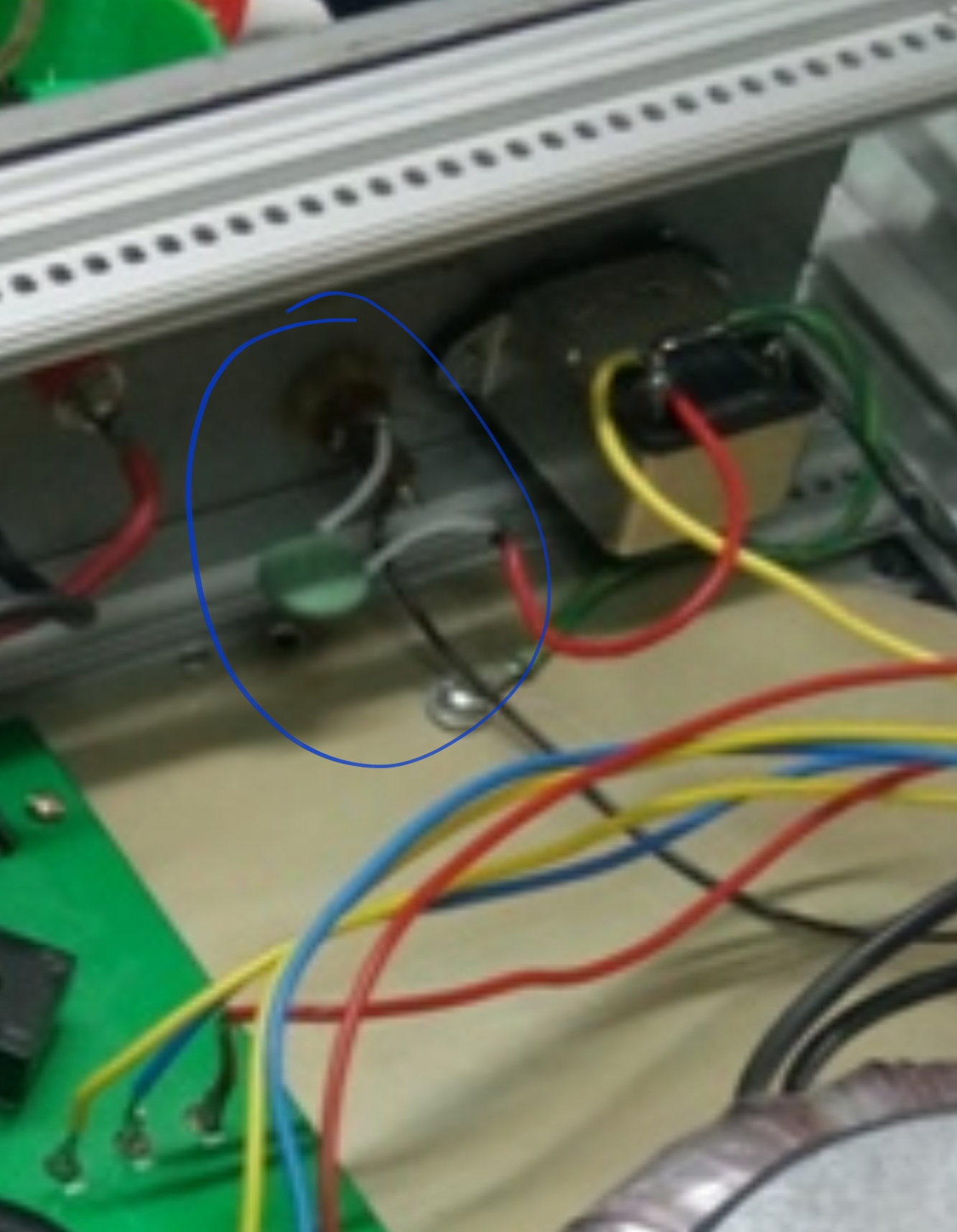

It is not a capacitor, it's thermistor going to fuse holder.This cap you have.. is it from the mains power to chassis?
What rating is it?
I'm going to change transistors in current sourse to MPSA06 as shown in schematic.
Cool, hard to tell from the pic.

Congratulations on the quality of the build - it looks brilliant
The only thing I noticed from your pictures was that you have installed the small smoothing cap and one of the diodes for the external power supply back to a pre-amp, but you are not using the external supply, so I don't think they are needed at all.
Is there any possibility that the star earth pattern on the PCB is seeing them as being in circuit?
Not sure it would make any difference to Hum but just a thought.
