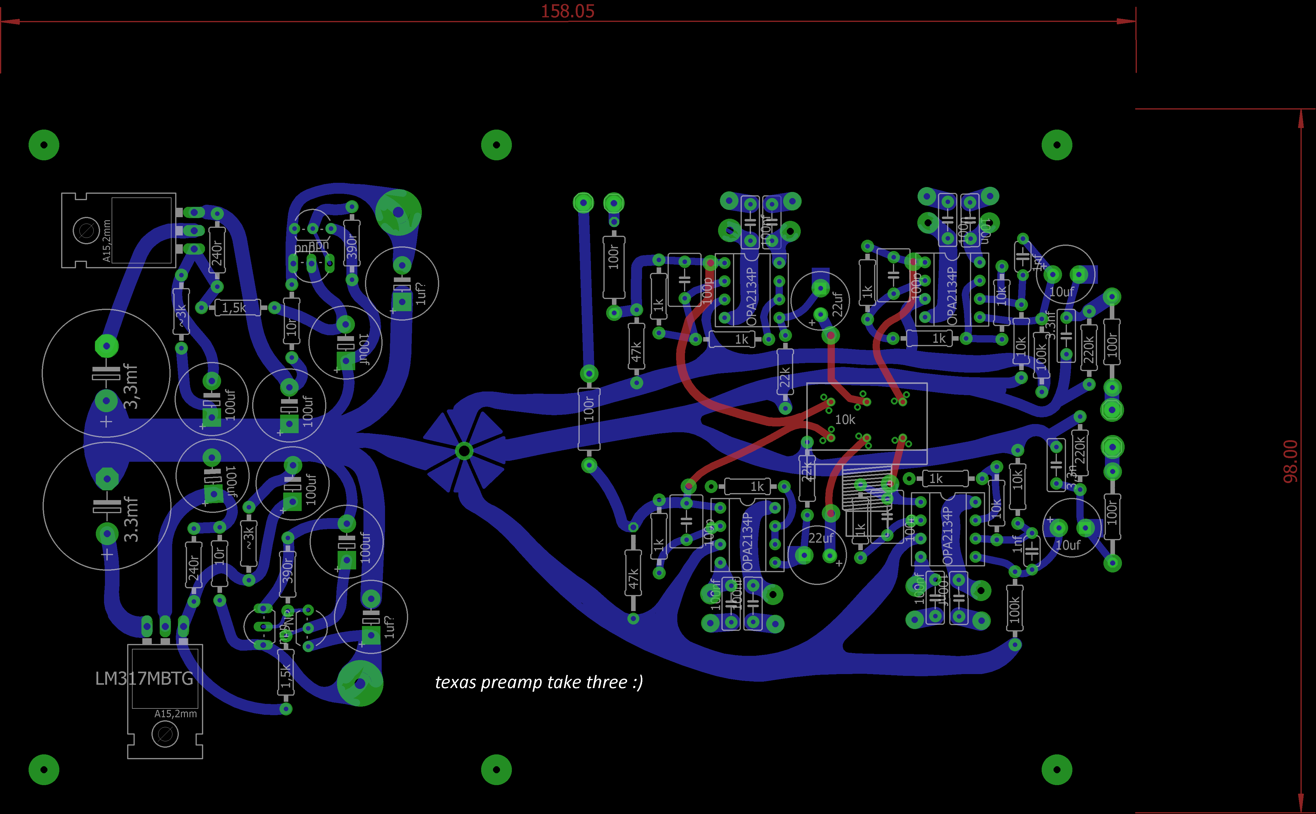

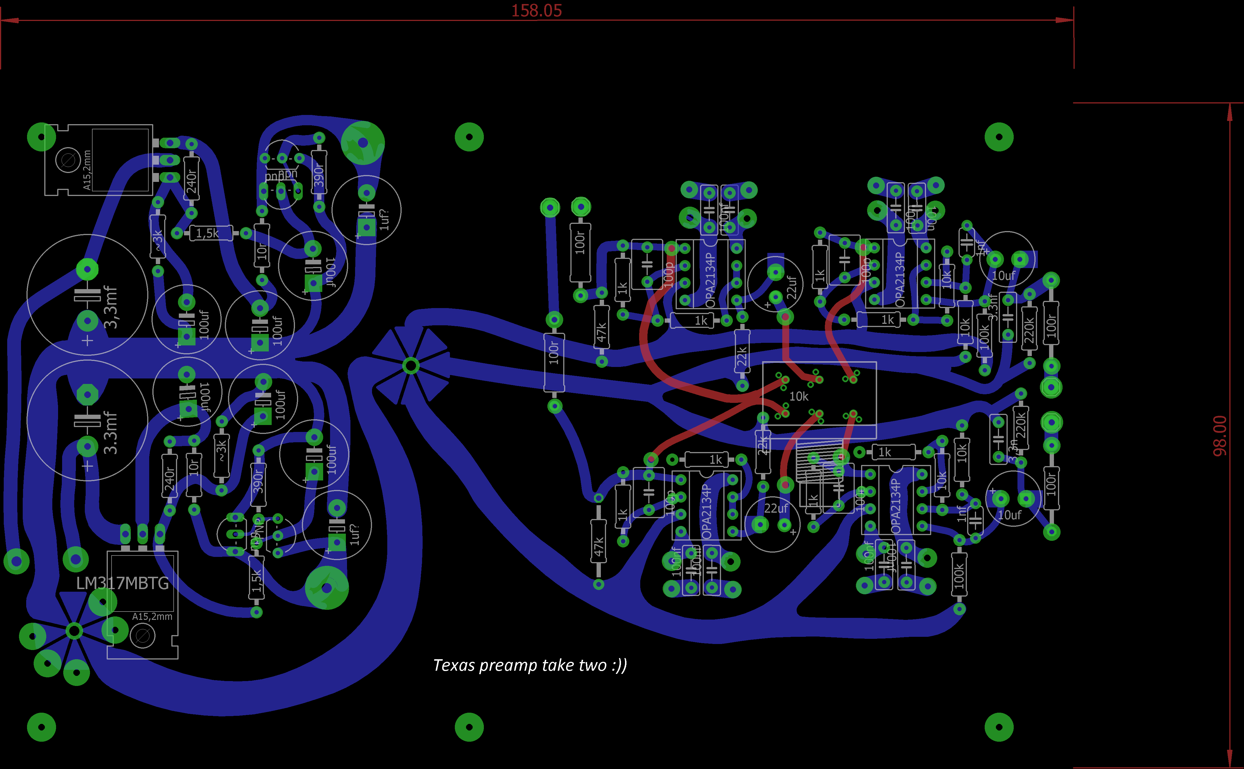

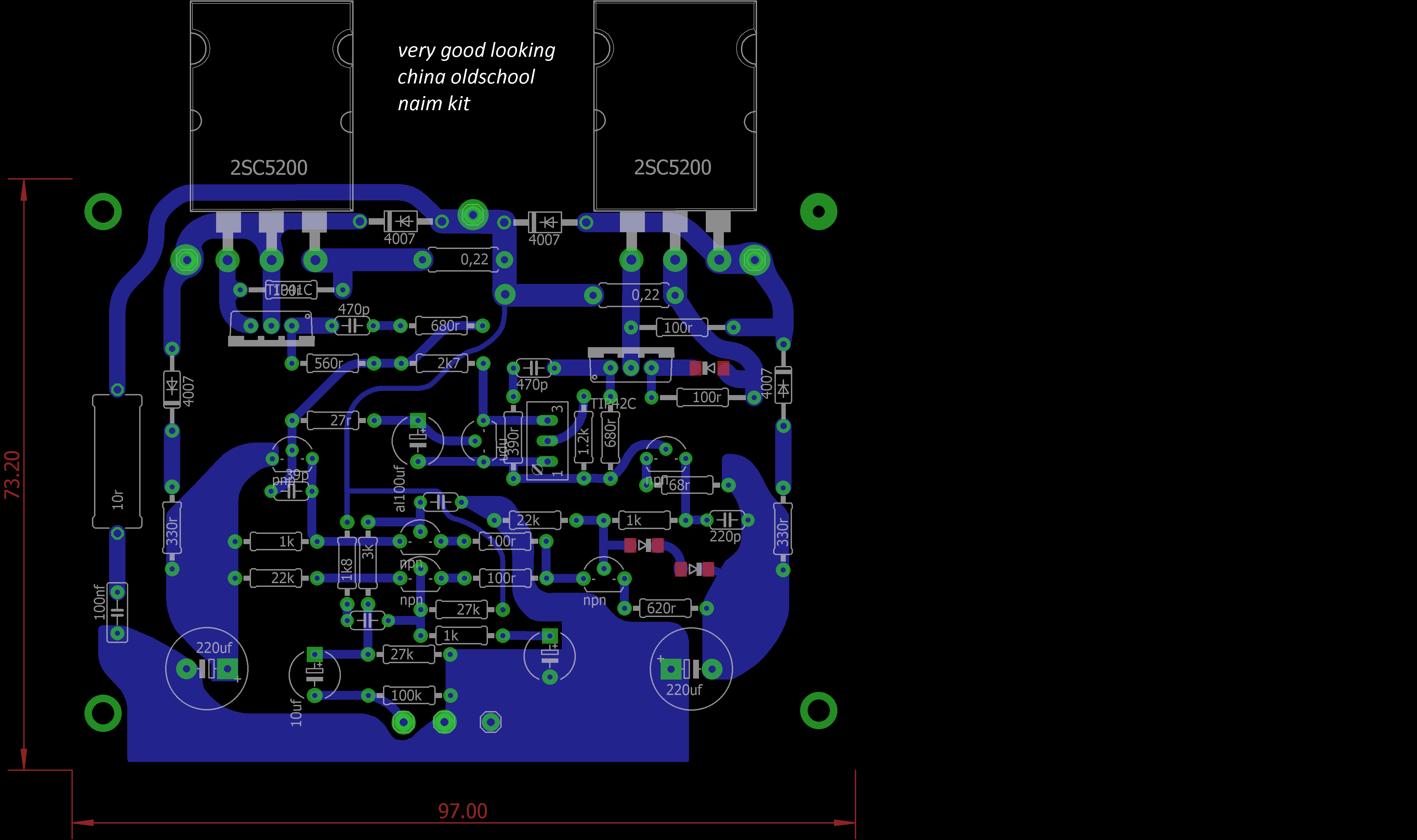

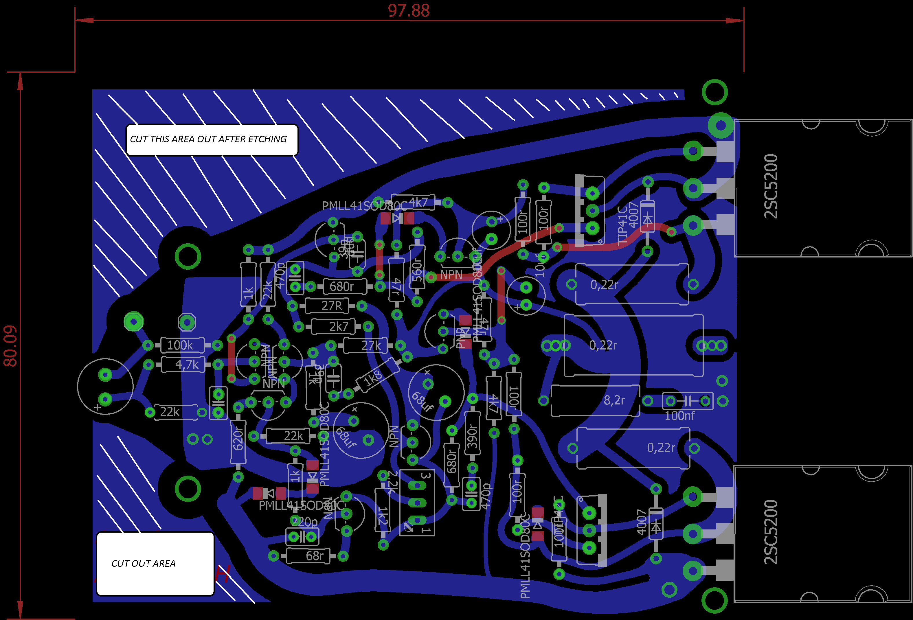

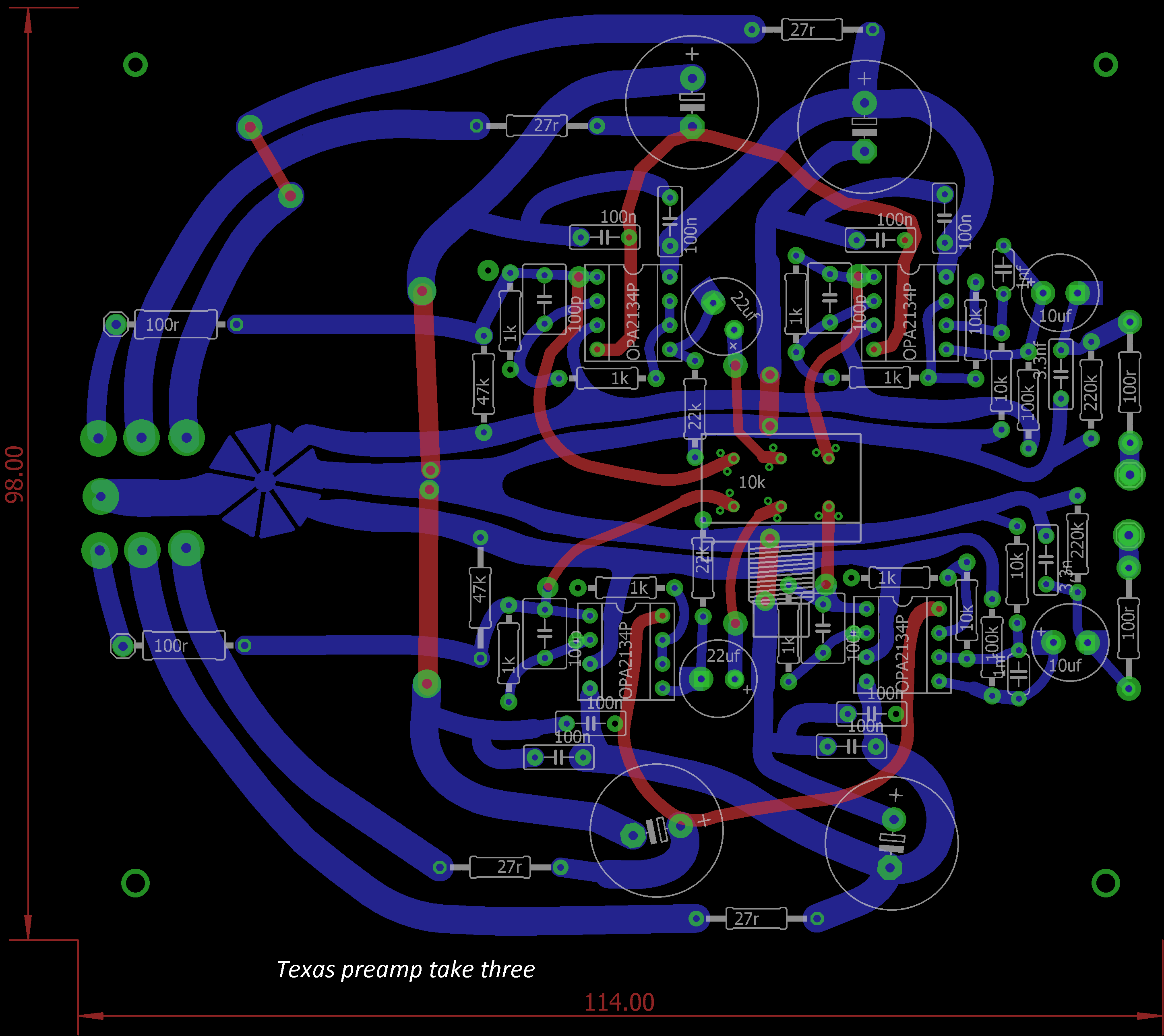

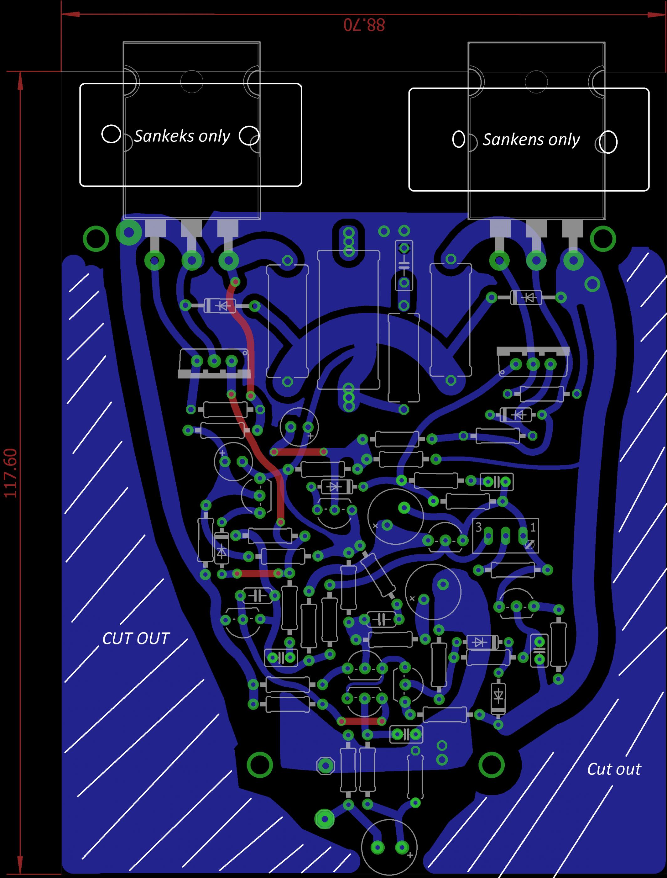

Drawing and correcting these PCB took little over two months :
If someone wants PDF negative and positive , let me know pls 🙂

Nice board, Bigun!
(Although it appears to have contracted a tantalum infection....😀)
darn, how did those little buggers get in there !
