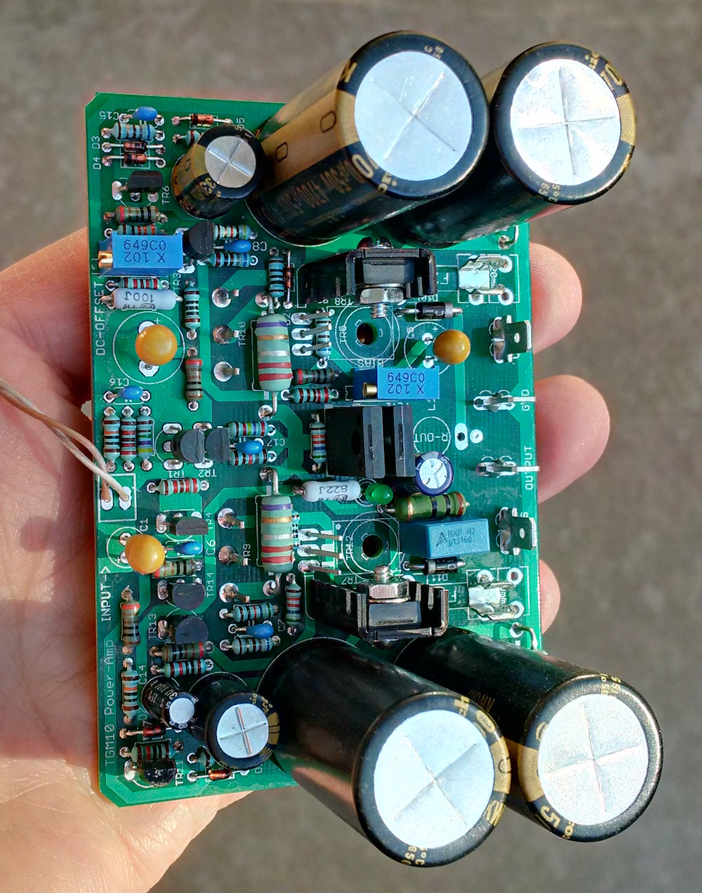

Ok, so today I finaly done my amp and I think all the troubles that I posted in NAP-140 Clone Amp Kit on Ebay is gone.
I have changed transistors in current sourse from MPSA18 to MPSA06, changed broken ZTX753, also found burned resistor, changed spacers under PCB to plastic ones.
Now it is dead quiet. Set the bias - it also OK. DC on outputs is around 10mV.
Just tried it with smal speakers on my job, have to move it to home, and than if I'll like it I'll make it look beter.
One more time thanks elerybody.

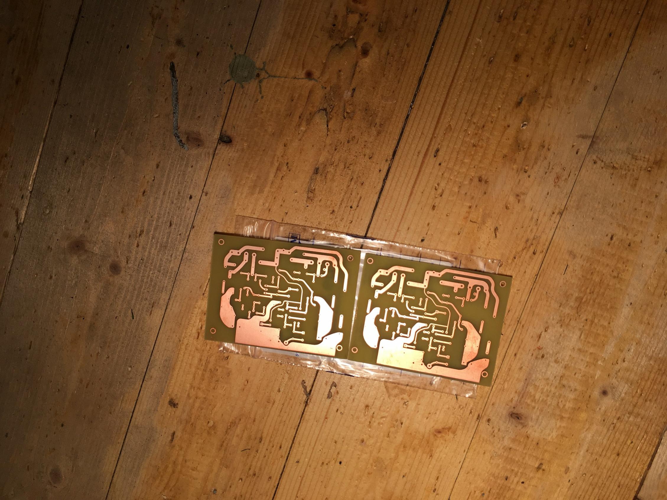

I took a H-140 naim clone and cloned these PCB again
laser-printer toner method <-- that is correct. Using high quality white paper(it means most suited for MY LAZER printer) + a spray that makes paper transparent for ~15-20 minutes.

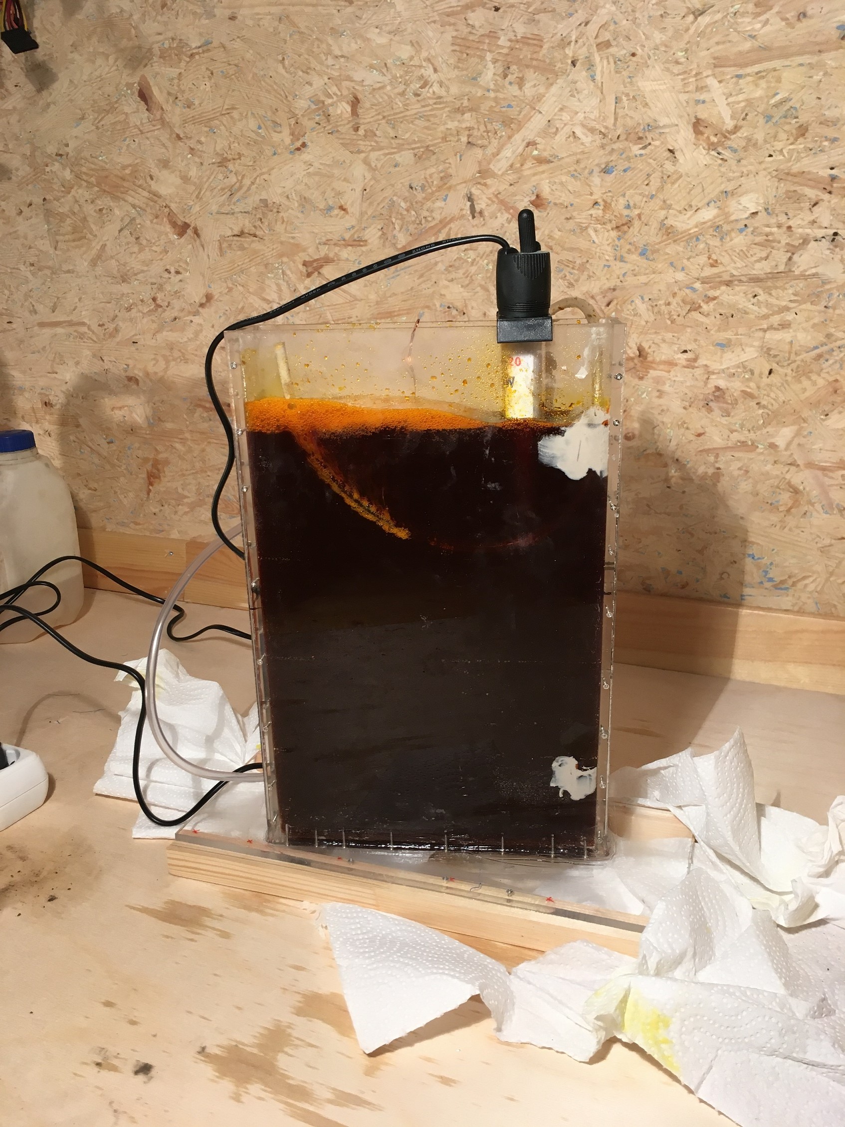

Most time consuming was to get right amount of UV light and a mix of sodium hydroxide with water.
Right amount of UV light depends on light itself, paper, black ink/toner quality and transparency of the paper and also printer IMAGE quality setting and programs
Mix of sodium hydroxide depends on UV light applied, Copper Board light sensitive coating.
I buy my Copper boards allready coated in light sensitive lacquer.
I will give more detail later.. its getting so offtopic, sry

Iron transfer is pain, everything else is real pain
Buying light-sensitive boards and using UV method is fastest for good results. There are only two not very hard to find chemicals involved: NAOH and Fe3Cl.
Only minus i consider is getting it started and the final cost per finished board....
L160xW100mm one-sided board of 35µm copper costs 2.8044€
L100xW75mm on sided board 35uM copper = 1.6€
Finished boards with UV method:
L160xW100mm will cost you total ~3,2€
L100xW75mm ~2€
20minutes per board, drilling not included.
