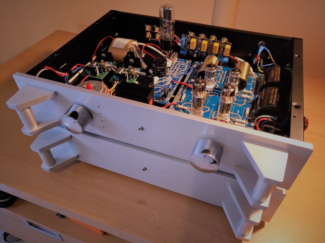

Stylish build. 🙂A while ago, I decided to experiment with the installation of a stabilized power stage on my NAIM NAP-140 clone more out of curiosity than out of real need, as even today this project remains the best sounding power amplifier I have ever seen in my living room.
It appears from the photo that zobel and input grounds are connected together on each amp board?

Stylish build. 🙂
Thank you for your words of appreciation.
In fact, in the latest versions, I have completely eliminated the original network of Zobel, never having found any kind of instability and / or oscillation with any type of speaker, cable connection or condition of use.
