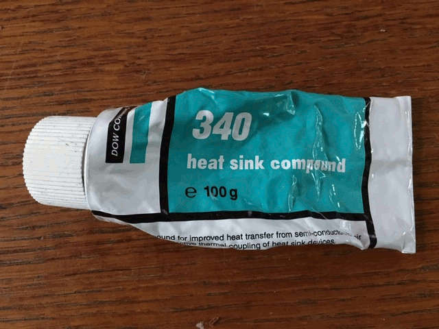

I notice that it is sold in package of 4gram.BTW if you are looking for thermal paste you might consider fancy pastes used by PC gamers for microprocessors. These have significantly better thermal conductivity than the stock stuff. I’m using Arctic MX-4. This isn’t a big deal but if you need to buy some anyway...
Any idea of how much i need? Have never worked with this before - so I am blanc!

It's plenty for 4 transistors and mica washers. Only a very thin film of it is needed; any more will be squeezed out when the transistors are screwed down.I notice that it is sold in package of 4gram.
Whether it is enough for this and also between a metal bar and the chassis I'm not sure; depends on the dimensions. JimSalabim might be able to tell you how much he used.
The amount also depends on how smooth your metalwork is. The smoother and flatter the surfaces the less grease is required.

4 gram is enough to do the job several times over if you don't squish the stuff everywhere. Be careful with the type though, some high performance grades are conductive because of a high silver powder content.....Any idea of how much i need?.....
Conductive paste is fine with plastic bodied CPUs but you get nasty crackles and shorts where the paste bridges between the collector and heatsink if you are careless with application.
Again, only use the paste with MICA washers. It is useless with silicone rubber washers
I have bought 8g of grease and more than half of it is still left. At last I removed it again from the transistors, because I had no mica washers, only rubber/silicon washers. But I used it between the metal bar and the chassis. 4g should be enough for both the metal bar and the transistors.
I think this is exactly what shorted my LM317.
I would avoid the Arctic stuff. It is not suitable for high power use e.g. it will pump out quite soon when used with IGBT modules etc. So why risk it with medium power?
The thermal conductivity of the paste is far less important the its ability to fill the gaps and stay there. Metal to metal contact has the lowest thermal resistance and ideally the paste is just there to fill the micro-gaps.
Stick with something proven like DC340 IMO.

The specialized thermal compounds used by PC gamers are very much proven and are used for high performance CPUs and GPUs which have to dissipate considerably higher powers than a Naim clone is ever likely to.Stick with something proven like DC340 IMO.
Here's my old tube of Dow Corning 340. This is what I used to use for power transistors before Arctic MX-4. I still use the 340 for large areas like between heat sink fin blocks and chassis because these areas are less important and the Arctic is 10x more expensive. I also considered the Noctua NT-H1 which I use in my PC but it was 50% more expensive again and I didn't think it was worth it.
The Arctic compounds perform poorly with power electronics.
I guess it's a question of wheher you think power transistors in amplifiers are closer to power electronics or to CPUs in the their thermal behaviour.
In reality it probably doesn't matter, it's a relatively tirival application.
