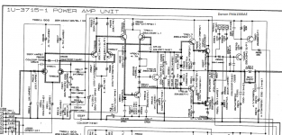

But in recent times even Japanese companies decided that quasi stages are not useless and started producing amps with them. Look at the schematic of this excellent Denon PMA1500AE. It's quasi with vertical mosfet outputs.
Mosfets are different... they are basically a variable resistor and don't care which terminal is which, therefore they are (possibly) more suited to Quasi operation.
