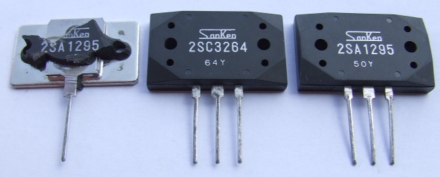

I have read that ready made kits have some fake Sanken transistor, and some parts doesn't work, does it is true?

Great 🙂. You may also know that large MT200 size Sanken transistors are obsolete but Zerozone kits come with recycled original type power transistors. They appear to be genuine but no one can guarantee what you get unless you buy from authorised distributors. I do find genuine new Sanken parts in other kits too but there are still problems because they are not matched - maybe the grades aren't even the same. Testing and sorting power transistors is expensive and sometimes it isn't possible to get matches without having large stocks of parts to choose from.
Apart from being narrower and only having a single mounting bolt, there is no reason that you could not use Sanken's T03P size versions in most NAP models. These are the types Naim use now and they will be the real thing from agents like Digi-Key.
So, Sanken's T03P may used instead of Sanken MT200 (2sc2922 right?).
Do no matched transistors degrade sound/performance?
