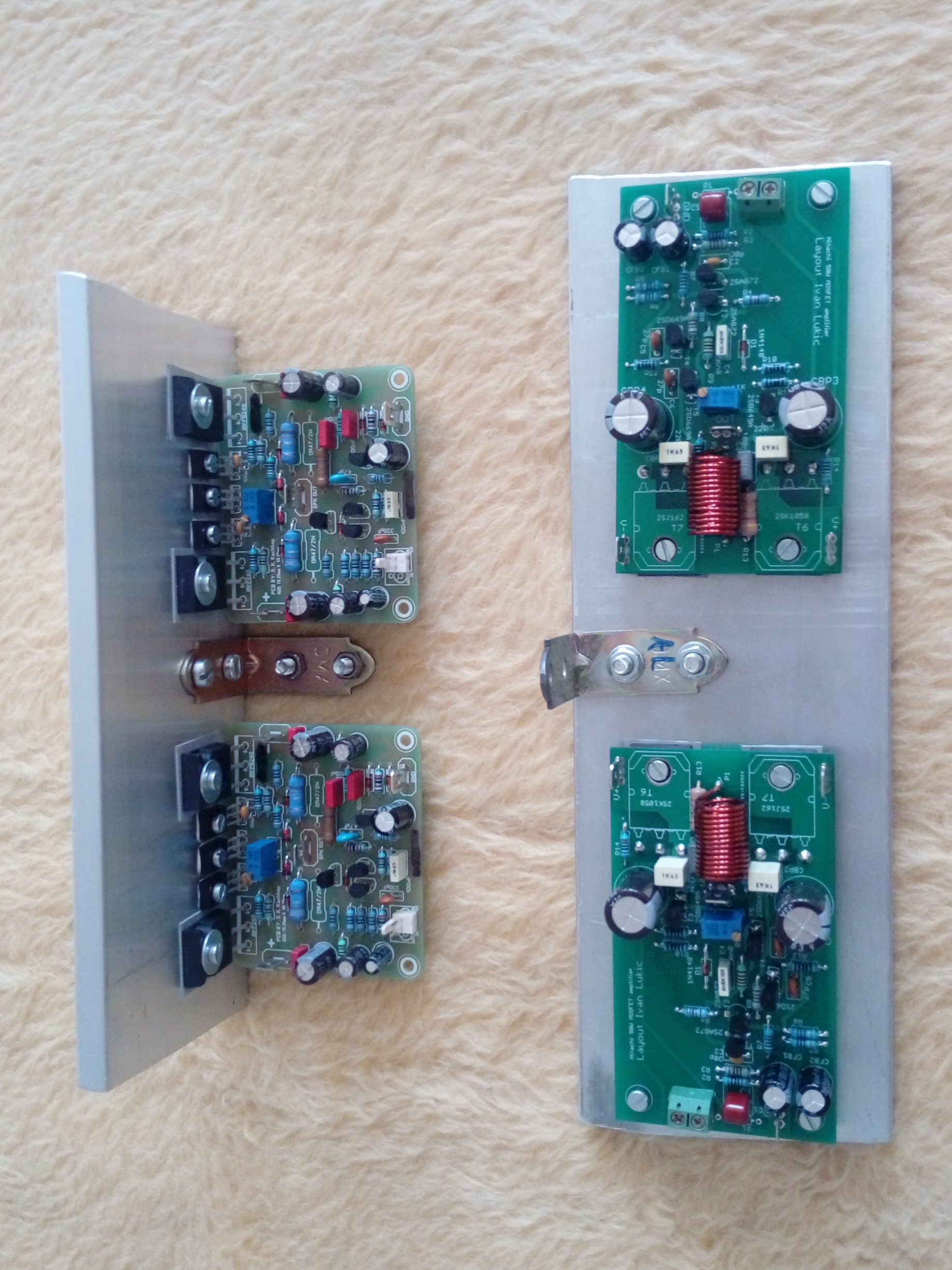

Suitable cheap and simple heatsink for Naim clone can be made from what we here in Serbia call aluminium "flah" (from the German word "flach" meaning "flat"). I usually buy 2 meters long piece 80mm wide and 8mm thick and then cut it to suitable lengths. Good side of this mounting method is that nut and bolt can be used instead of threading the heatsink. 250mm piece is about half a kilo in weight. It is absolutely enough for even loud home listening.
Different mounting methods can be seen at the attached photo.
