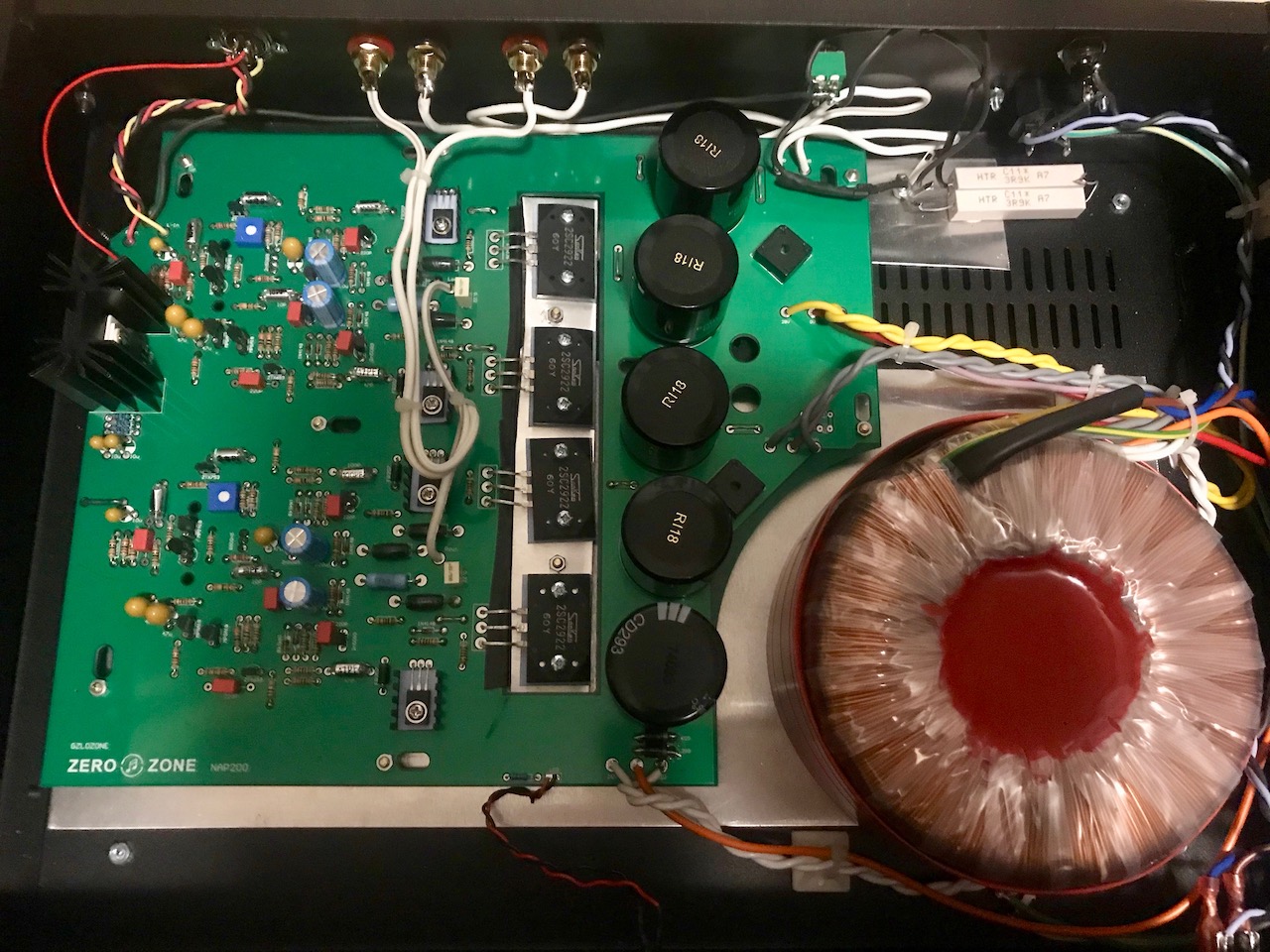

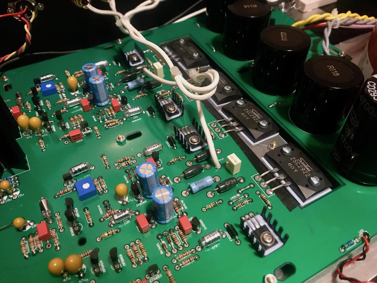

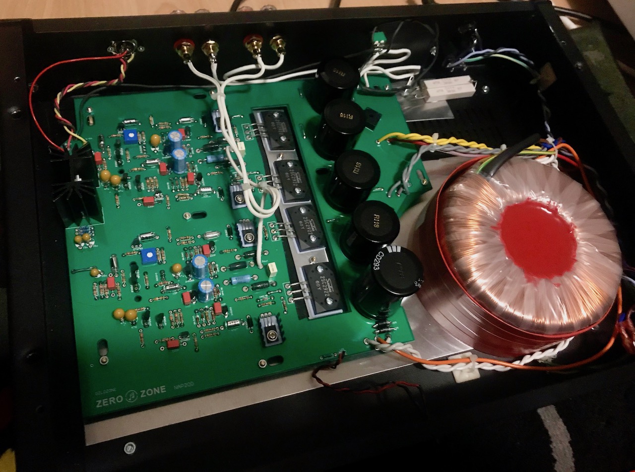

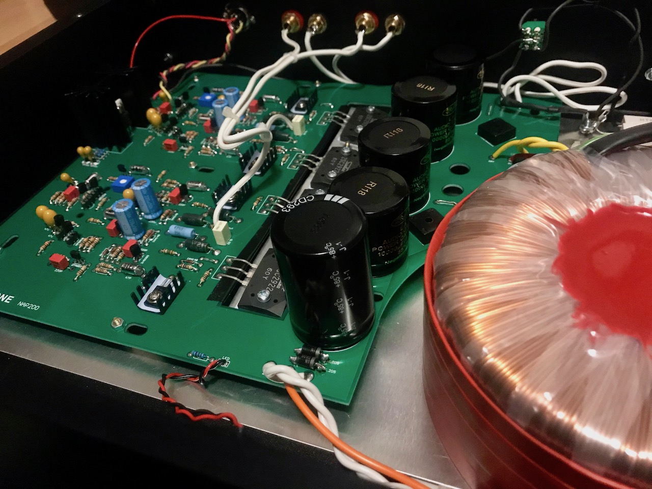

OK folks. Thanks to your help and advice I have successfully finished my NAP 200 clone. Offset on both channels is around 7–8 mV each, I guess that’s fine then.
The transformer is custom made from Tiger in the UK.
I have added a three way switch to switch the PCB ground from floating directly to the chassis or to the chassis via two diodes in reverse and a 10W resistor. My first impression was that only the floating option gave a tiny little bit of hum and both others no hum at all. But I wasn’t able to listen closer yet, because there is a problem with one of my preamp PCBs (NAC-42 clone). I have already contacted the seller. The left channel works great, the right one is accompanied by hiss and noise. It’s definitely somewhere on the preamp PCB of this channel, I ruled everything else out.
But the NAP 200 works great.

Congratulations. It's quite a big project but a well-built clone sounds superb, I think. You appear to have taken the right steps to mounting the semis but I'm not sure about the thin sheet of aluminium under the PCB. What is this for? Normally, you only need a bar of about 25x4 to 30x5mm that fits within the large PCB slot as a heat spreader between transistors and the case. Of course, a thick aluminium case is essential to use the amplifier at medium to high power, as with all Naim designs.
You will need to add some heatsink grease between bar and case to ensure good thermal contact - where it is most needed. A finishing touch is a plastic cover (anything from the junkbox that fits) over the input transistor pair, as you see in pics of the original. I simply used a discarded cover from an HDMI connector.
The transistors are mounted to a 1mm sheet of aluminium which fits the large PCB slot. This sheet of aluminium is screwed to another 1mm sheet of aluminium (under the PCB, directly on the enclosure bottom). I don’t know if this is a useful approach, but this is all I had left. If it’s absolutely necessary I will get a bar of the size and thickness that you mentioned. But the amp will only be used at normal living room/bedroom levels anyway. I also didn’t have any heatsink grease left (I thought I still had some) – is it very important then?
It will be better just to use a single bar (least number of junctions) The problem with layered thin sheets is that the case is the heatsink and like with any heatsink, the best conduction, hence the thickest metal, must be right at the point of mounting. Adding thin sheet aluminium layers is likely to hinder heat dissipation as you cannot keep the grease (or more likely an air layer) between the sheets thin enough to consider the metal to be in contact. Black surfaces are best for dissipation too but even heatsink grease is nowhere near as conductive as metal .
The rigid bar is used because the number of assembly bolts spread over the smaller area will maintain much better contact with the the transistor insulating pads and the bottom plate of the case. If the case is at least 2U rack size and 3mm thick, then it should be sufficient to draw heat from the bottom plate and into the rest of the case to keep average temperatures comfortable at full power.
Otherwise, heat is retained by the output transistors instead of being dissipated. If you decide to use the amplifier only at low output levels, that is your decision but it is better to clone the original design so that it operates as intended and bias control tracks the internal temperature properly, as designed. 😉
One thing you can do is put a voltmeter across an emitter resistor to measure the bias current as it changes. Then get your hair dryer out and give the output transistors a vigorous blow dry for several minutes. See how much the bias current changes. Perhaps also heat the bottom of the case. If it starts at, say, 20mA I suppose making sure it doesn't drop below 10mA or exceed 50mA would be sufficient and make sure it doesn't "run away".
Ideally, of course, the bias would not change at all whether very hot or very cold. But at moderate volumes in a normal room temperature the transistors probably won't warm up much.
NOTE: try not to heat your power supply caps. Shield them somehow.
I have this case here:
Pesante 02PN 2U 10mm NERO
But the case is only 1mm thick, so this thick rigid bar under the transistors would surely be a good idea. But honestly I got no idea where to get one :-D
And you would suggest to remove the aluminium plate under the PCB completely then?

Are your 0v connections the centre tap of your transformer windings?

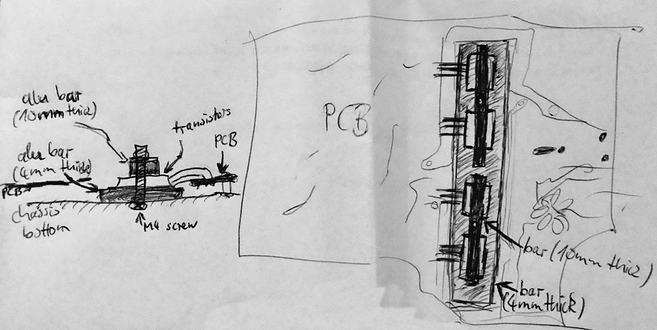

You can get an idea from the images posted earlier and with images at kitsellers' sites but the bar used to clamp the power transistors is a Naim mounting technique, seldom used by other manufacturers. Most clone kits show the transistors simply bolted down with 2 x 3mm machine bolts, washers and nuts and this technique is more universal with audio manufacturers. If you use a clamp bar, be careful to ensure it has plenty of depth and thickness so that there is sufficient rigidity to prevent any buckling under load and subsequent failure of your (now) obsolete transistors - The force required to squish the thermal pads into ideal contact is significant.
Note also with the bar clamp, the bottom plate will bow or bend slightly under the force. The heat spreader bar between the chassis bottom plate and transistors must be rigid enough to prevent this bowing, otherwise thermal transfer over the whole transistor backplate area will be lost. If you use this method, do it right or not at all.

I havent succeeded in finding a good picture, so as my teacher always said "make a model Thomas"!
Below I have tried to illustrate how I understand your description.
I the hole in the PCB I place a 10mm thick aluplate, on that the four Sanken, and on the top a clamp (see fig 1)
You mentioned that I have to bolt it quite hard to secure thermal connection! In figure 2 i have ilustrated that the aluplate could be fastened to the bottom plate of the chassis with some extra bolts. The thought is that the force towards the bottom of the chassis will be spread. Thereby less risk of bowing!
I hope that I have understood you correct, and my figures helps this clarification.
