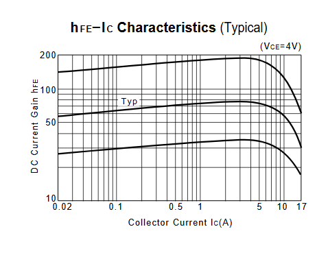

The hfe (small signal current gain) of the transistor will vary with collector current. 122 looks in the right ballpark for the 2SC2922:

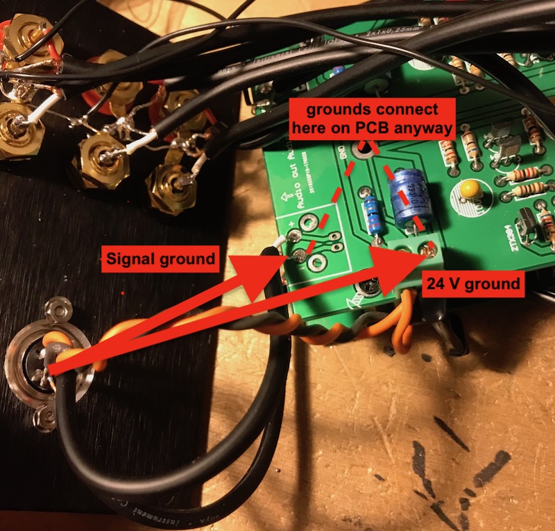

I have just finished the preamp (based on NAC 42, to be connected to the NAP 200 clone via 4 pin DIN cable). One thing which I’m not sure about: The output signal from the preamp and the 24V supply (from the NAP 200 clone) share the same ground pin on the connector. On the preamp PCB the signal ground and the 24V ground are connected. I have now run ground wires from the 4 pin DIN connector to the 24V connectors on the PCB and to the signal output (-) pads on the PCB. Am I causing a ground loop, because these are connected on the PCB anyway? Should I omit the ground wires to the 24V connectors or is it fine like this?

For universal use, Zero zone clones seem to be modified to suit RCA connectors with separate grounded shield leads. Original Naim NAC models use a common ground and common 24VDC power. They have a 4 pin DIN connector for preamp to amplifier connections. Thus only 2 signal leads, power and one ground connection are used with the NAP200 if you included the correct type of DIN connector, 24V power supply and wiring.
From your diagram, they form a triangle. Theoretically, this is a loop. However the wires are short and the currents small so most likely not an issue... You can use only one wire, question is to which point on the pcb. I guess just to the signal ground is ok.

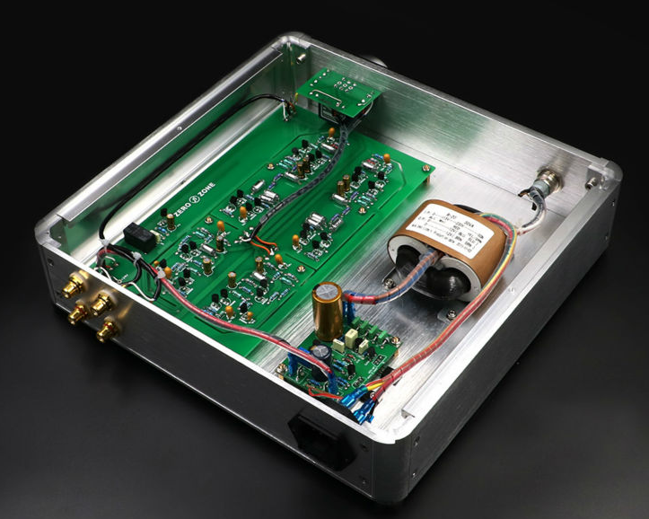

The transformer in the middle picture of Ian's post is interesting. This is a C core with non-overlapping windings between primary and secondary. It also has a copper shield wrapped around it for minimizing high f EMI. Only 4 primary wires: no need for an inter-winding shield. A toroidal transformer is coaxially wound, usually very tightly to reduce leakage, and therefore has a much larger inter-winding capacitance. Some advantages of a toroid are more confined magnetic field, lower leakage flux and smaller physical size for a given power.
These transformers seem to be very popular on eBay recently, and very cheap W/$. Unfortunately, they are junk, or should I say the one that I bought was junk. IMO, not suited for audio at all. It had mechanical hum, large radiation field and the winding voltages are all over the place. I bought it for a tube preamp PS and discarded it imediately.
