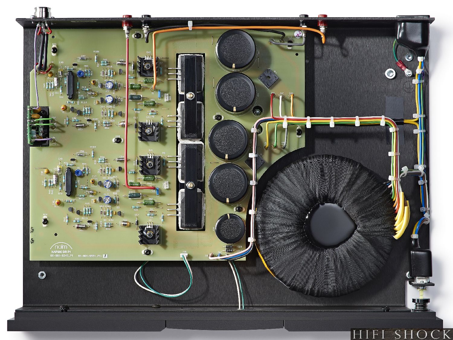

This image of an old NAP250 gives some clues to what Naim does.
You may observe that the transformer has 5 primary leads, two of which will be dual primary windings (series for 230V and paralleled for 115V) and one is a pink wire that connects directly to the mains input socket earth. You can also see the socket earth connected to the chassis nearby. I assume this pink lead connects to an electrostatic shield that combats the inter-winding capacitance.
The transformer outputs have 6 thick wires and two thin, purple wires. There are two secondary, centre-tapped windings and the purples appear to feed the power switch bulb. The centre-taps connect to ground at the smoothing caps. So the transformer secondaries are always tethered to ground which presumably reduces noise because they would otherwise be disconnected most of the time and floating (only connected when the bridge rectifiers are conducting). The direct connection of centre-taps to amp ground couples the transformers inter-winding capacitance between mains and amp ground BUT this problem is reduced by using an electrostatic shield.

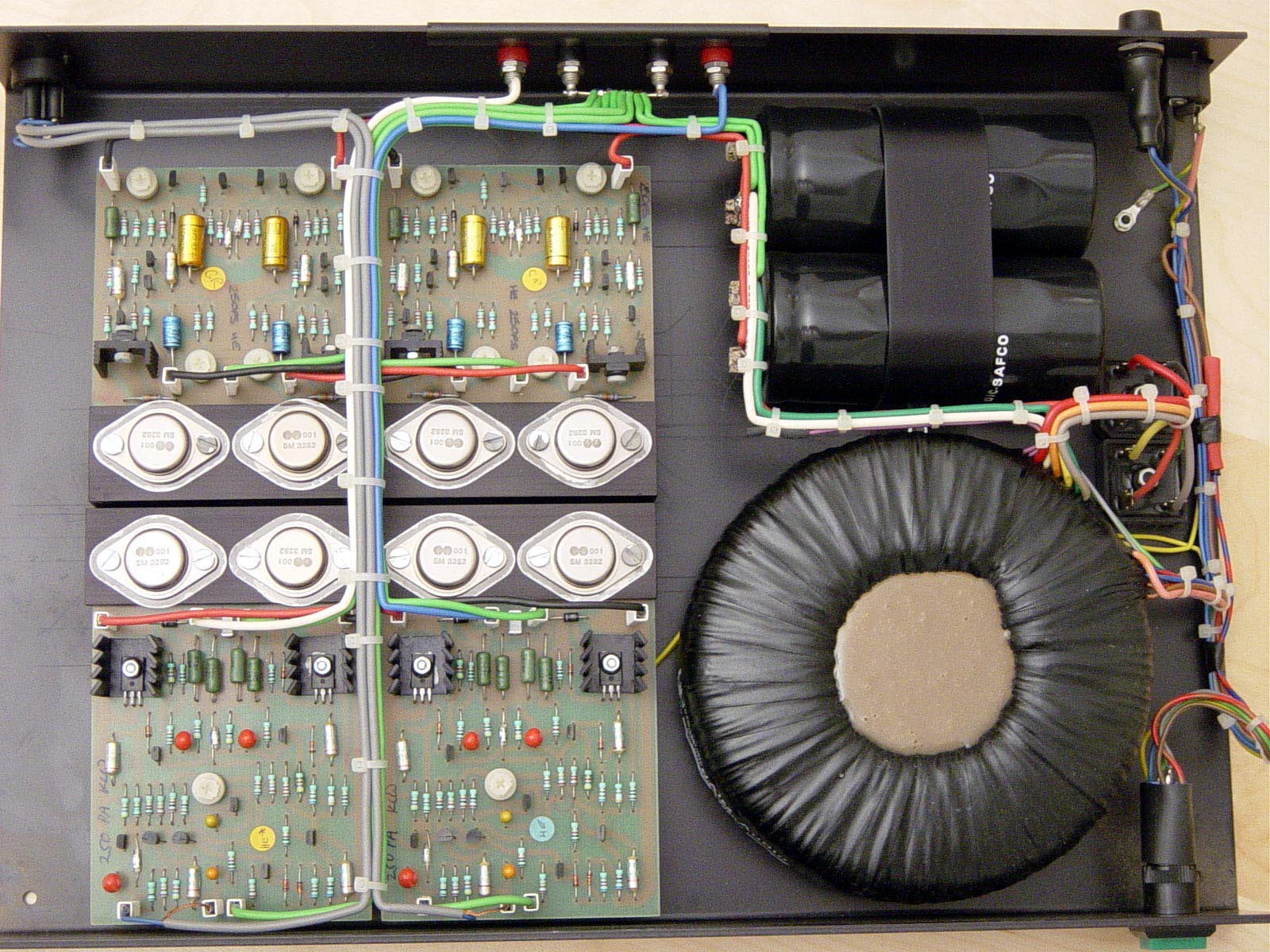

You can see the same transformer wiring in the NAP200.
It is harder to see but again the primary has 5 wires, one of which is a shield connection to the earth connection at the mains socket (probably the green wire). The secondaries are both centre-tapped.
