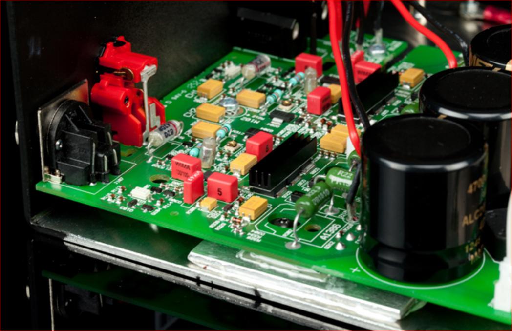

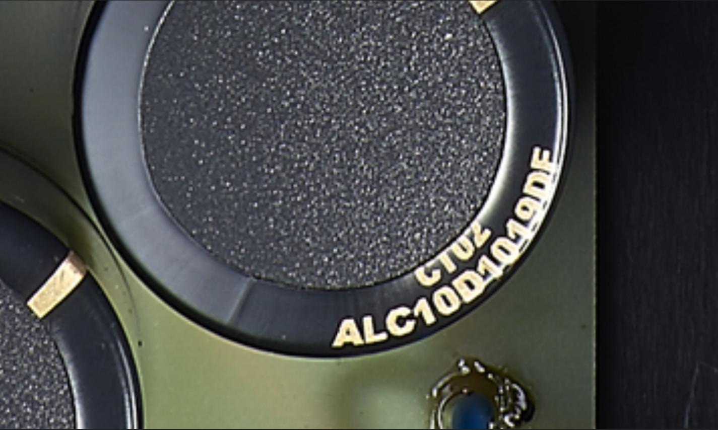

Here's a smoothing cap in a NAP250DR.
http://www.oliveandblack.co.uk/ALC10D1019DF063-5.pdf
Yes, ALC10D series though, seem to be custom products and there are few sellers at reasonable prices. This Naim service agency asks £15 each + extras. Naim Audio Hi Fi Servicing Components and Capacitors | Worldwide shipping
It makes a recap with original parts rather expensive unless you are in the UK - certainly disproportionate to the value and expectations for clone kits or for curious DIY builders on small budgets.

The Mundorf MLytic AG 10000uF 63V are also about £15 in the UK.Yes, ALC10D series though, seem to be custom products and there are few sellers at reasonable prices. This Naim service agency asks £15 each + extras. Naim Audio Hi Fi Servicing Components and Capacitors | Worldwide shipping

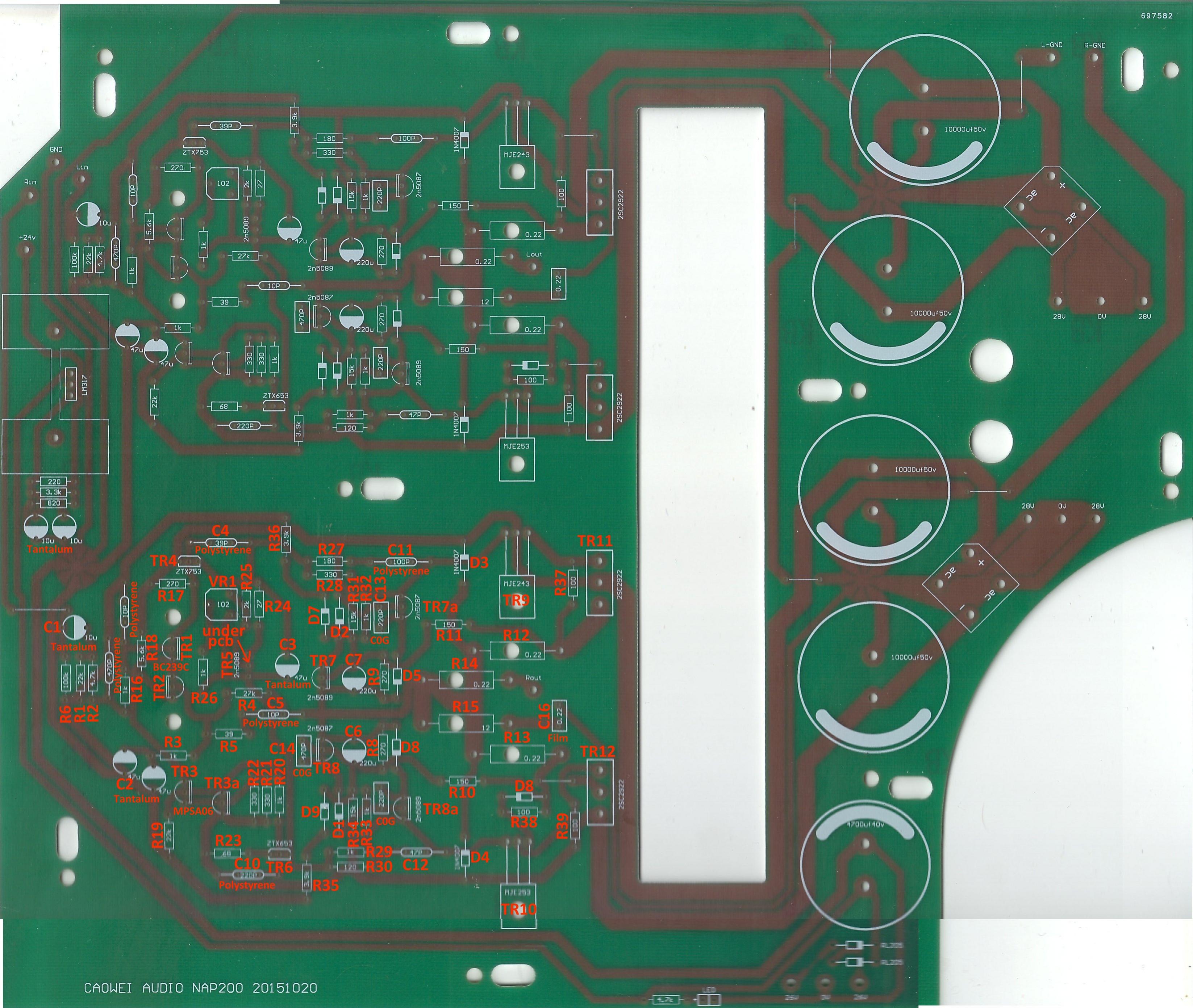

Hi! I have followed this thread a bit now and I have just ordered this NAP200 PCB kit from eBay. It seems to be the "Zero Zone" (GZLOZONE) PCB.
I have also ordered a custom toroidal transformer (450VA) from Tiger in the UK, a Modushop enclosure and I have ordered the missing parts for the preamp supply on the PCB.
Now the description of the eBay PCB kit says: "Test the 0.22R 3W Resistor (near the JE243G) voltage V1.adjust the Adjustable resistor to make V1 about 2mV."
Stupid question: Do they mean R12 (see picture for reference – it’s from this thread here)? And do they mean the voltage across the resistor or from one side of the resistor to ground?

They mean adjust VR1 until you get 2mV across R12 (or R13, either would do).Hi! I have followed this thread a bit now and I have just ordered this NAP200 PCB kit from eBay. It seems to be the "Zero Zone" (GZLOZONE) PCB.
As R12=0.22 ohms, 2mV across it means 9mA is flowing through it. Now I think that's a bit low for the final setting after everything has settled and warmed up. I would go for 5mV across R12 (about 23mA).

An important thing about selecting TR1 & TR2 is to make sure the dc offset at the amplifier output is not too high. Ideally, it should be <10mV (+/-). You could buy some TO-92 sockets so you can just plug transistors in and out and try lots of combinations. You may need a few extra transistors. I think either BC239C or BC550C are ok - obviously make TR1 & TR2 the same type.
