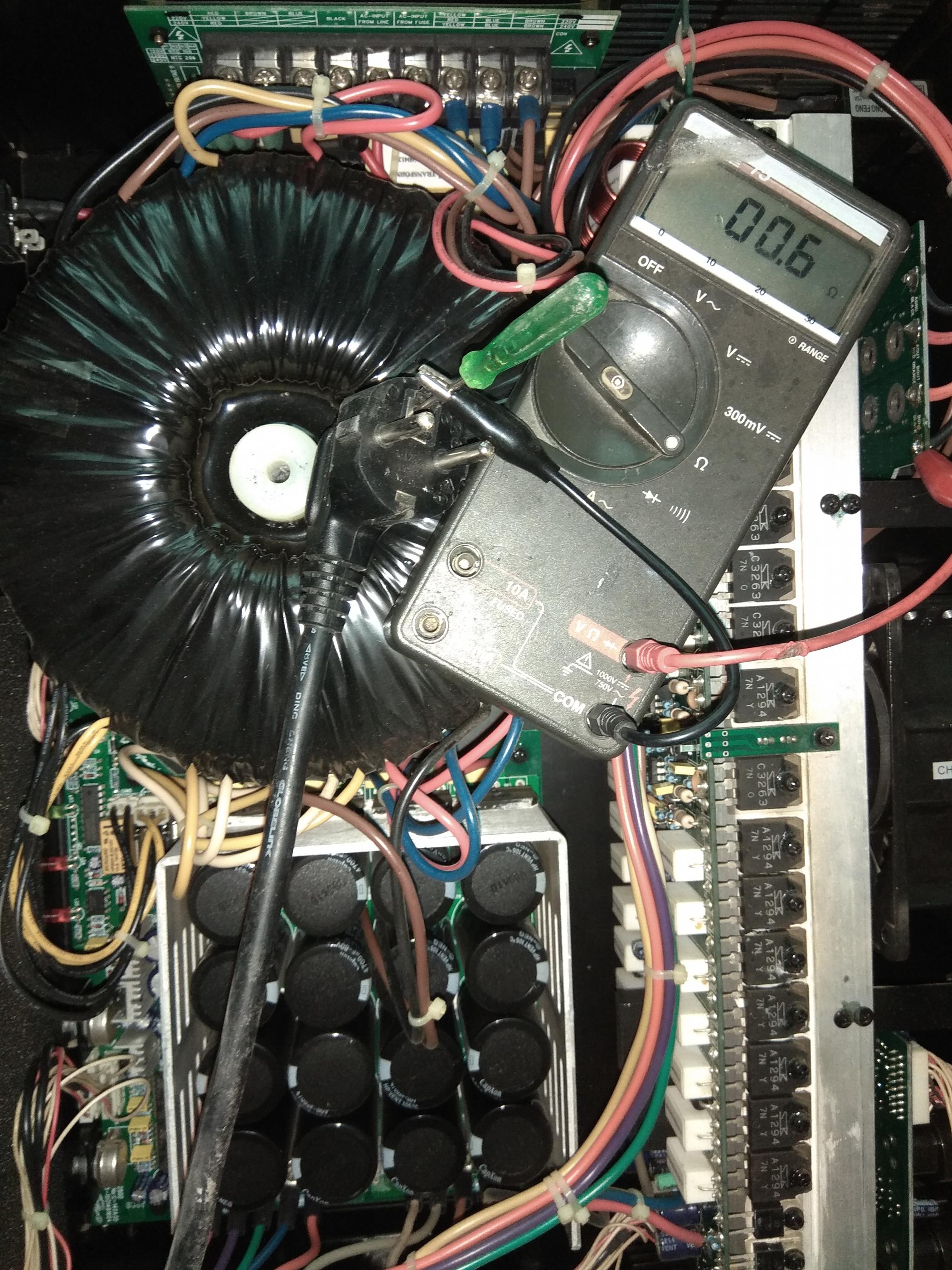

An important thing about selecting TR1 & TR2 is to make sure the dc offset at the amplifier output is not too high. Ideally, it should be <10mV (+/-). You could buy some TO-92 sockets so you can just plug transistors in and out and try lots of combinations. You may need a few extra transistors. I think either BC239C or BC550C are ok - obviously make TR1 & TR2 the same type.

Another thing I do when first powering up a circuit is to put a power resistor of a few ohms in series with one of the psu wires to the circuit and clip a voltmeter across it. This is a precaution against a short or other cause of excessive current. You can power it up like this and check voltages and set the bias current.
Also, tantalum capacitors are fragile when it comes to being reverse biased. If there is a fault that causes the output to go positive your C2 caps could be killed, or worse damaged without you realizing. So I advise putting a non-polarized electrolytic instead of C2s temporarily just until you know it works ok. Or you could put a temporary diode across them; they should survive 0.6V if their voltage rating is high, like 35V.

I think traderbam has given you good suggestions. I would go a little further with precautions because I had no problem with a 500VA transformer and ordinary "F" type glass fuse - these are seldom specified but the plain length of tinned copper wire inside is an obvious clue.
After checking that the transformer takes mains power to the primary without secondary connections (don't assume transformer lead colours are standard) I would only connect one set of secondary winding leads from the PCB and tape the others to prevent shorts. Buy a small number of fuses, as you may need them. Inrush current can be a problem with some low resistance toroidal transformer types and this can be a problem if the manufacturer is unaware of the application but I don't have much experience there - only seen it a few times when I was amazed to see fuses many times the usual size for a 300VA toroid. Inspect the board for shorts with a magnifier after soldering the power supplies, looking for shorts and wrong orientation of rectifiers and caps. The tracks are very close in some places and it's easy to miss shorts and confuse markings.
NAP models including this one, are now dual mono, so you can power up one amplifier quite independently of the other and you don't need to connect the preamp supply winding at all. Fit the secondary power leads to just one channel and check that it powers up and amplifier voltages are as expected - around +/-40V if your transformer is specified for a 230V supply, I'd guess. This will vary according to the actual local supply and transformer spec.
If you have problems even with one channel, you can try the other and so eliminate the possibilities. First though, be certain that AC voltages and the centre taps are correctly identified before connecting anything and then that your wiring matches with the board.
