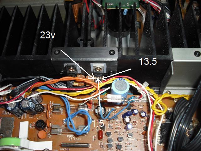

Can you read directly on the 3 pins on the reg itself ?
You see the left red circle in the circuit diagram is the output side... that can not have 23 volts on it.
Measure it now on the reg, all 3 pins, carefully.

OK those voltages are spot on.
I take it you still have the output of the reg disconnected ?
I'm assuming that the left red circle is pin1 at CN41, and there is 23.4V there.

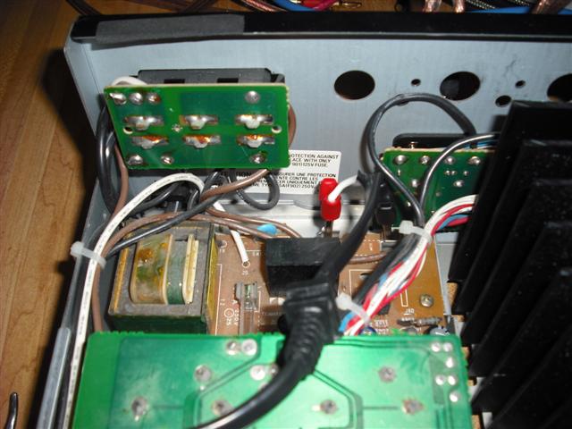

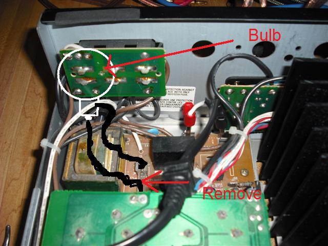

Rig the bulb up. Solder a couple of long wires to it and put it safely out of the way.
If you remove the main fuse in the unit you can then solder the wires across the fuseholder.

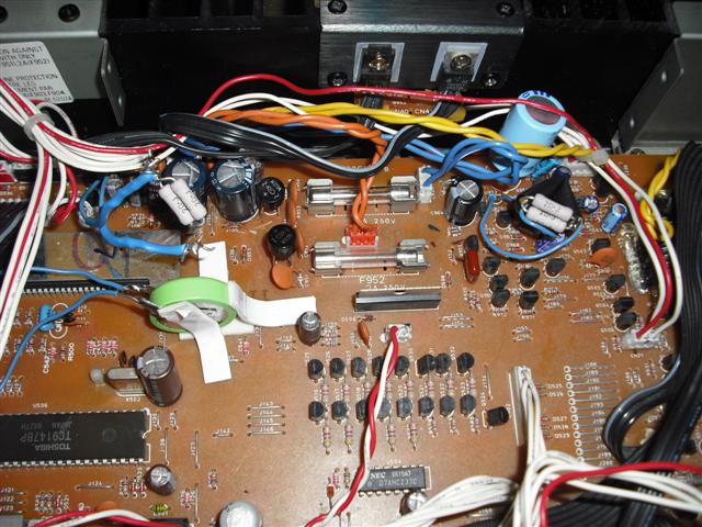

Where ever is easiest. I can't tell just by looking at the pictures... for example is that fuse in the incoming supply or does it just feed what looks like a small auxilliary transformer.
Just seeing that though I'm having second thoughts. If the voltage to the small tranny dips then the unit may not power up at all... if it uses a relay for standby etc. We can always try it, won't harm anything.
Might be better if you can put the bulb in the AC feed to the primary of the big mains transformer only if thats easy to do.

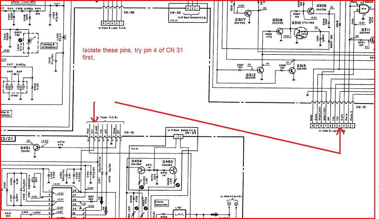

OK, made up the Dim Bulb Tester per Googled response from the Antique Radio site. Hooked up a wire from the DBT to (what I think is) the transformer mains, and the 100 watt bulb glowed bright for a brief moment, then settled down to about half bright. But then I heard what sounded like a relay click open and closed a couple of times, so I stopped. I did not reinstall the pin3 leg from the reg, since I was unsure if the relay reaction was safe and didn't want the relay to keep opening and closing. I got the same response when I hooked the receiver directly to the DBT, but the relay clicking was a little louder and more pronounced.
I studied the schematic to see where the 13 volt rail goes to, and it might be to CN35, which is that twisted blue wire that connects to the board right next to the AG3 glass fuse. That appears to go to one side of the transformer and has the note on the schematic "to tuner transformer". Is that correct? There was no voltage at CN35, but the reg was not completely connected.

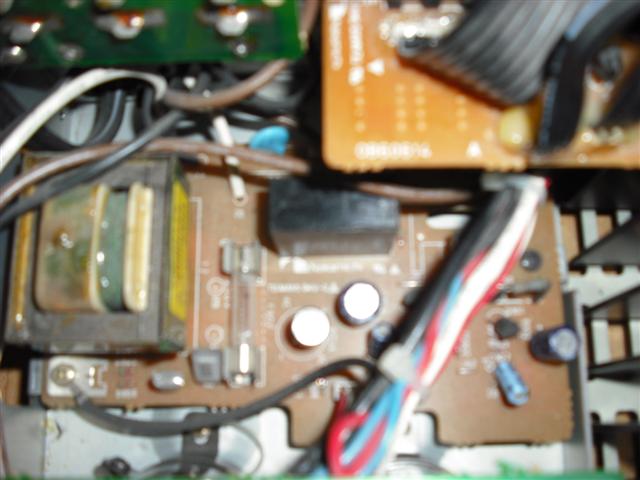

Looking at the circuit if you remove fuse F901? (bit blurry) as shown and fit the bulb in place of the fuse. That allows the standby circuit to receive full mains voltage and so should power up OK. If the bulb glows fairly bright that is because the main amps are drawing current.

There are two fuses. The one with the clips is 901, and is a 6 amp fuse. The one you drew lines to is a 0.5 amp fuse, and is F902.
I re-did the tester and hooked it up to the same fuse (901) as before. The thing lights up as you said, and the reg Pin1 is now 16.7V, and the pin 3 (isolated) is still 13.3V.
Hopefully you get this before you have to go.
That sounds OK, so what you need to do now is work through the tests in post #91 by first reconnecting the reg and seeing what happens.
The bulb should allow you to work on it non destructively. Make sure the regulator doesn't get too hot so try and make measurements quickly until you are sure nothings overheating.
