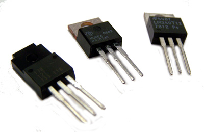

Is it like the one at the left or the others
It's got a metal tab on it like the two on the right.
The legged part is the reg... what do its markings say ?

So any 7812 will be OK... very common part. For the fuse U951 you can fit as mentioned a 1 watt 1ohm to test.

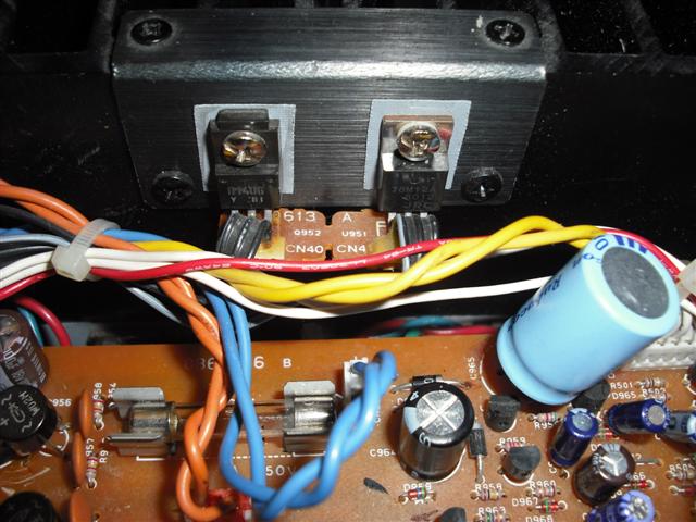

Just enough charging time to take this pic:
The U951 is mounted to the large heatsink and is to the right of U952.
U953 is at the 7:00 position next to the oversized blue cap on legs that I tipped out of the way. You can see it's mounted flush to the PCB.
Shall I replace the U952 as well?
U952 is another part of the circuit... no reason to suspect any problem there.
Same test applies... it's just a fuse... voltage same both ends, it's OK
