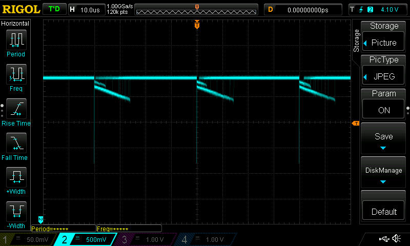

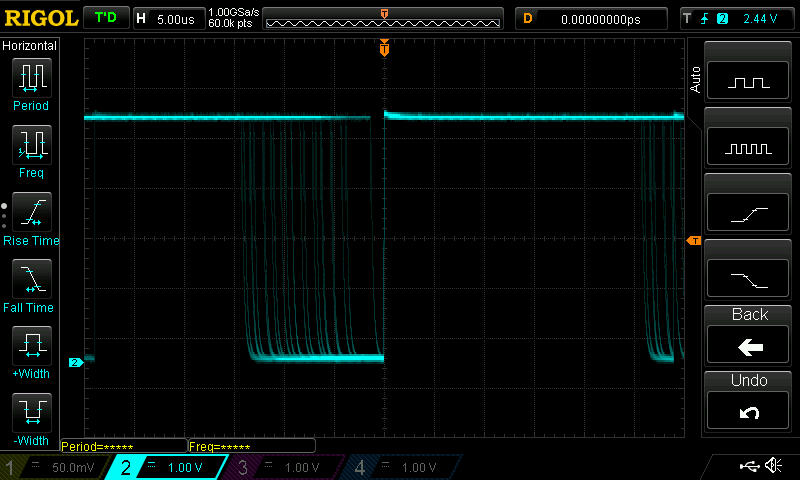

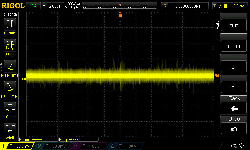

Im glad you mentioned pin34, I though it was odd, looks like a secondary smaller square wave superimposed..
New measurements.......
R602 removed, measuring pin 34.
picture 23 = fm selected.
picture 24 = am selected (just random noise)
picture 26 - fm selected and doing an 'auto seek'
picture 26 is the only one that looks even vaguely like what I'd call a square wave.

I can't see IC602 taking the fuse out but failure modes and the analysis are weird sometimes.
The shot of it doing the auto seek. It looks vaguely OK-ish in that it looks like a full amplitude signal with a variable duty cycle.
If you load pin 34 to ground with something like 10k, does it kill the waveform ?
