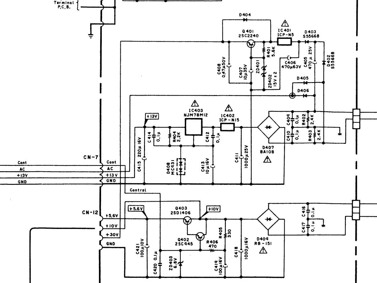

Customer has asked me to fix their SR4 which appears to be very similar to these TA4's etc.
This one had a low left channel output and non functioning tuner.
Missing channel was dry joints on the 'loudness' control board.
Tuner issue is same as this thread, am/fm seeks up down without stop, signal meter stays in one spot, and manual tuning reveals no stations.
I have done (as part of the normal service) full recap and resolder of all boards. Many dry joints fixed.
Power supply section, replaced D404 R401 ZD401 Z402 - all damaged from that lovely brown component glue.
Then I started working on the tuner issue.
Found the 'VT' voltage on the tuner and logic board are 0.01 volt, and the +30v rail from power supply to Logic board was 0.3v.
This was due to IC401 (2 amp fuse) on the power supply board being open.
I've now also replaced all related components - D402 D403 D405 D406 Q401
So entire 30v reg section in power supply is new, and working 100%
All Supply voltages as far as I can see are ok. Thats 5.6v 10v 13v 30v
Trying the previously mentioned trick off touching the crystal does result in a change to reception.
The only thing missing that I can see is this 'VT' voltage.
When in AM mode it is 29.6v - In FM mode it is 0.01 In either case it does not vary at all irrespective of tuning mode or frequency..

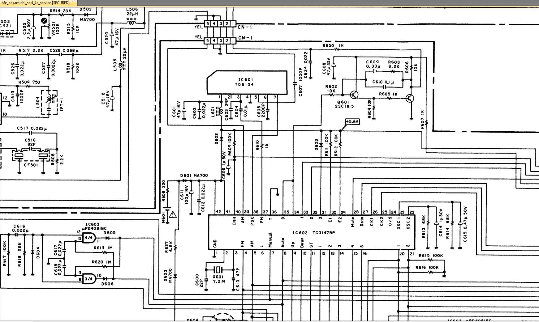

In the att pic, the VT line is pin 1 (right pin) of cn 1 (ylw).
I've also included relevant section of the power supply.
I have the hifi engine service manual so can post whatever sections are needed.
All help appreciated.

Pins 34 and 35 will be a squarewave of around 5 volts amplitude but the duty cycle should be variable. A duty cycle of 50% (a perfect squarewave) would generate say 15 volts for Vt. If it were high for only 25% of the time then Vt would be 7.5 volts and so. The speed at which it runs is very high though, probably several kHz and so the meter will give a an indication of 'something' and something that should vary as you alter the tuning.

The voltages on pin 34/35 tie in with your measured tuning volts line. Both transistors would be off with 0 volts on the uP and that would generate a 30 volt Vt voltage as Q? (its not marked) would be off. The voltage you get on FM from the uP would at least turn both transistors on and that would pull the collector volts of Q? down toward 0v. So it sounds like they are at least working OK

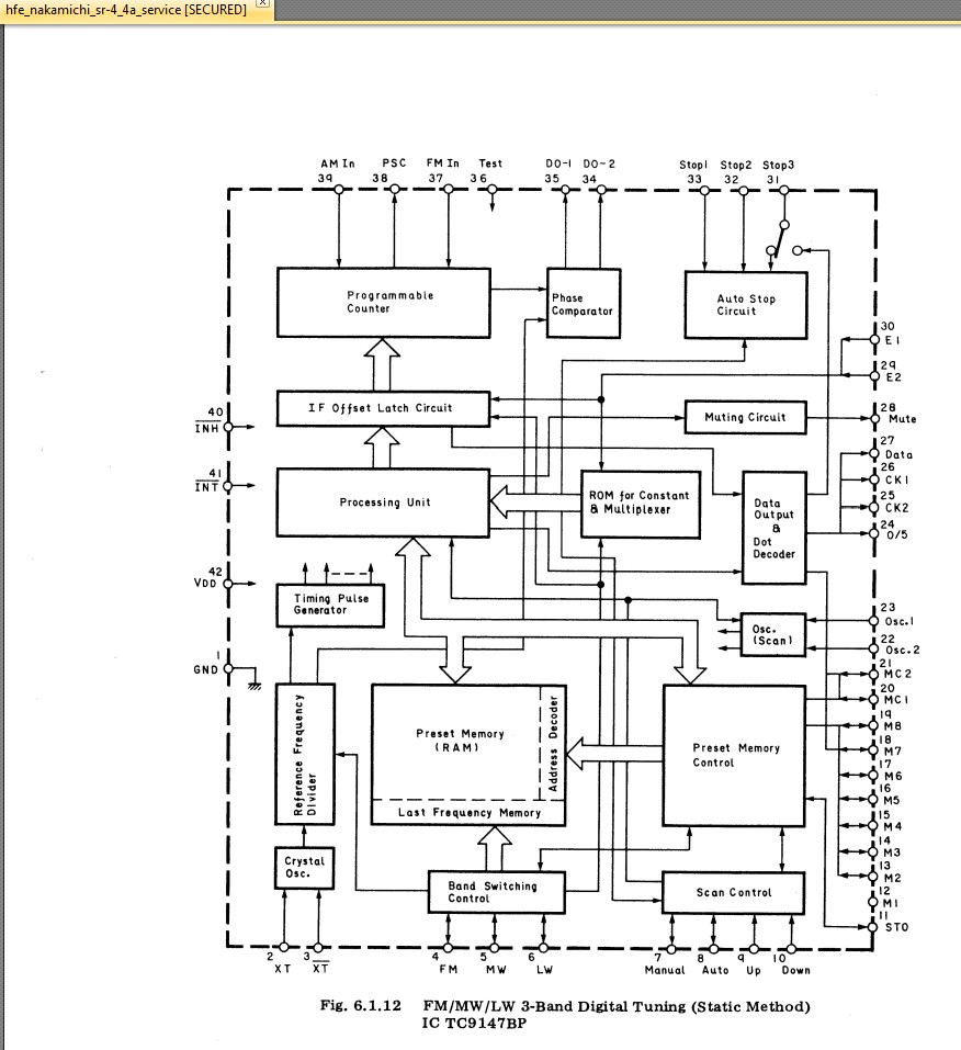

You need to check ALL pins have what you would expect to see... or at least something that seems reasonable. All data lines and key scans should be around 5 volts pk in amplitude. Remember the scope measures DC too and so you should check supplies and grounds are clean and at the expected values.
Check the prescaler outputs on IC601. Pin 5 looks as though it would be an input from the local osc in the tuner itself (probably to high a frequency, and to small in amplitude to see accurately on a scope) but there should be a clean lower frequency signal on pin 3 feeding the main uP. I would expect that to be 5 volt amplitude.

I did have a brief run today, probed all uP pins, few supply lines, one or two data lines, rest didn't do much or didn't make sense to me.

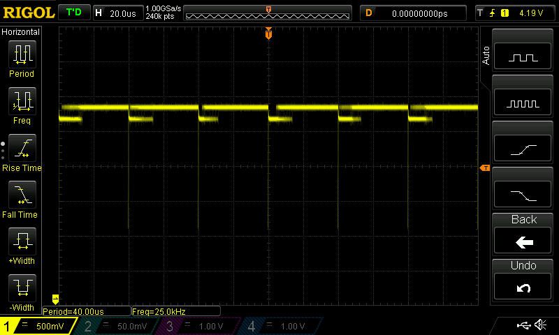

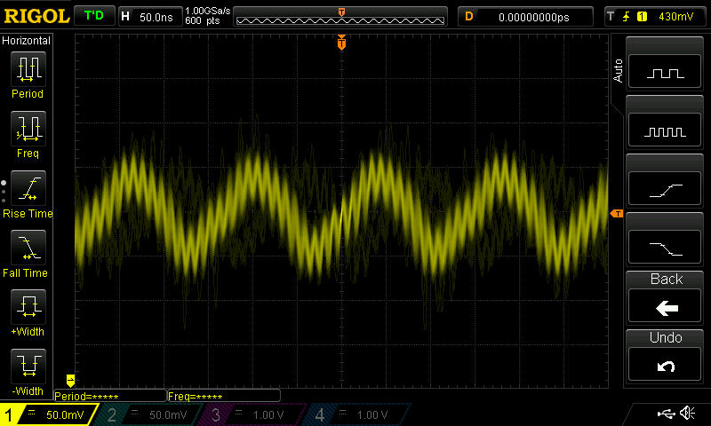

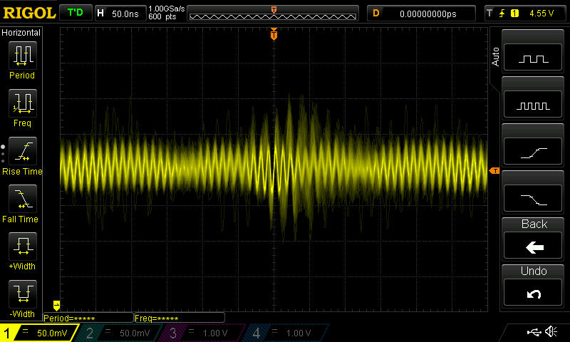

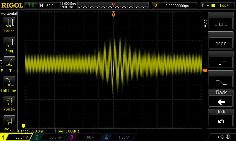

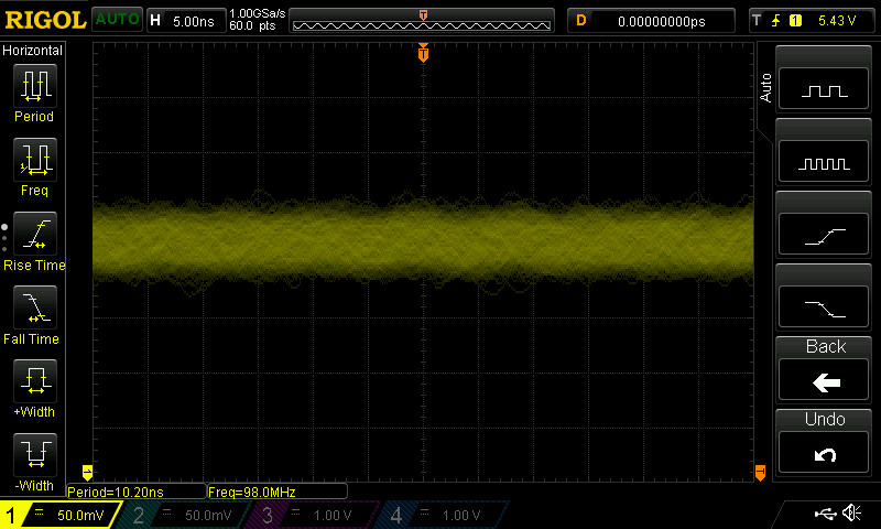

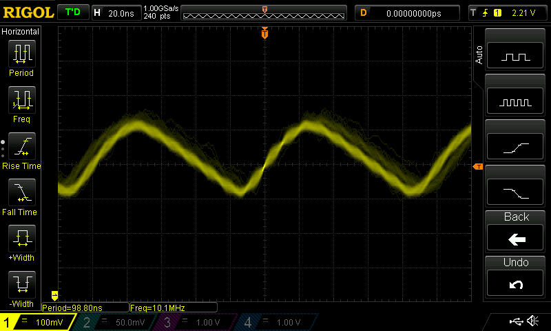

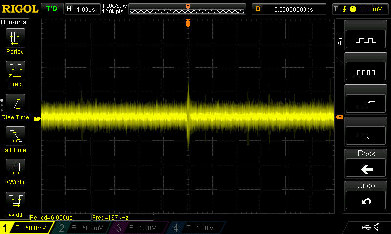

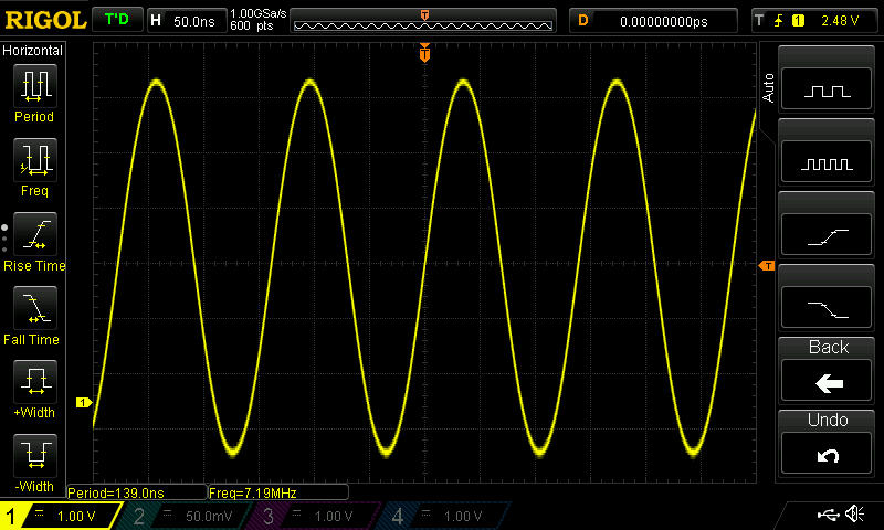

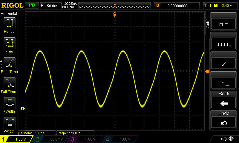

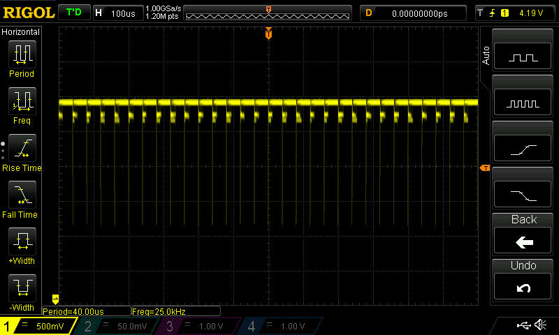

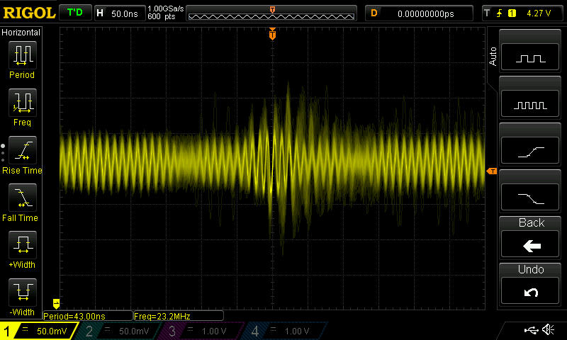

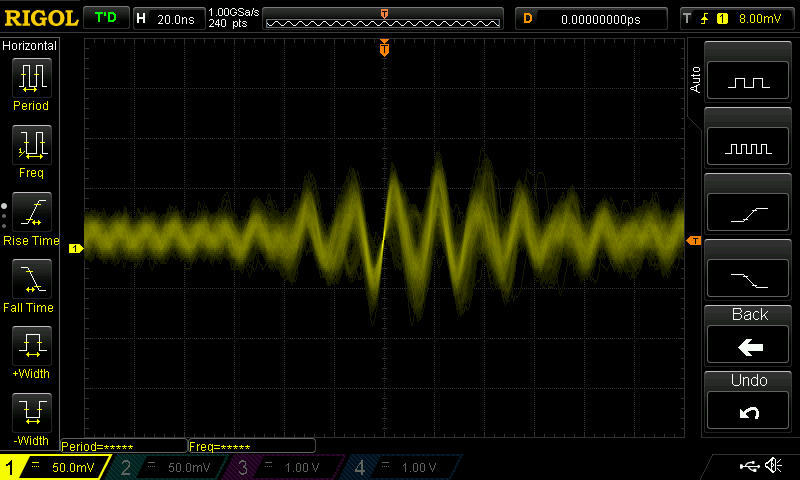

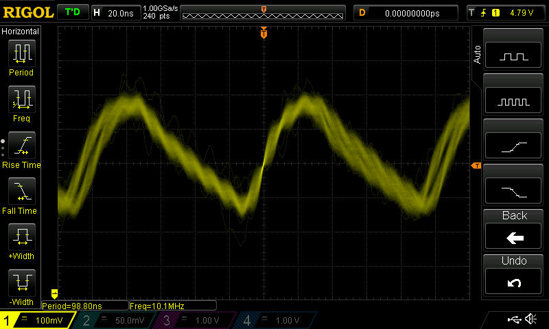

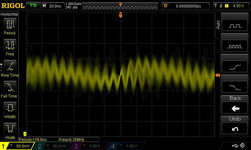

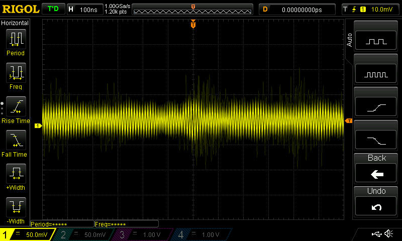

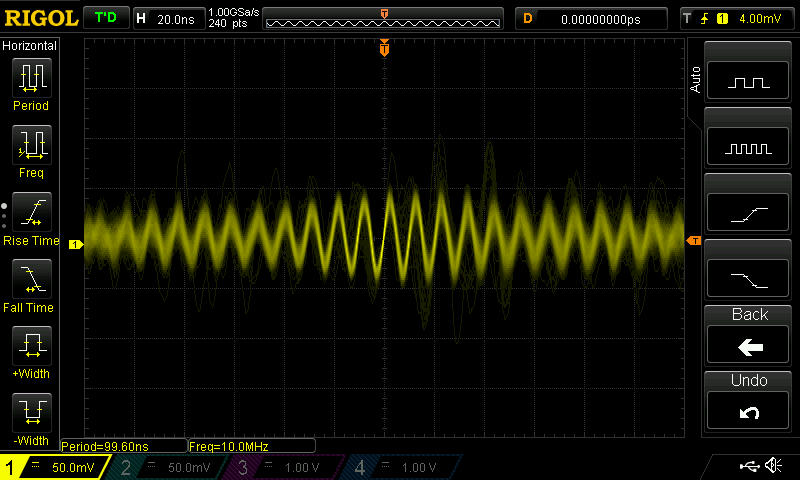

Finally.
Learnt a few tricks of this new crow 🙂
So, here we go..
IC601
Pics in order of pins (pin 2 n/c and 4 gnd - neither measured)
pin 1 / 3 / 5 / 6 / 7 FM / 7 AM
So, here we go..
IC601

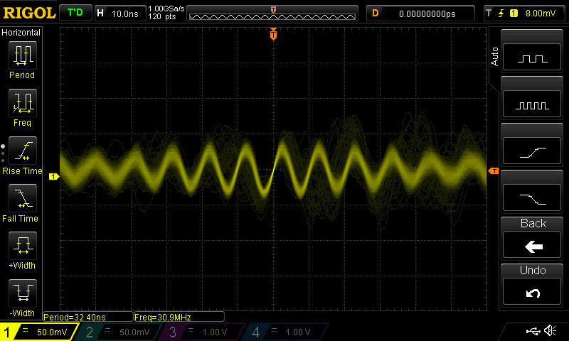

And for IC 602.
Most measured low level noise so didnt do 'shots' of those.
pins. 2 / 3 / 4FM / 4AM / 5FM / 5AM / 7AM / 7FM

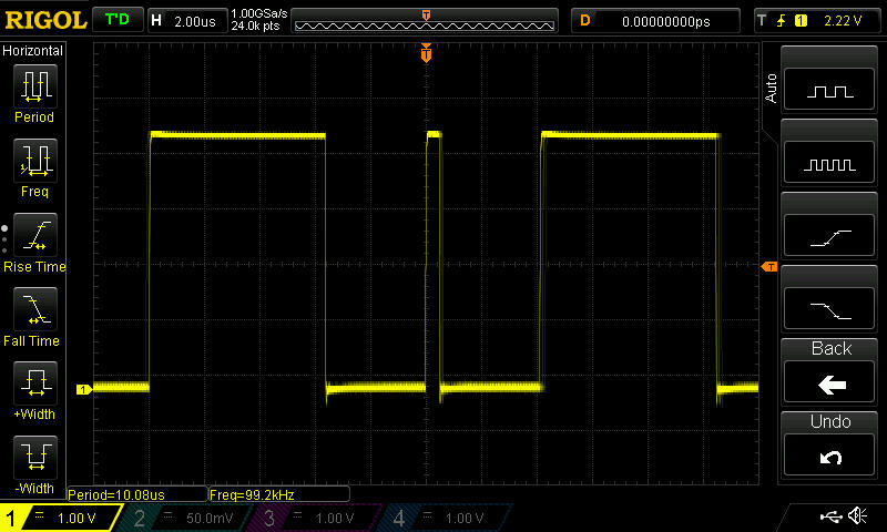

Other side of IC602.
Pins. 22 / 34FM / 34AM / 34 FM SEEKING / 37
pin 23 is the same as pin 22
After all that, I think the ic is dead ? or am I wrong ?
IC601 looks as OK in as far as its possible to tell. Pin 3 looks a bit odd but that is actually an input (from IC601). There's a nice clean squarewave on the output pin which is basic confirmation its OK. Pins 5 and 6 look spot on for the type of signal you would expect from the tuner.
IC601, pins 2 and 3 are normal (clock generator). Pins 4,5 and 7 look like noise... I think these should be static logic levels that will only have data present when you are pressing keys to change the band switching and so on.
Pin 34 doesn't look correct. Its not normal to see a small amplitude logic signal riding just below the high logic level... is the IC faulty possibly with a problem on that output port drive stage... I've been here many times and its never (99% never) 'the big chip' but this is maybe pointing that way.
It is worth you unsoldering R602 and measuring pin 34 again to see if the level has changed.
