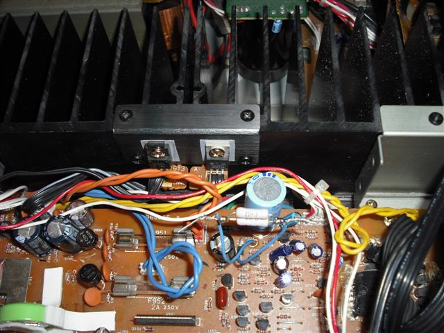

Replaced the reg. Removed the fuse, installed a paralleled pair of 1 watt, 2 ohm resistors - still no tuner.
VOLTAGE AT REG: 0.17 volts
VOLTAGE ACROSS "FUSE": 28.4 volts
VOLTAGE AT PIN 11: 0.17 volts
Too bad - I was hoping for a little celebration.
What to do next?

That's a pity, it appears in this case there is something drawing excessive current.
Ideally a separate current limited lab power supply could be used to power the 12 volt rail and allow you to work on it.
Faultfinding now consists of isolating items on that rail, initailly by disconnecting pin 4 of CN31 and confirming the regulator output is OK with no load. The fault could now be any component that has the ability to present a low impedance across the supply. So that could be any decoupling cap of any type across the rail or any IC fed of that rail directly. It's common practice practice with anything like this to try and split the circuit in halves to try and locate the problem, perhaps disconnect the tuner pcb.
The other real issue is keep blowing fuses. It moght be worth trying the "light bulb" tester in the mains lead to limit current. Make sure the unit powers up OK with say a 100 watt bulb, and then start again. A shor on that rail should cause the bulb to light brightly, it may even allow sufficient current to flow such that the problem becomes apparent such as a cap getting hot or an IC burning etc. Sounds drastic but without a full range of test gear your options are limited.
If the bulb lights brightly indicating large current flow another good way is to measure the volt drop across PCB tracks. Although the voltage will be in the milivolt range it will show up a piece of print carring excess current.

1. Is it OK to continue using the resistor instead of the fuse?
2. I recapped the entire controller board, and about half the main pcb. While this is the "shotgun" approach, would you recommend finishing recapping the main board?
3.RE: Disconnecting pin 4 of CN31 - how does one confirm the regulator output is OK with no load (what you're saying is that the new reg might be bad?)

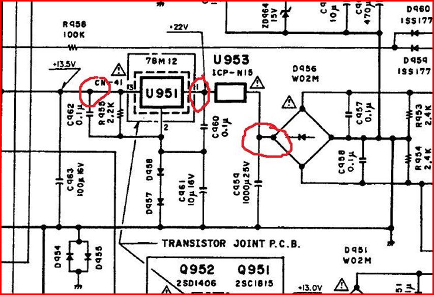

That's great, so looking at the circuit diagram you must also have 28 volts on pin 1 of the regulator itself ? That's the input pin.
Carefully measure the voltage on all 3 pins of the regulator itself, not on the board, on the reg... what do you get ?

Here's the same image from a few posts back.
U953 (the fuse) has been replaced by a 1 ohm resistor... yes 🙂
You say there is 28 volts on each end of this 1 ohm resistor... yes ?
Pin 1 (the input pin) of the regulator has no voltage. All that's between the two is print and wire. The middle red circle.

I'm interpreting this as meaning the voltage between pin 1 of the regulator and one end of U953. I read 28V there, too.
There's no voltage between pin 1 of the reg and ground. Neither at the pin 1 of CR-41 (the left most circle), which is just a wire from the pin 1 of the Reg.
Regarding the righthand circle, I'm interpreting this to mean the voltages at the diode (Is this a diode bridge?). At the + leg, there's 14.52V. At the opposite corner leg there's 0.0V. The other two legs have 4.56V. All measured to ground.
Mooly - Thanks again for your time and patience.
From your readings and what you say it has to be a broken connection, but I can tell from your questions you are not really understanding what's going on.
You say there is 28 volts on the 1 ohm. That is the same point as the right hand red circle... and you mention 14.5 volts there.
Your readings don't really make sense tbh. Recheck carefully. All voltages are measured to ground. Yes the 4 diodes are a bridge.
With it turned off and with your meter on ohms (use the lowest ohms range) there should be continuity (a short) between pin 1 of the reg and the bridge rectifier (the four diodes) at the point where the red circle is. That point is also the positive end of the large cap C959. Check very carefully that the cap is connected OK, check that the print hasn't lifted and broken where the cap is soldered (check both connections of cap), and that there is continuity from this point all the way to the reg (via the 1 ohm). Make sure the negative end of the cap goes to ground and there are no breaks there.

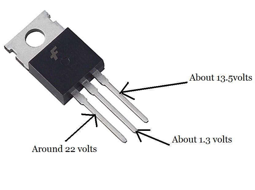

That's fine, so you have the left and middle pin connected on the reg.
That's good... now that 23 volts has got to appear at the left pin on the reg. Do you see ? It's a direct connection via U953.
The right hand (output) lead of the reg should have 13.5 or so volts on it even though it is not connected.
The diodes I meant were the two connected in series from the middle leg of the reg to ground.
