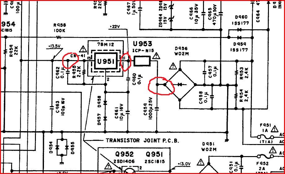

Page 35 of pdf, check U953 a circuit protector (fuse) value is 40 times the marking so an N10 is 400 milliamp anti surge. It feed 7812 regulator. Trace the rail from there if that happens to be OK.
Edit, an N15 is 600ma

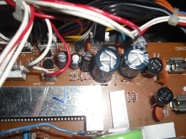

Thanks. Will get to it this afternoon sometime. Looks like it's behind the faceplate at the controller panel.
Right, it's on the controller board, not the main control panel. Not sure where to check voltages, since the U953 is directly on the PCB, but the jumper right next to it reads 5.43 volts.

You just have to be logical and follow it through. 23 volts sound OK (fuse/cp must be OK) so measure on the pins of that 7812 regulator or across that cap C963. If you have 23 volts in and low voltage coming out of the reg then it's probably (barring a short on the output) faulty. Is it hot ?
The voltage you quoted a few post back as being 3.66volts is that rail from the regulator. So you have to locate that reg and just trace from there. Could well be the reg though, it's a typical failure mode.

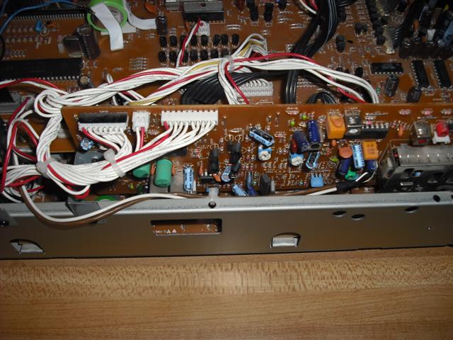

Hello again - Been awhile, hope you're still interested in this. I couldn't quite measure the voltages across the caps because the new caps are a bit larger. Some I bought locally and some were ordered, and some came out a bit larger than the originals (some I ordered one voltage step up).
So I thought I would measure a few places for voltage and report back.

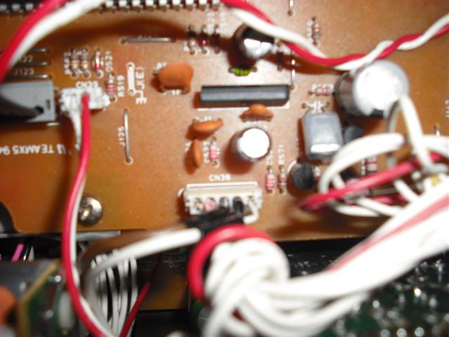

It seems to me that the tuner board may not be getting enough voltage. The connector CN38 has just a few millivolts: Left to right: 9.6; .2; .5; .5; .3 This appears to have the largest insulation on the brown/white wires so I thought it might be power into the tuner board.
The three connectors at the top left of the tuner board show anywhere from 0 to 5 volts at some of the wires. I can diagram them all out if that would be a help.
As you can see I'm a little stuck on this at the moment. Any suggestions would be appreciated. I wouldn't be surprised if it was a small thing I missed somewhere. Could there be a bad tantalum cap?

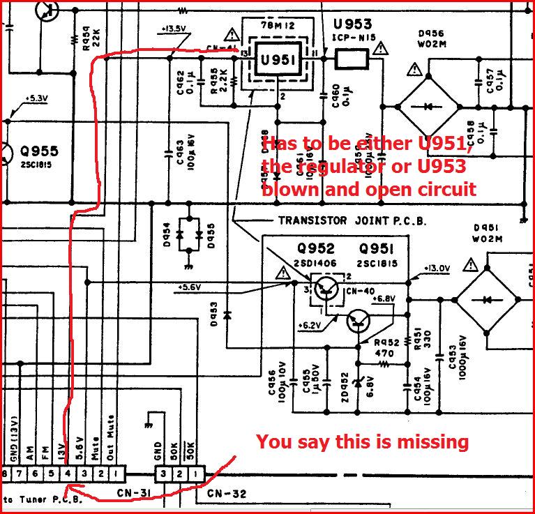

Page 35 of pdf. Connector CN31 has the 12 volts from the reg on pin 4 of the connector.
That goes to CN 31 on page 33. From there it feeds off to other areas as well.
You are going to have to trace these yourself with the unit in front of you and measure along the way.
Find the point on the tuner where the supply is missing.
Pin 11 of U302 (ic on page 33). Is there 12volts there ?
Also check the line from CN31 pin 5 on page 33 marked "FM". Does the voltage go to around 12 volts on FM ? Does that voltage arrive at pin 5 of U301 ?

You have a missing 12 volt rail. Pin 4 of CN 31 is missing the feed from the regulator.
On this diagram that point, pin 4, goes direct to the output of the reg.
Are you sure the "fuse" is OK that feeds it. If so and you have 20 or so volts entering the reg and nothing coming out then it's faulty.
Does that make sense ? 🙂
I'm still locating it on the board diagram. Is U951or U953 the regulator?
(BTW, it's near midnight here, so my eyes are a bit tired to read the fine print).
