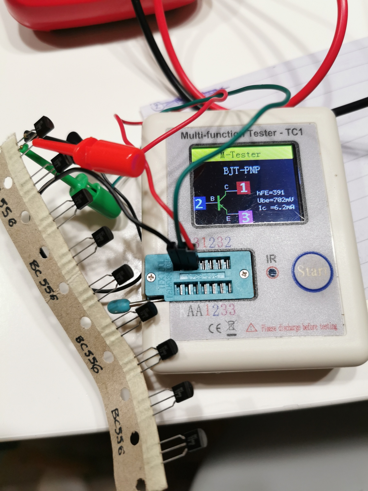

I might have done a stupid thing... I tried to measure Vbe in-circuit for Q406. While probing between B and E, I noticed that the transformer started to buzz, but the amp was up on one side (so I could probe that back of the PCB). It took me some seconds until I scaled up the DMM for a reading. It showed some 34V. I quickly turned it off and when laid the amp back on the table I noticed the main heatsink was very hot (barely could keep my hand on it), as well as the outputs on that channel and the emitter resistors. I plugged it in the DBT and everything looked normal. DC offset measurement doesn't show much of a difference (about 0.3mV on each channel) so I assume I didn't fry the outputs again.
The only thing I did different from measuring the resistors earlier was that I probed the transistor while the amp was on as I couldn't clip the leads on the top side of the PCB so I used pointed probes from underneath. I expect the behavior was similar to what I saw the last time I tried to measure those resistors while the amp was on.
Should have I pulled the transistors and measure them off circuit? (my multi component tester also measures transistor Vbe AFAIK)
this is the tester (cheap chinese little thing but seems to work nicely)

1.5 m.A. of collector current is too low for Q405 and Q406 for the amplifier to be working properly.
The BC556Bs were not replaced after the amplifier failed so we need to look at the Vbe which should be about 0.55V for each.
The collector current of Q405 Q406 includes both the current across R435 R436 and the current into the base of Q407 Q408. R435 R436 establish the gain of Q407 q408 along with the collector resistors R437 R438.
The readings on your transistor tester are consistent with what might be expected from Q406 in circuit however these have their own supply and inject current into the transistor under test. These are not designed for testing with circuits under power with the setting you have there.
It says Multi-Function Tester on the case. It has what look like USB ports and leads with clips at the ends. Check the instructions to see if other ports can be used to test voltage and if there is a hold function to display the measurement.
If so the leads have clips that should allow you to secure the red probe around the base or emitter lead put the other in the black output terminal connecting to earth.
This will allow you to work from the top of the pcb and put the meter where it is the centre of focus.
With two hands free you can turn the power switch on or off quickly with one and start the meter with the other.
I think the base current for Q407 and Q408 will be less than normal because of the low current levels in Q405 and Q406, and heating of Q407 and Q408 has increased their current gain in greater proportion to their base currents.
They are indeed nice little testers with a nice, crisp display and rechargeable via USB too. The TC1 model is an updated one but still based on similar ATMEGA 328 microcontrollers and firmware to other versions that have been around for many years now. Long description, model comparisons and review here: The evolution of the Electronic Component Tester (Multi-function Tester TC1 review) - YouTube
There's no hold function that the reviewer mentions or I'm aware of but it was only about US $20 delivered with accessories.
As mjona may be warning, I would not trust the results of testing any components or semis in-circuit, though. The most obvious problem there is that the test voltages generated by the tester will be at low power and relatively high impedance, thus easily loaded by the amplifier circuit resistances such that the results will likely be false/meaningless.

not knowing whether I should measure the transistors in circuit or pulled out I assumed I had to measure them in circuit so I tried to measure Vbe by touching the base with one probe of the digital multimeter (not the tester) and the emitter with the other probe. That's when the transformer started to buzz (and the current started to rise I assume). The DMM was set to the 200mV DC division and the reading was 1 (as in out of range). It took me some seconds until I realized it was out of range, not 1mV and set the DMM to the next division. Still 1 so went up a notch to the 20V division. Only then I had a reading of 34ish VDC and realized something was wrong, shut the amp down and noticed the heatsink, emitter resistors and outputs were hot.
then, after posting here and getting the first reply I decided to test an unused BC556 with the multi function tester because I wasn't totally sure it also measured Vbe, and that's what was in the photo. So I never used the multi function tester on the actual amplifier circuit.
I'm a bit confused whether I was measuring the right stuff or not. I assumed measuring Vbe meant placing one probe on the base and the other on the emitter while the amp was running, but after your replies I'm now thinking that I should have measured voltage drops between base and ground, and emitter to ground respectively, and then substract one value from the other to get the Vbe. As it seems, I'm not really knowing my way around transistors yet...
You are on the right track now in measuring separately between base and ground and emitter and ground as you call it or earth as I did, and doing the mental arithmetic. The circuit diagram shows various points connected to the earth symbol. It is easier to work with only one hand in the chassis and keep one free for other tasks which is the reason for my suggesting putting the black probe into the black speaker output terminal - either one will do.
Modern multi-meters have high input impedance for measuring voltage so you should not have a repeat of last nights performance if you do the tests as per this discussion.
All the same keep one hand on the on-off switch as a standby precaution.
I replaced Q405 and took another measurement:
NEW Q405 (BC556) static: hFE=392, Vbe=698mV, Ic=6.2mA
in-circuit: Vb = 38.3V, Ve = 39V
OLD Q405 static: hFE=331, Vbe=691mV, Ic=6.2mA
OLD Q406 static: hFE=331, Vbe=691mV, Ic=6.2mA
in-circuit: Vb = 38.4V, Ve = 39V
NEW Q406 static: hFE=392, Vbe=690mV, Ic=6.2mA
so, in-circuit measurements for Vb and Ve were made with the new transistor in place for the left channel and with the old one for the right.
